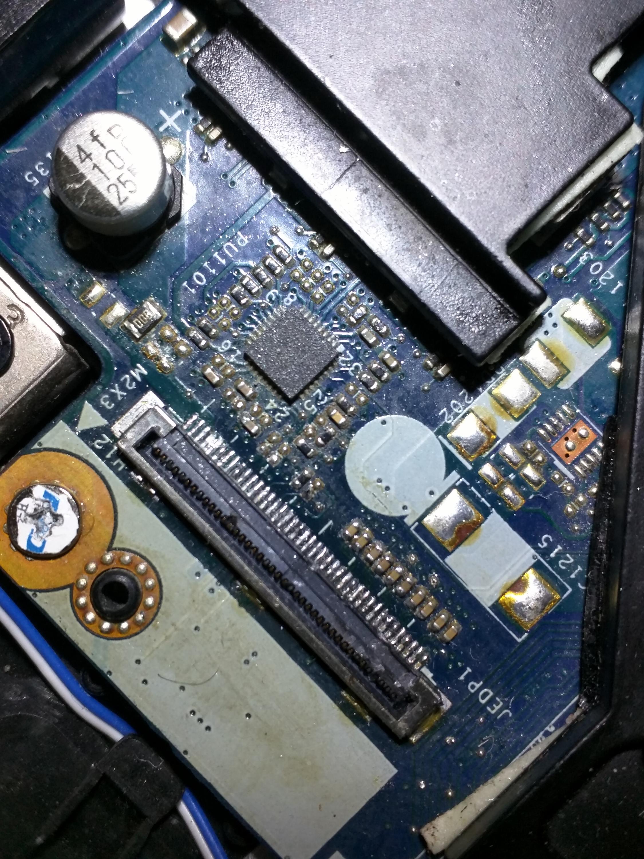

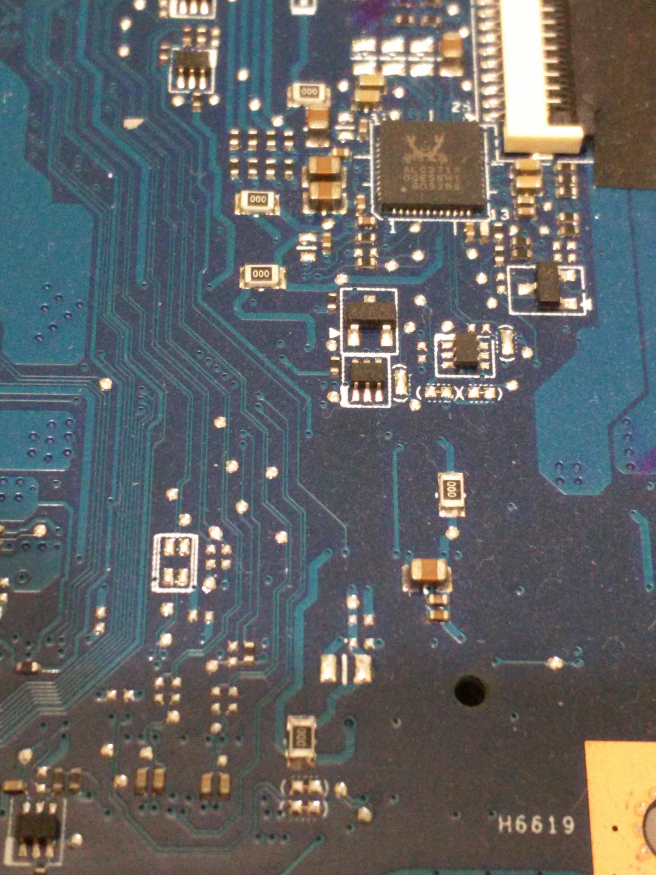

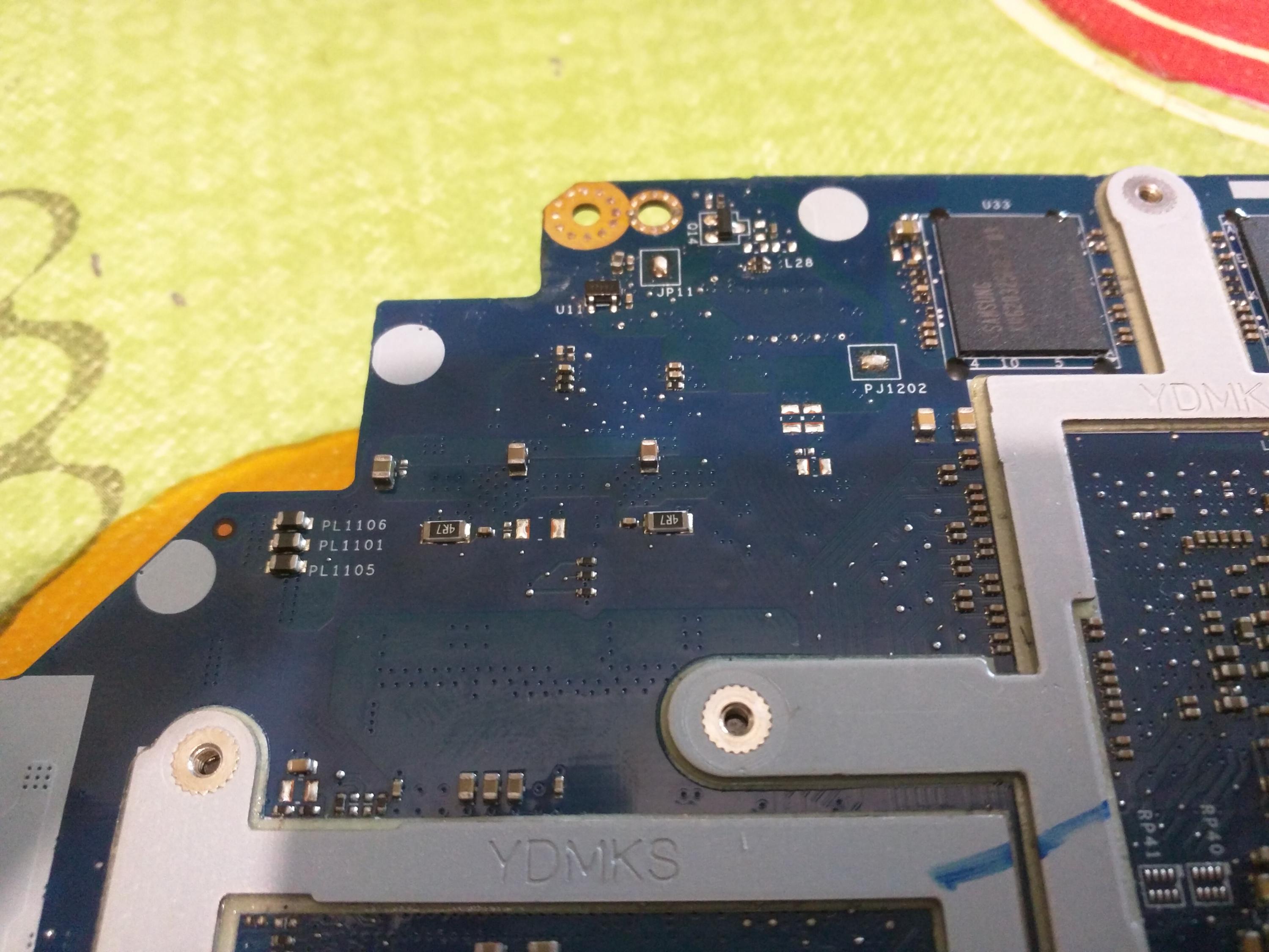

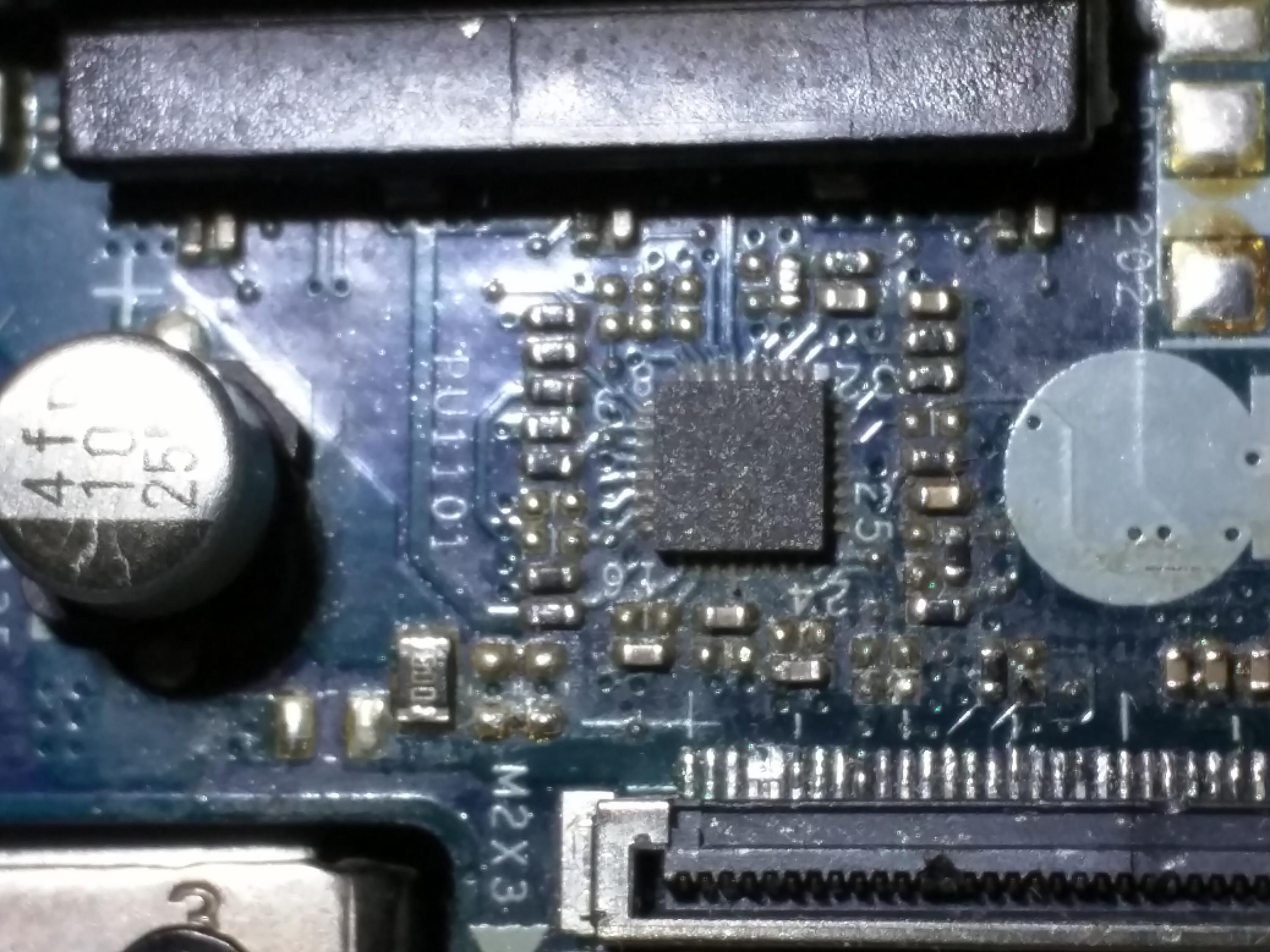

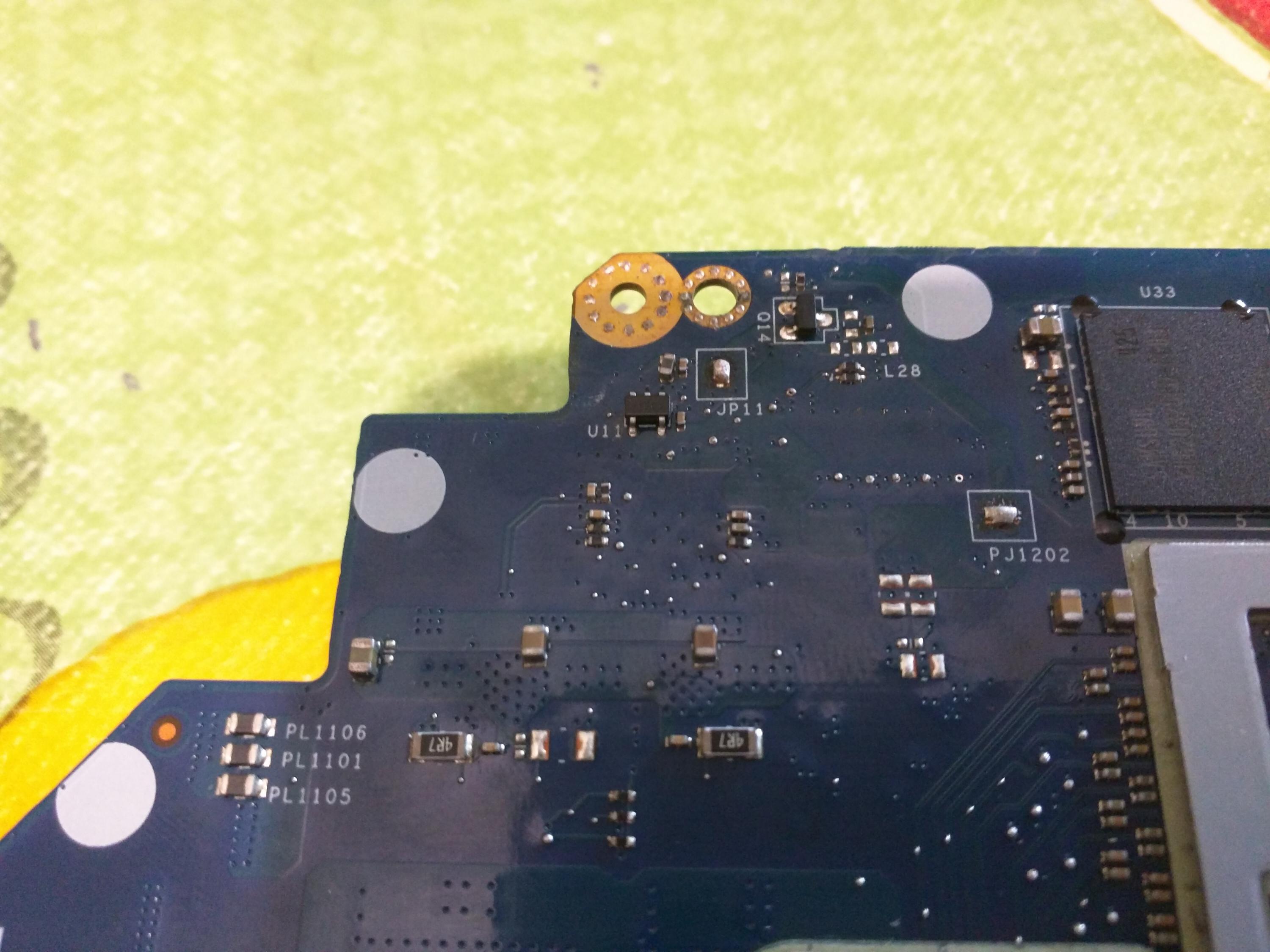

Re: Lenovo Y50-70 (not touch) - Screen LED Backlight
I'm not sure you're mesuring the right thing. You should be getting 19V on both side of that resistor. (or at least the top side if it is burnt). Anyway check its resistance, it should be 0. Next would be to check for a short to ground on the connector.
