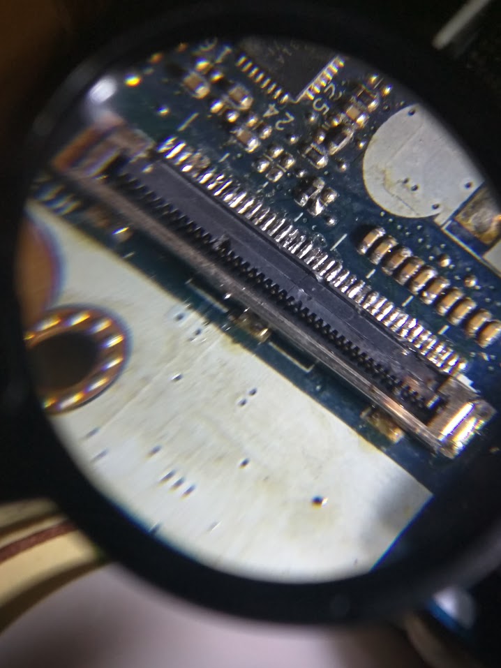

    I need a little help with my second Lenovo y50. Board schematic is attached.
    Little explanation, the 40 pin connector for the LCD was broken, I made the replacement and it looks fine. I can see the screen showing some images.
    Problem here is that the screen backlight doesn't turn on (tried also the FN + ...). Screen is working fine on my other y50 laptop (cable also).
    Could you help me to identify what is wrong on the board? I think about something wrong with pin 28 of the LCD connector but that it...
    Thanks a lot !

    Please post a picture of the area you worked on.
    Also, what voltage do you get on pin 28, 29 and 40 of LCD connector?

      Re: Lenovo Y50-70 (not touch) - Screen LED Backlight
      Hello Piernov,
      Thanks for the answer, here is the picture.
      Regarding voltage, i get 0V for the 3 pins (28 -29 -40)
      Thanks !

          Not so pretty but it should do the job. Not sure about the 4th and 5th pins from the left though.
          Could you mesure all the voltages on PU1203 pins?

            The 4th and the 5th from the left, there was a scratch, I verified, and both pin join to the ground, so it should be fine.
            To solder the connector, I've used my smd rework station with soldering paste, as this is really small, it is really difficult to make it really clean.
            I'll measure voltage right now ! Thanks !
