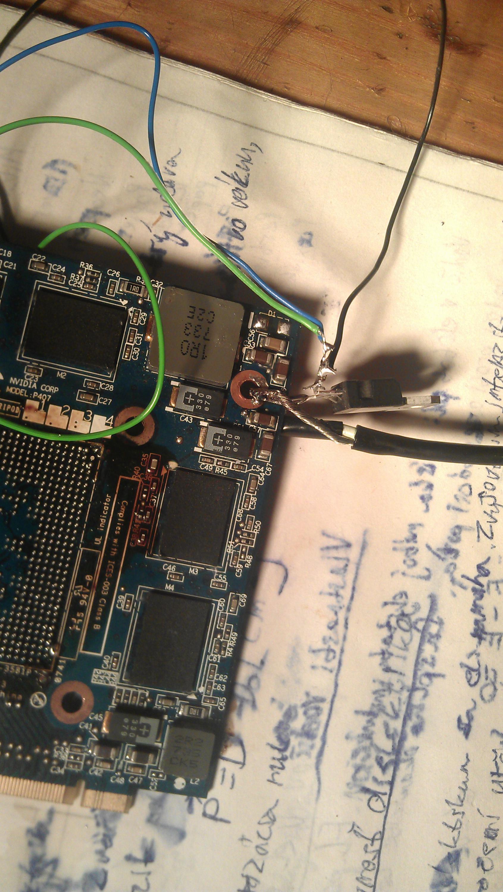

                    ^^ That's it. You need 8 to 20v input on the main filter caps of the MXM card and a small 5v regulator such as a 78L05 to power the PWM controller originally responsible for GPU Vcore on the card. All you have to do is give it power on the main supply caps. Then you connect the output of the 5v regulator to the logic supply of the PWM and enable signal (EN pin) and it will deliver ~1.2v at 20A or so, fully protected. Thick output wires required, it will melt regular 18AWG wire like found on ATX power supplies.
                    It's great for finding shorted components - connect on the shorted rail and then feel the board with your hand and you will immediately notice what's getting hot. Since the voltage is low, it will not damage any parts even if the short is on the high side of a VRM and the power leaks thru to a processor or chipset.

                      Re: how to find short in low voltage power rails like CPU or GPU rails
                      yes i have few even with bad gpu so i make some modifications. but what about ilimit and short detection that power off?

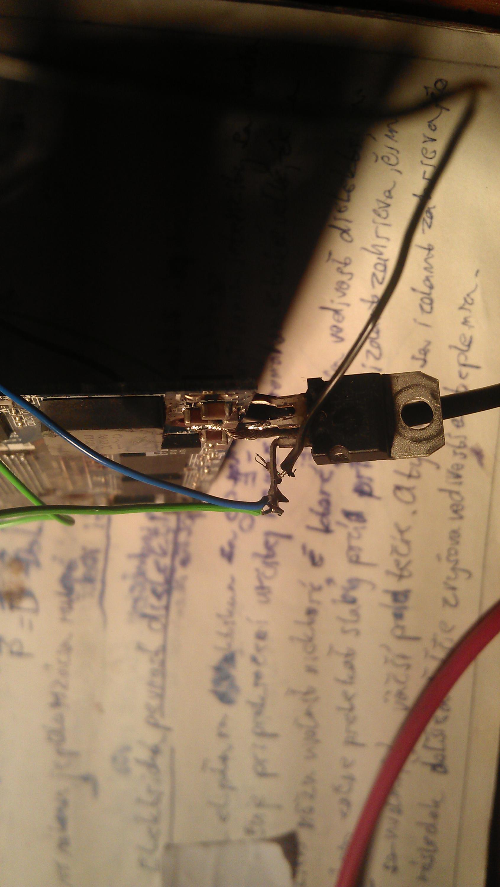

                        there are little more to do than VIN and EN. have isl 6269 on card. must have vin, en, vcc, pvcc. but it giving me 1.7V which is too high. must change Rtop and Rbottom to have right voltage.
                        but it works
                          I already mentioned you will need a 5v regulator for the PWM's logic supply.
                          1.7v maybe was for memory. That won't have as much current capability. Can you post a photo of the card?
                            but it was on biggest coil on board. there is one smaller only
                              here are fotos
