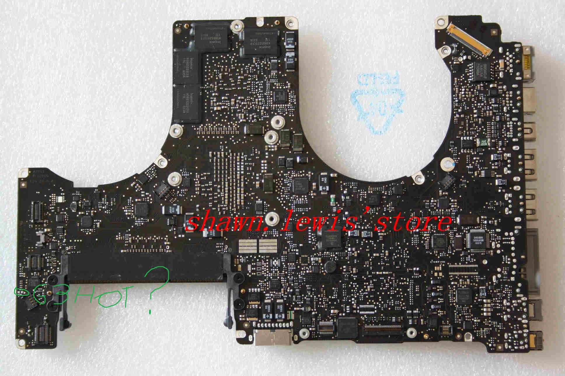

    Well im not a big experienced on macs , so here it goes .
    This one was gave from another store mentioning it turn on in 100 attemps(ex)
    when i chek it , once i insert the magsafe connector , the led stay very very dim , not charging as well , since i don't notice the charging light not turning on as well .
    really dont know much were to start , assuming could be some SMC problems for what i read around .
    cheked that bios got the vcc of 3.30 volts on the usual pins 3 7 and 8
    any help will be apreciated .

          for what i notice i dont have 3.3 and 5 volts on the coils , alltough i got a ldo of 3.3 volts , since the bios is beeing feeded with the correct vcc.
          even tryed to replace the tps 51125 but the same thing occured.

              Re: mac a1286 - 820.2850a not turning on
              could be smc problem. check smc in voltage, and if g3hot 3.42volt is present.
                      this notebook should get ati vga known to be defective, but if it doesnt power on, its not vga for now.
                      dont have schematic and board viw of that by now, but looking on some picture, pad should be on the right side.
                      check voltage on this 2 pad. (the 2 more bigger)

                            if you have dim green light i suspect u dont have g3hot. locate g3hot regulator and measure it.
                            edit:
                            grab it from here:
                            http://forums.macrumors.com/showpost...postcount=2948 tnx to varungargi

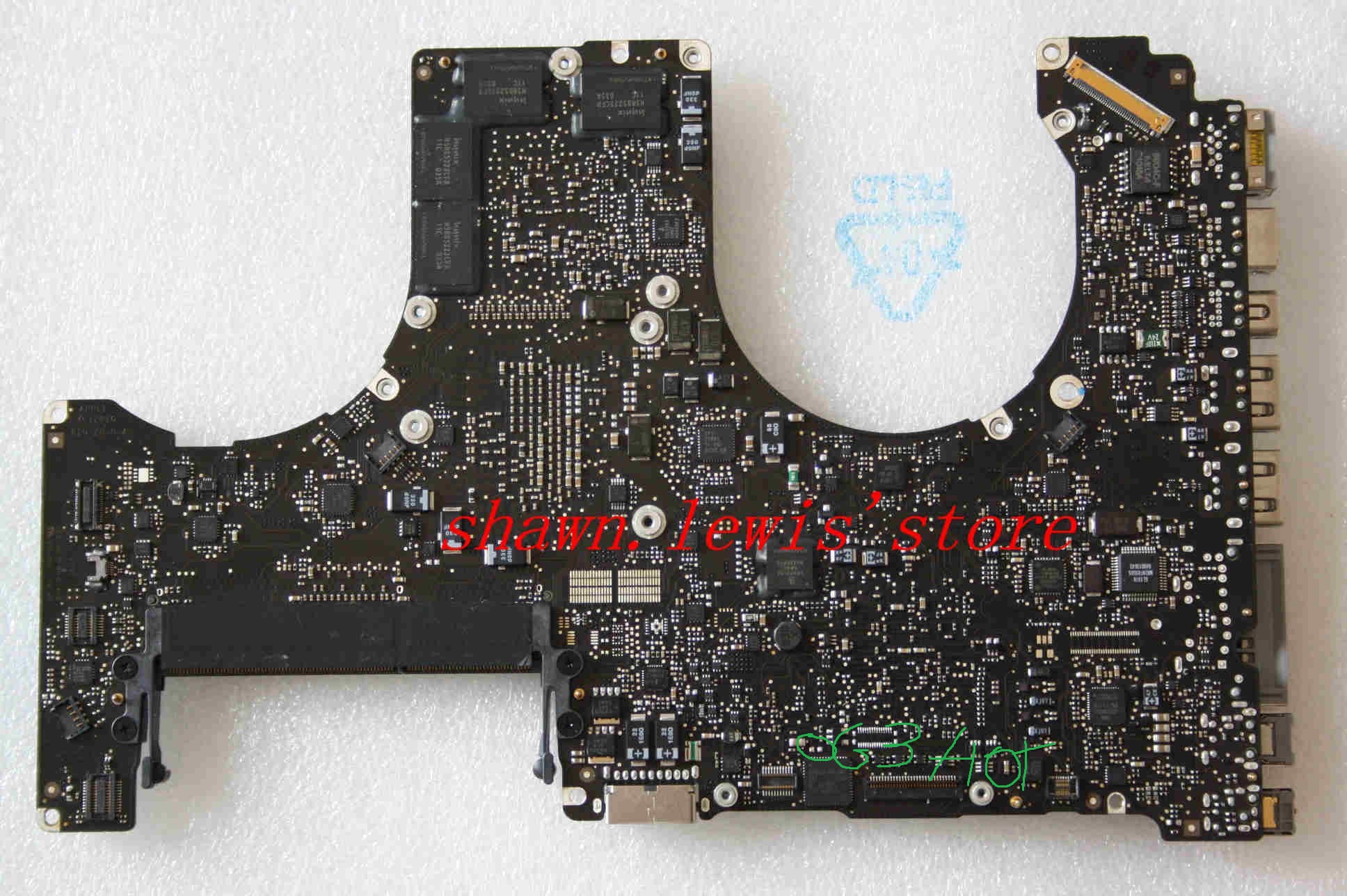

                              DELLXPS If you notice on the photo you sent me , chek near the socket were the keyboard connects , there is a IC cy8c24794-24 right above this Ic there are 2 large pins , on one of does pads , i got the 3,41 volts .

                                there is a coil l6995 , and i got there 3.41 volts
                                  ok new results i got the coil of 3.3 working , the main regulator coils , was under the speaker , just noticed now , and its giving me the 3.3 volts ,
                                  now my doubt is wich is the SMC ic ? is it the one i mentioned right near the keyboard socket ? cy8c24794-24 ??
                                  • dellxps15
                                    • Feb 2014
                                    • 1598
                                    • italy
                                    here is the right place for smc bypass, but without green light and no 3.3 volt it wont start.
                                    check u7000 voltage.
                                    check f7040 if 12.5volt are present.
                                    check l7260 for 3.3 volt.
                                    check l6995 for 3.42 volt
                                    always check both side of coils

                                        like i mentioned the pads you showed in this picture is were i told i found 2 big pads and one of them got 3.42 volts
