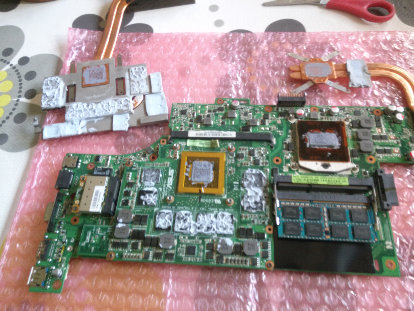

                        Re: Thermal pads in laptops
                        Hello!
                        Nice thread!
                        BTW, I'm waiting for some good quality thermal pads to arrive to clean and change them on a GTX460M of my Asus G53SW.
                        50MM x 50MM x 1.5MM Laird Technologies T-flex 760 Thermal
                        Here's the look of the cooler and graphics card when removed.
                        I'm going to clean it all with Isoprop. Alcohol and apply those thermal pads on memory chips and coils, and MX-4 on die.
                        It's a good and proper way to do it?
                        Wanna keep the beast fresh!
                          looking in the image..... if u have thermal compound on both cpu and gpu, i think 99% thatu dont need thermal pad in gpu. maybe some thermal pad on ram, but there is thermal compound also there, so be carefull that when thermal compound is applied, general no thermal pad are applied since thermal compound+ thermal pad = not good!!
                            He asked about the video RAM and said he will put MX-4 on the GPU. Yes, that needs thermal pads. It doesn't run too hot so pads will do, there is little point bothering with shims for that. BTW, MX-4 is the same paste i use and it is great.
                              Hello and thanks for the inputs!
                              This is how the cooler came from factory. The coils of the GPU has thermal pads, gonna renew them.
                              The VRAM has thermal compound, gonna remove it and apply thermal pads.
                              On the GPU , I'm gonna put some MX4.
                              On cpu side, there are thermal pads for the coils, gonna change them also with new thermal pads , and MX4 on the die.
