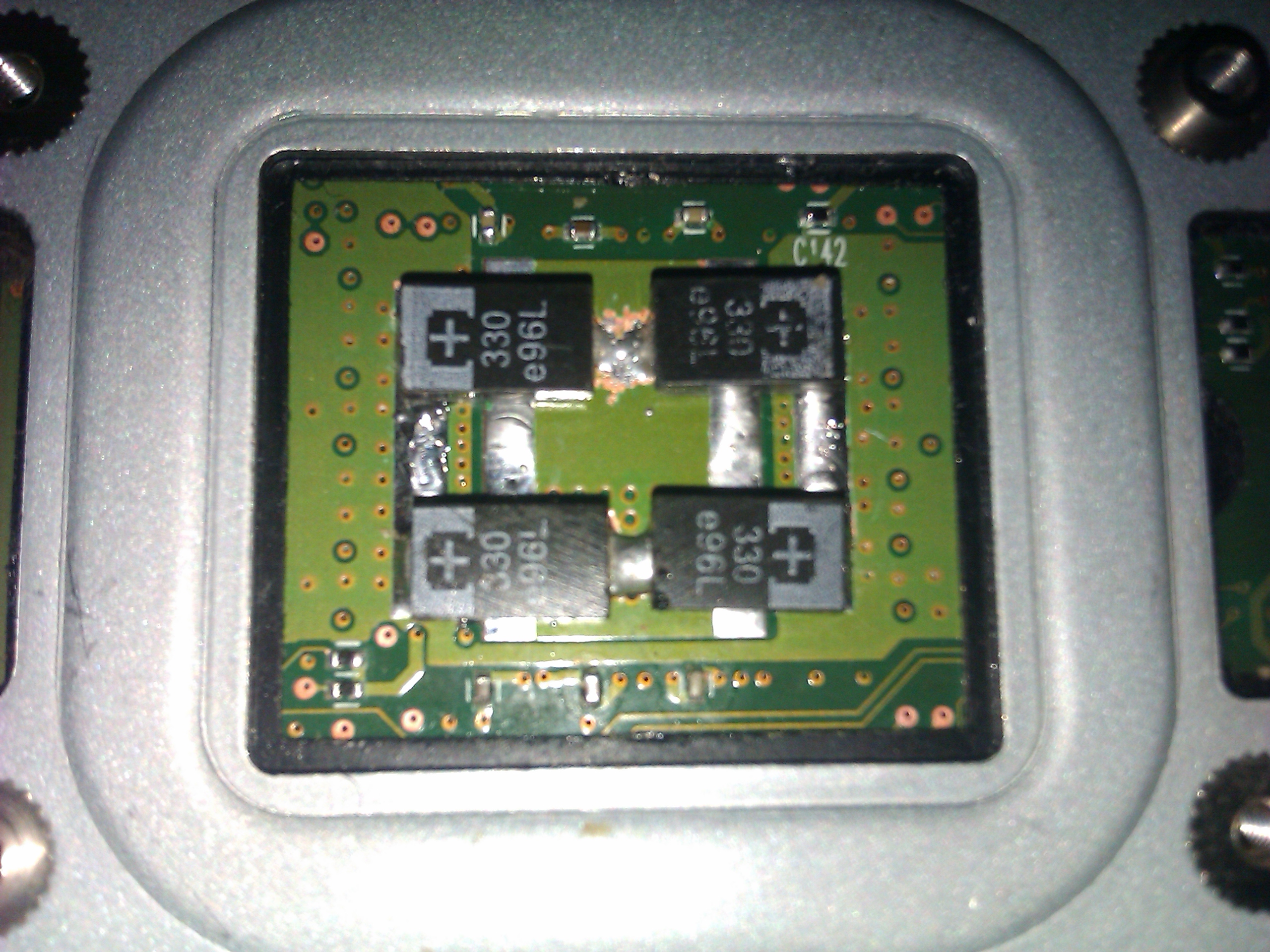

    hi guys i need help
    i have satellite a300-22z with bad hdd... i put new hdd in and in install and after it started freezing... so i opened it and changed nec/tolkin with 4 smd 330 capacitors
    after that i get leds, fan spinning but no image
    voltage on 4 capacitors upon power up start rising sometimes to 1v and than goes to 0v (vcore), cpu not heating
    all coils have voltage except L809 and L810 wich are 0v and 5v and 3v present on board
    can you help pls?
    i can also hear something like sqeeling sound but its very quiet and i cannot locate exact spot

    reflow nb if it is ati

      all intel except ATI vga, which is on MXM slot, removed from board while testing voltages, and same with it or without it...

        Show us a photo of the repair. Did you read the other thread to find out what not to do?
        My A300 has a faint squeal also, it might be normal or the capacitors you used might have too much ESR. How much ripple is there on the Vcore rail?

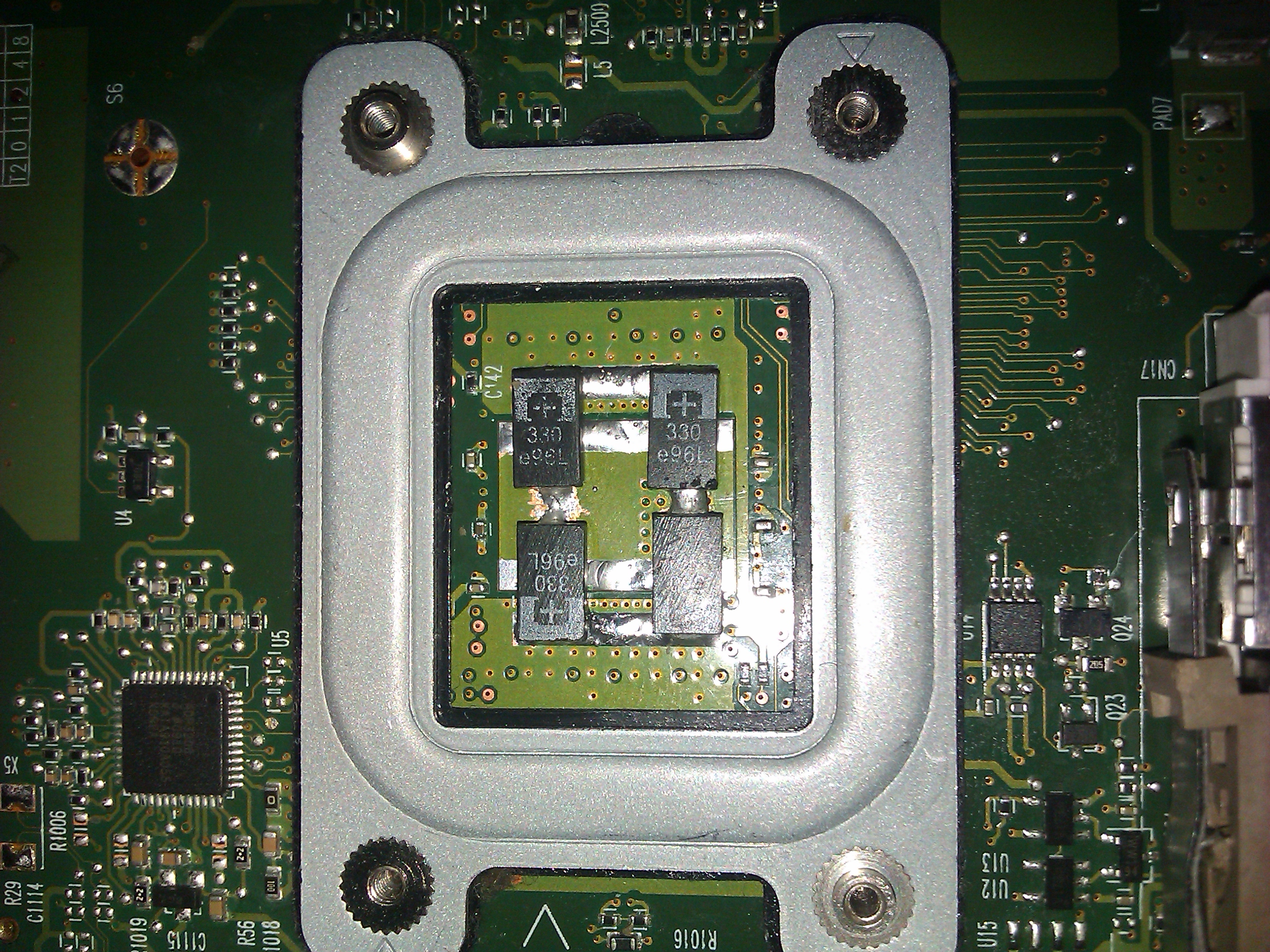

          Re: a300-22z pt10g help
          i had done this few times already... 330 are new, tested before from same package on other laptop, works 100%
          i reworked the capacitors again
          pic taken from the phone
          i also noticed L809 and L810 have 0.995v whe running on bat, but 0v on dc and 0v if dc+bat (330caps have 0.995v when on bat :/)
          something wrong with charging? but when off and bat+dc connected it shows charging battery led... confused :/

            It is a puzzle to me also, it should have just worked. I dont have the correct schematic. If L809 & L810 are in the Vcore regulator, the voltage will be the same as the voltage on the replacement capacitors, Vcore rail. Does the Vcore come up at all with the AC adapter on?, even briefly.
            What are the specs for the capacitors?

                        those caps or NOT TO BE CONNECTED to scratch ground.
                        i don`t understand why ppl scratch the board.
                        those caps got a ground for a purpose.
                        please take them down and clean the board and reflow the chipset!
                          well i dont see the difference since the scratched place is at the same pad as original contacts....
                          anyway, i have placed capacitors as you suggested and its all the same
                          i even got a second, nonworking motherboard so it might help me with repairs
                          about reflow: did you mean reflow northbridge or southbridge (AF82801IBM)???
                          tnx for helping and taking interest in my thread
