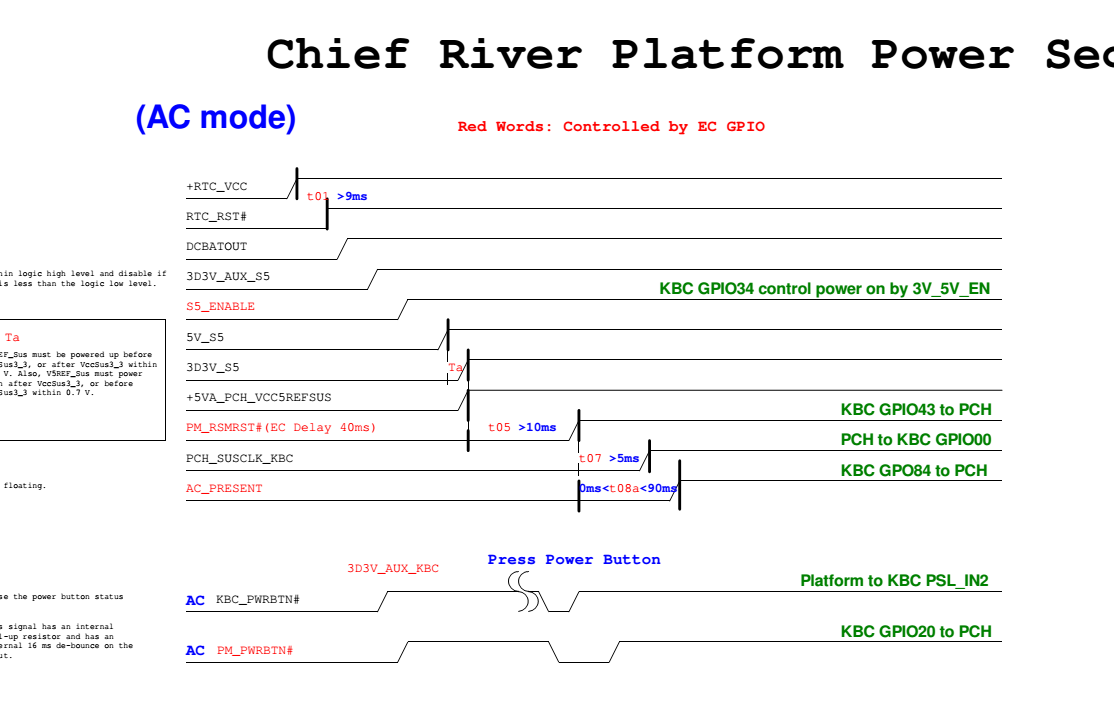

    Brother, i Have problem with dell 3421 no power issue. Its 5v, 3v ok. I have flashed bios. but no power. SIO power 3.3v and VCC POR 3.3v ok. But Sio not release Rsm_RST. So dont know whats wrong. can any body point out this problem.

    your RSMRST from southbridge that goes to SIO chip so if its missing then do a reflow or change the chip.

          RSMRST does not come from southbridge and goes to SIO?

            Do you have all the conditions prior to RSMRST met?

              Thanks everybody speacially Khaahk. I have noticed that 5v_s5 and 3.3v_s5 is not present in U3601 AND U3602. But I have a same working Motherboard this board also 5v_s5 n 3d3_s5 is not preset without power button press. But this schematic indicate 5v_s5 and 3.3v_s5 must be ok befor rsm_rst#. I dont know what happend.

                Both powered from adapter?

                  No, i used bench power supply. Both from power supply, also use adapter. The ok motherboard RSMRST# is ok but faulty motherboard rsmrst not present.

                                      My personal experience is PM_PWRBTN# signal is lost and I just reflow the chipset and the laptop can switch on. Thank's for sharing the schematic
