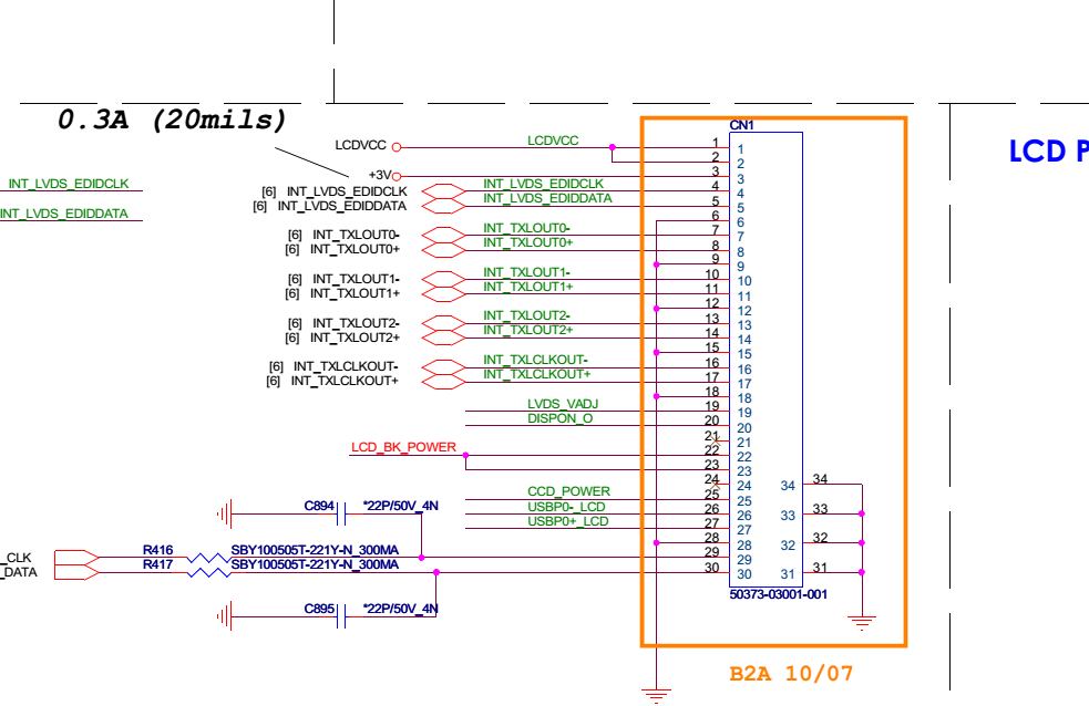

need help with my Toshiba l755 backlight

    everything was working fine till the laptop bricked due too a bad flash . then i gave it to someone he has the bios programmer , he programmed it and the laptop start to working and booting again like normal without backlight enabling ???

                    Are you able to check voltages? Pin 20, 22,23 lvds connector? With laptop turned on. Carefully.
                    Fuse pf2 is connected to battery in your case, has nothing to do with blight.
                    Backlight is driven by pch.

                        khaahk> LCD is driven by KBC/DISPON_O/ and PCH/LVDS_VADJ/
                        dont give up. its easy fault.
                        Check for voltage on LCD signals LCDVCC, LVDS_VADJ, DISPON_O and LCD_BK_POWER on power on laptop

                          Re: need help with my Toshiba l755 backlight
                          Originally posted by khaahk
                          EC usually has output that drives the backlight enable circuit. Sometimes just this output of ec is dead, then the laptop will work fine otherwise.
                          If the schematics is correct, then DISPON signal is not driven by EC in your case
                          EEEEEEEEE! Wrong ! DISPON_I pin 27.
                          if the screen was attempted to be replace with battery ON then it will cause a short to KBC : no backlight or full dead
                          swap the KBC NUVOTON NPCE791LA0DX and your good to go.
                            Pin 27 is input from PCH, backlight is turned on by EC pin 6, does it require pin 27 from PCH to be high or not, that is a good question...
                              yes. DISPON_O - 3.3V, LVDS_ADJ - 0V-3.3V/3.3 is full light/
                                very common on this machine to fail the PCH , for video issues , loosing sound after a while , camera getting hot .. for my experience and for the incoming machines we've got per day , 80% of the l755 problems are related to pch
