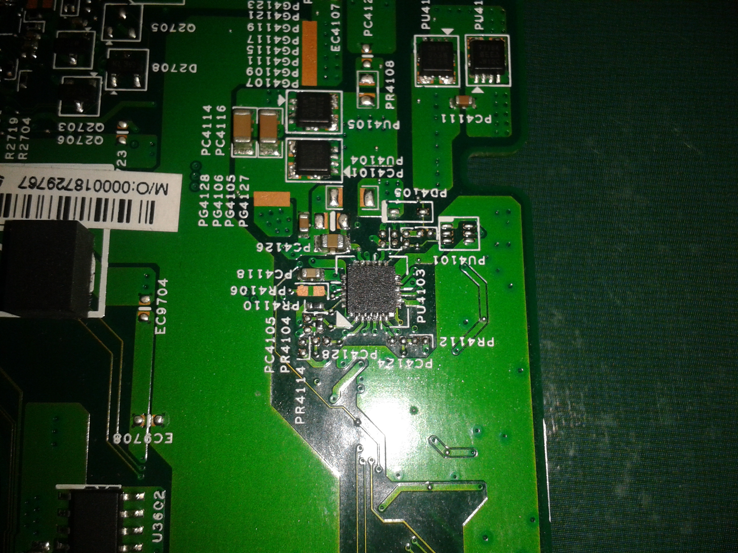

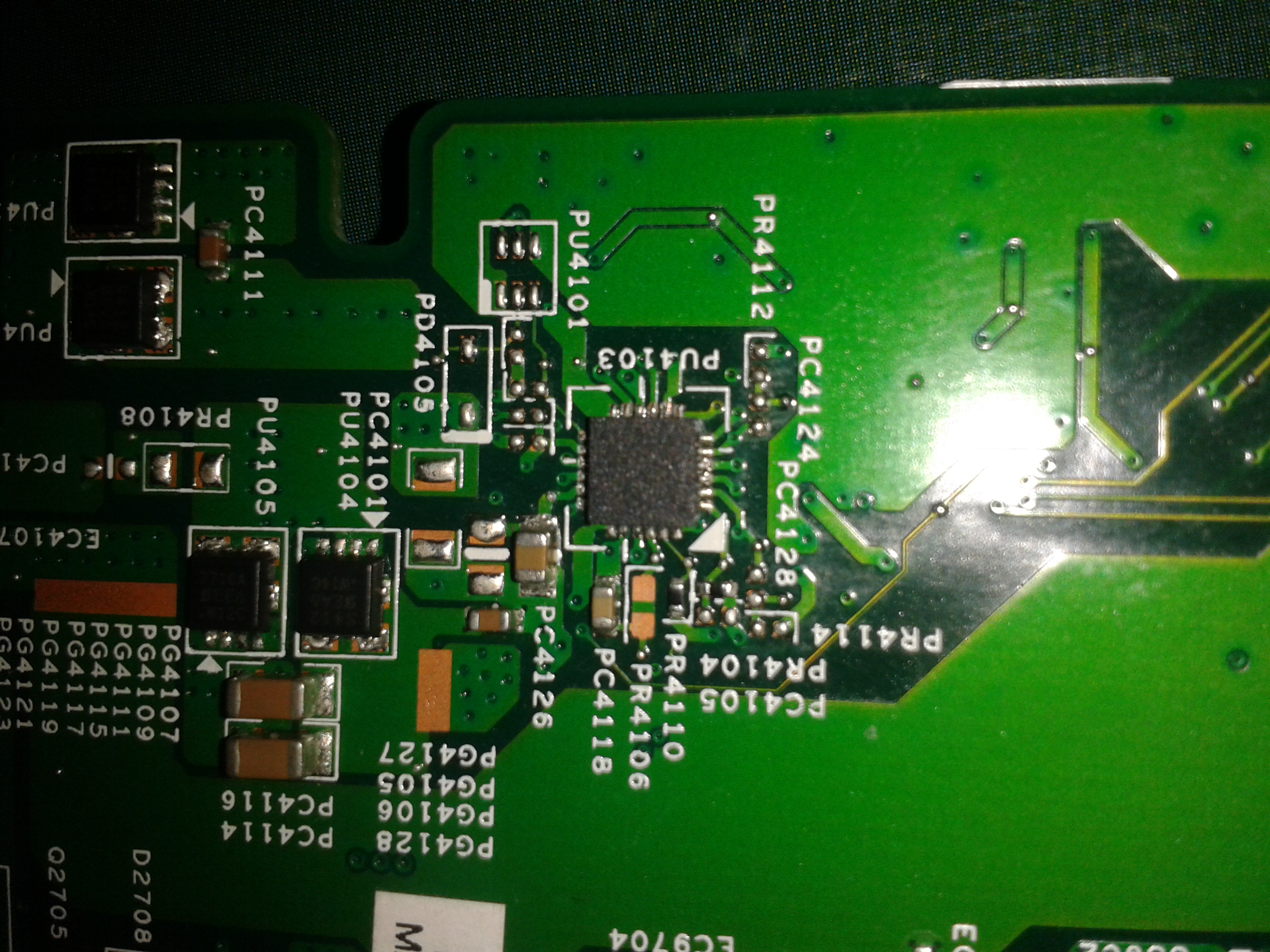

                            • shijeesh
                              • Mar 2011
                              • 65
                              Re: Dell N5110 Not Power ON
                              This is the VREG3 and VREG5 image.
                              • alihomee
                                • Dec 2012
                                • 1593
                                • malaysia
                                ehat is the ic num
                                • shijeesh
                                  • Mar 2011
                                  • 65
                                  5v/3d3v(tps51123rger)
                                  • shijeesh
                                    • Mar 2011
                                    • 65
                                    Sir please help me.
