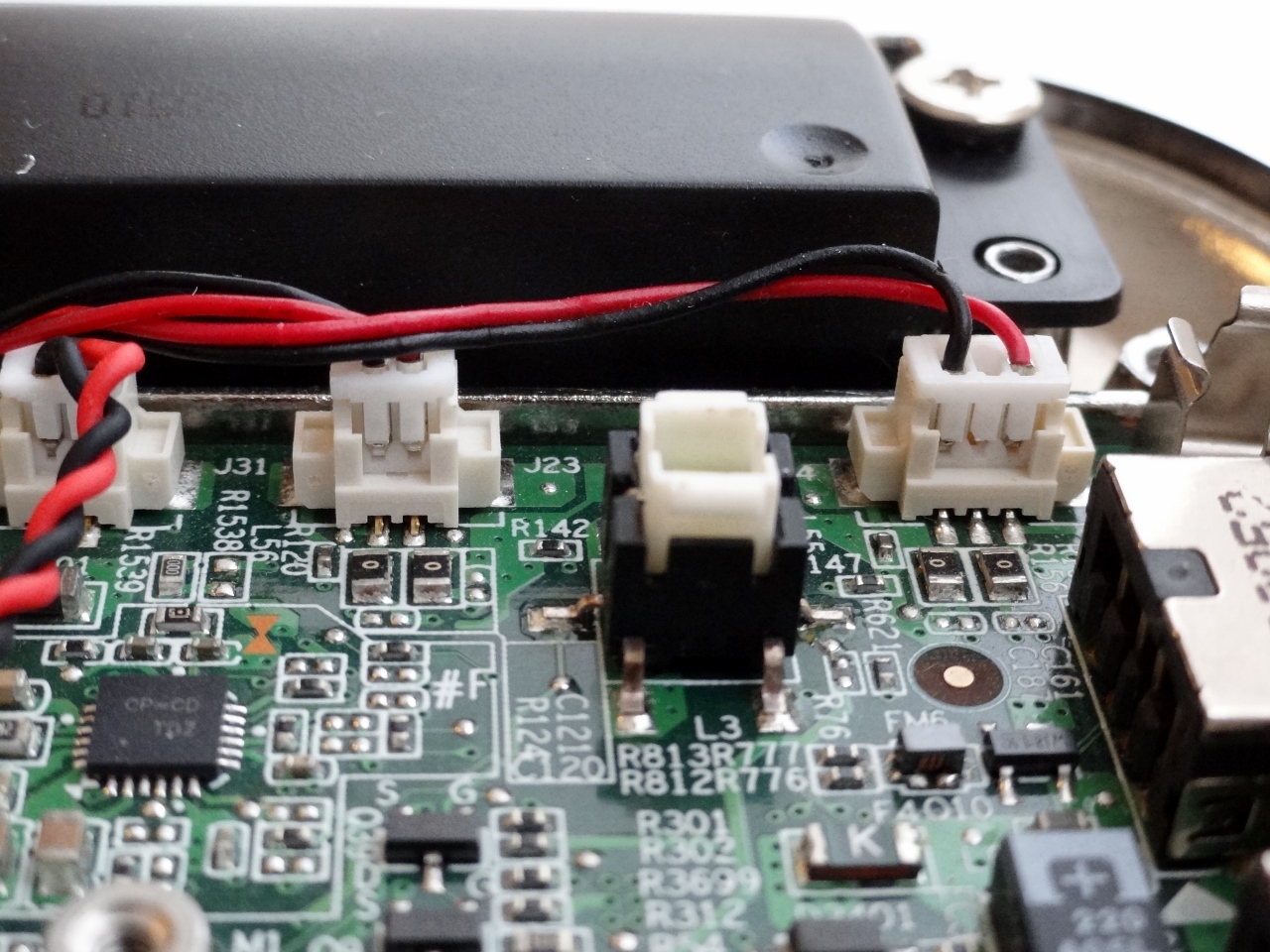

    Hi Guys, I'm looking to get a Lenovo IdeaCentre A310 back up and running which has got problems with the power switch. It's a 6 pin switch which I am unfamiliar with. Only ever seen 2 pin ones and 4 pins ones before.
    So I assume with this switch two pins will be for LED, Power Switch, Reset switch?
    What I plan to do is short two of the pins with a bit of cable to see if I can get the board to jump start.
    I am assuming the 2 central pins running through the yellow bit are for the LED?
    Which ones will be for the power switch and does anyone know where to find a replacement?

    I suppose you could test how the switch operates by putting your meter in ohms across the joints ( without the power on) If the switch works.

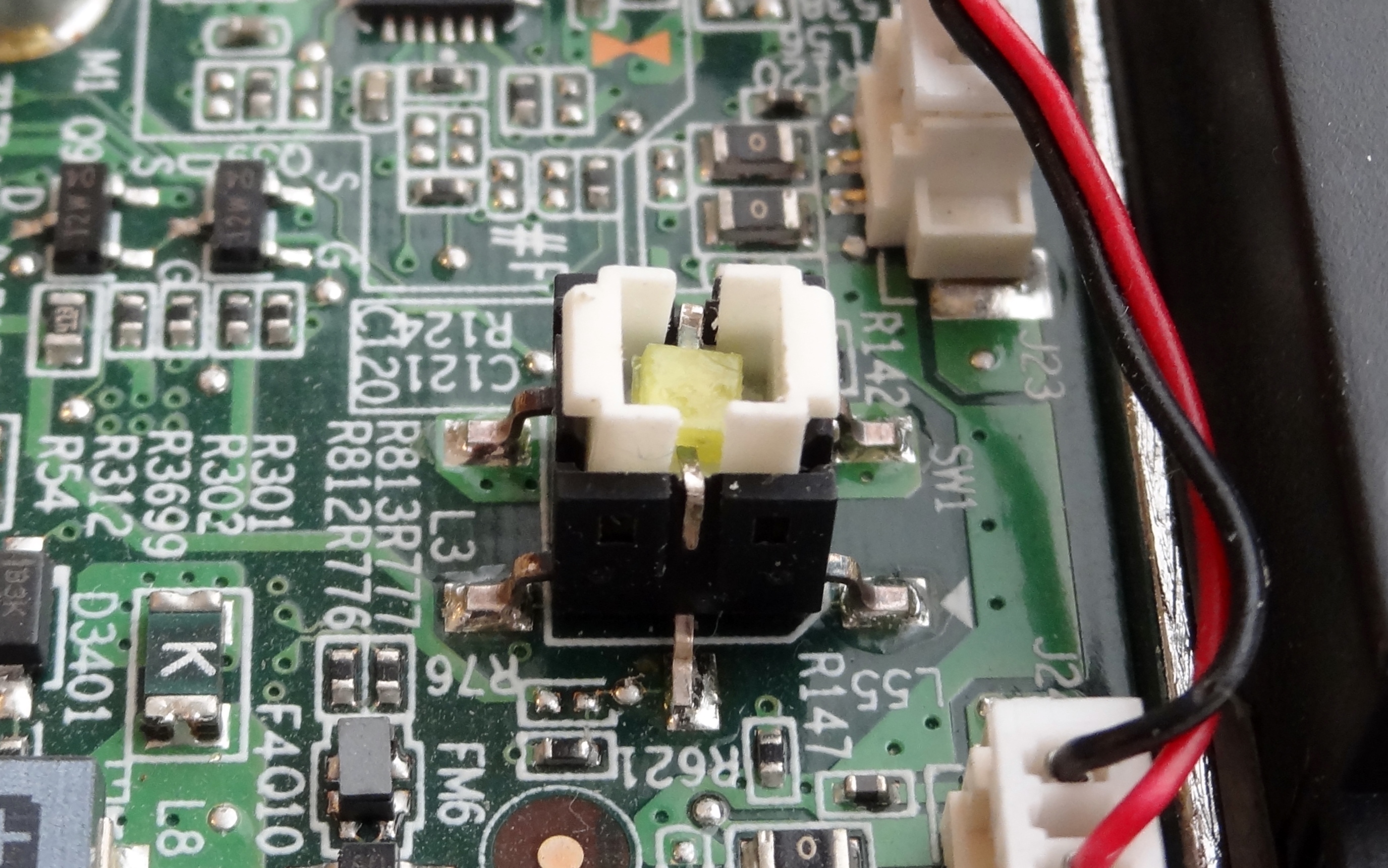

      Switch is dead, the clicky bit has disintegrated.
      I was hoping I could just replace with a simpler on / off switch, perhaps with reset. LED/Reset are not exactly crucial.

          Perhaps it is just on/off and led, I was just guessing there was perhaps a reset function due to number of pins.
          • mikay786
            • Aug 2014
            • 765
            Re: Identifying a Power Switch and Function

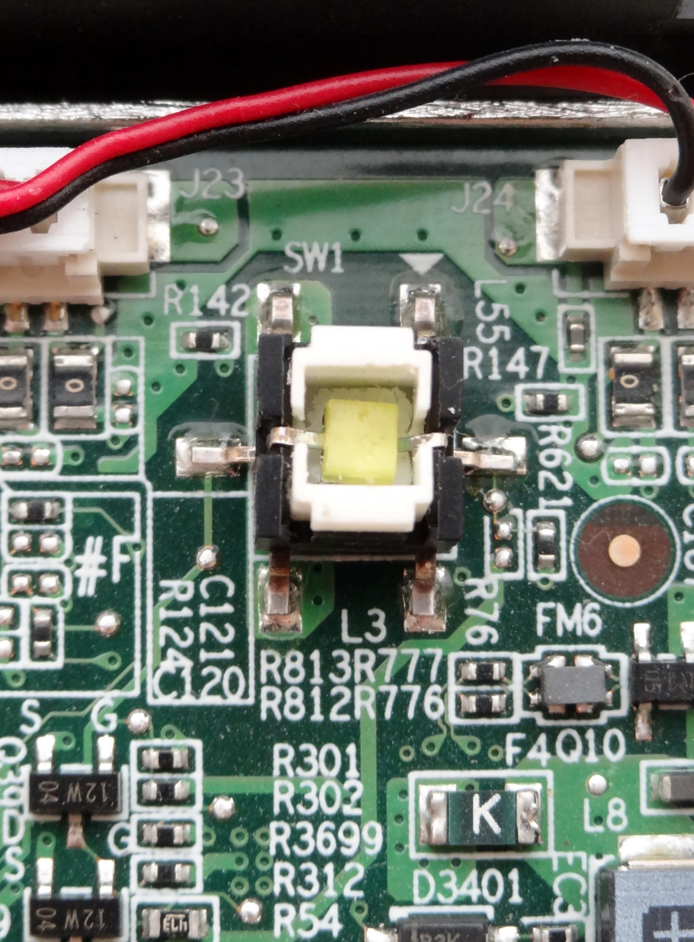

            SW1 and Triangle pins / positive?
            or
            triangle pin and opposite (L3) pin / positive?

              jump across the top pair of pins.
              it's just a 4pin push switch with an led inlaid over the button.
                It looks like momentary switch with LED. The typical set up is the top right pin with an arrow is internally connected to the bottom right pin, the top left is also internally connected to the bottom left pin. When the button is push, the electrical contact will be made between the top/bottom left side terminals to the right top/bottom right side terminals.

                  Cheers so to jump I need to make contact with SW1 pin and the Triangle pin
                  Do you know of any momentary switch with a LED I could use?
                  If not a normal 4 pin momentary switch will suffice.

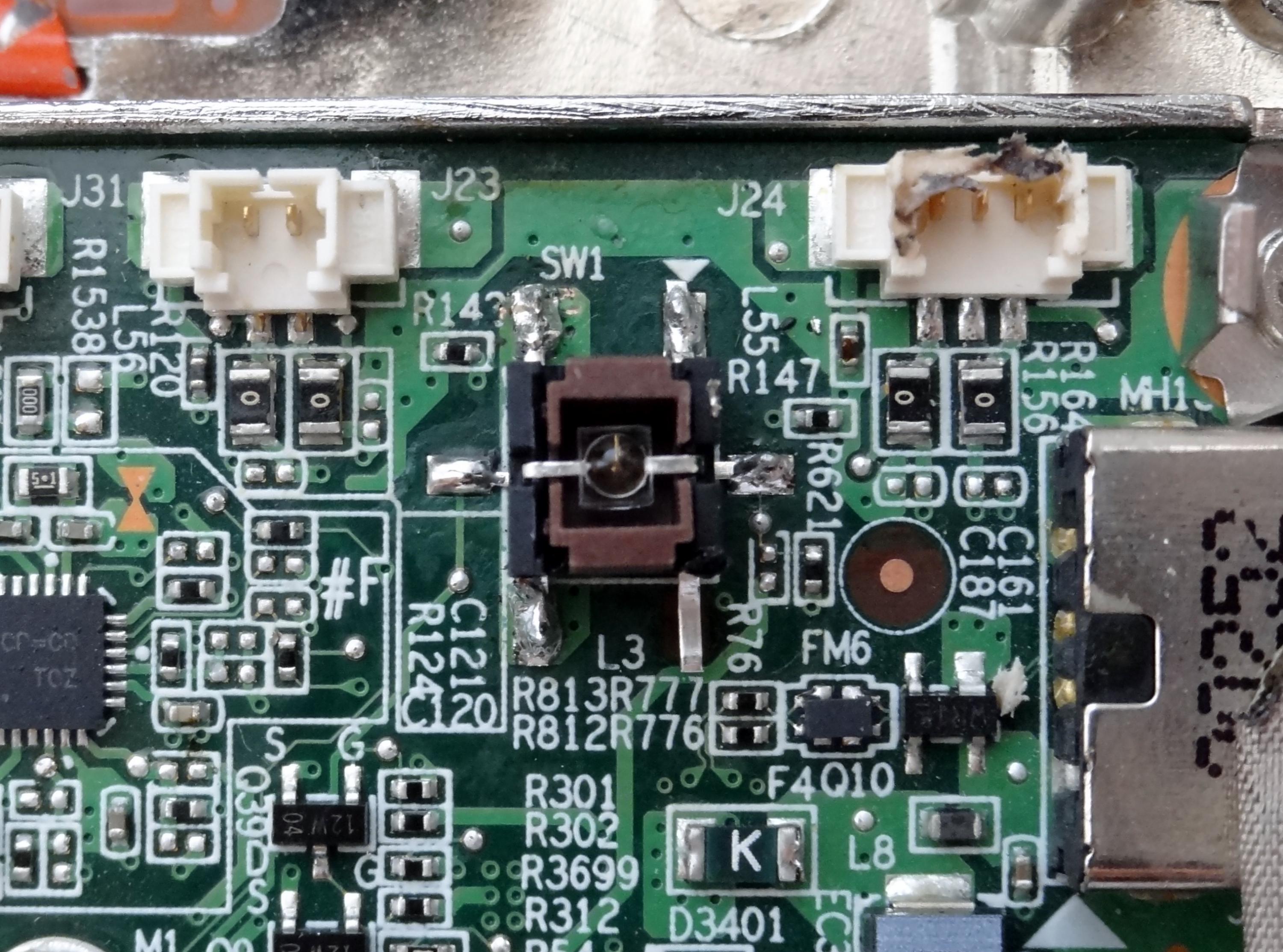

                          And it lives!!
                          Thanks guys, as above were the correct pins to jump, thanks. Have been waiting on the PSU which was delivered today, so tried the jump and booted up fine.
                          Going to go with the non SMD variant as can pick up from local farnels for £0.50p and just cut and bend the pins back. Will that be ok?

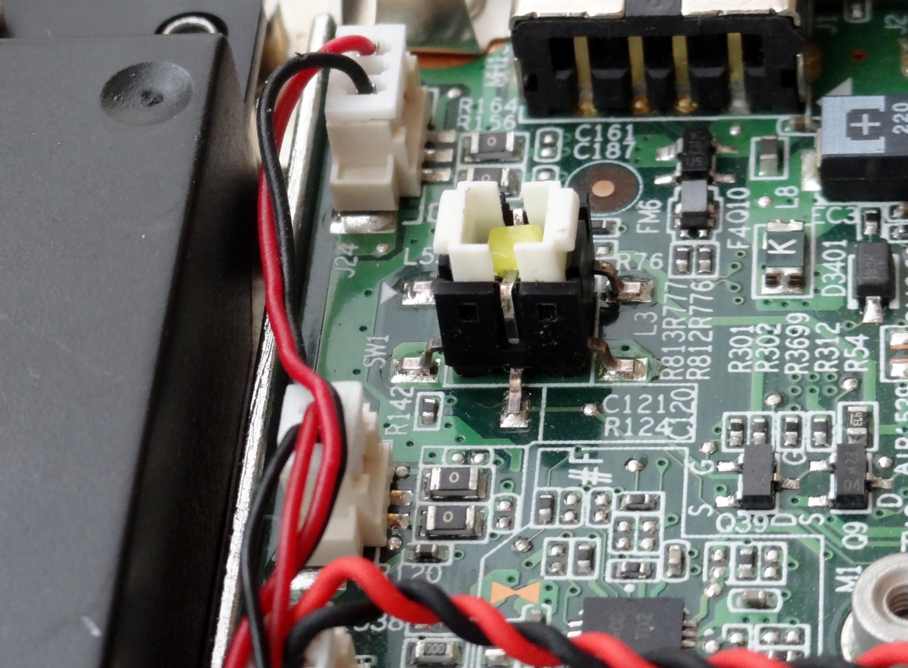

                                No had like plastic locating pin underneath
                                I think I found something similar that is surface mounted from farnells. What you think, will it do
                                http://uk.farnell.com/e-switch/tl324...vdc/dp/2115628
                                compared to the through hole
                                http://uk.farnell.com/multicomp/tll-...led/dp/9472010 -

                                  Personally I would try the 50p one (tight - born in Yorkshire!!) have you looked at the data sheets for the placing of the pins.on both and does the height matter. Also is it just a low voltage switch - not mains.

                                    bend the pins,
                                    the smd one will hit you for £15 delivery from the u.s.!!!

                                        Feeeew I nearly went and ****** it up!
                                        I should have pointed out this was my first time working on a board and properly with a soldering iron, have done a little soldering before just joining wires etc. Have got a desoldering gun which is brilliant for through hole stuff but this was a surface mounted switch.
                                        So what did the noob do
                                        Along with melting some plastic bits he pulled a pad up!!!
                                        But thank god it seems it wasn't crucial to the switch working, and here my finished job
                                        Yay, well the LED doesn't work, perhaps its linked to the pad I ripped up but the switch, on/off does work perfectly YAAAY
                                        Might pop some glue around the switch to make sure it is sturdy?
                                        I could of gotten my brother in law to do it but where's the fun in that feels so good knowing you have brought back something to life
