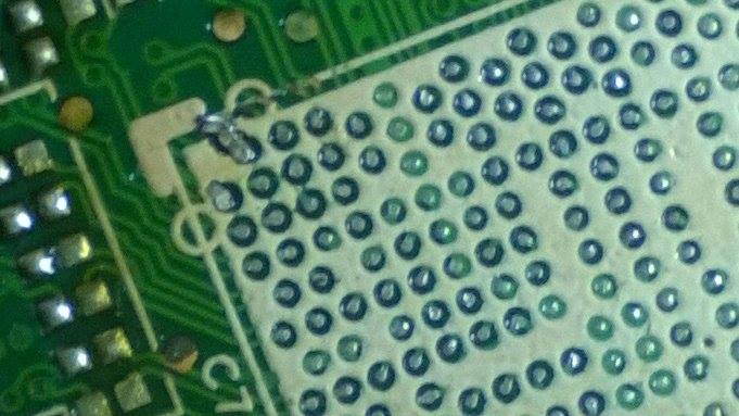

    Hello guys, I went to reball this one (yes it has been reworked by someone who was not careful with removing of the black epoxy).
    So here is the picture is this a dummy pad or not?

    its that solder? or the pad its fubar?

      i think that pin was repaired. not many guys doing that

        The pad is destroyed not fixed. Since he destroyed the mask whole dummy pad (yea its dummy) is lifted and it looks like its fixed .
        Today everyone tries to do reworks ^^.
