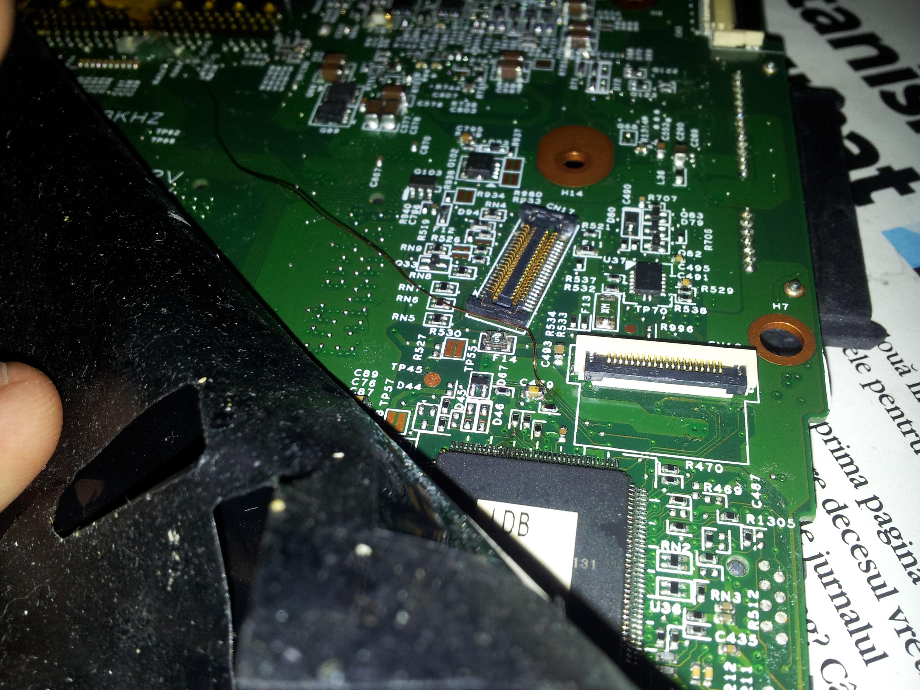

    After change screen maybe with battery on, no video on screen. I do have video on VGA out. Screen is LED 40 pins. What can I check on it? I do have 19V on LVDS cable.

          Have you checked for any fuse near the lvds connector? Does it have picture but no backlight?

              Probably the sio (embedded controller) has died. Usually the pins that control brightness, have no serial protector resistance, (connected directly) so current trough this pin became extremely high, destroying this sio output.
              Try to cut this trace, and supply a fix 3,3v at connector brightness pin.

                Thanks to all for replay. I do have image, but no backlight.
                I checked datasheet of screen LP156WH4 and I have:
                pin2 3.3V
                pin3 3.3V
                pin4 3.3V
                pin 36 (LED_EN) 0,26V
                pin 38,39,40 - 19V
                I think problem is pin 36 (LED_EN) 0,26V. I checked the same pin in motherboard and I have the same 0.26V
                I think in this pin I should have 3V to enable backlight on/off, right??

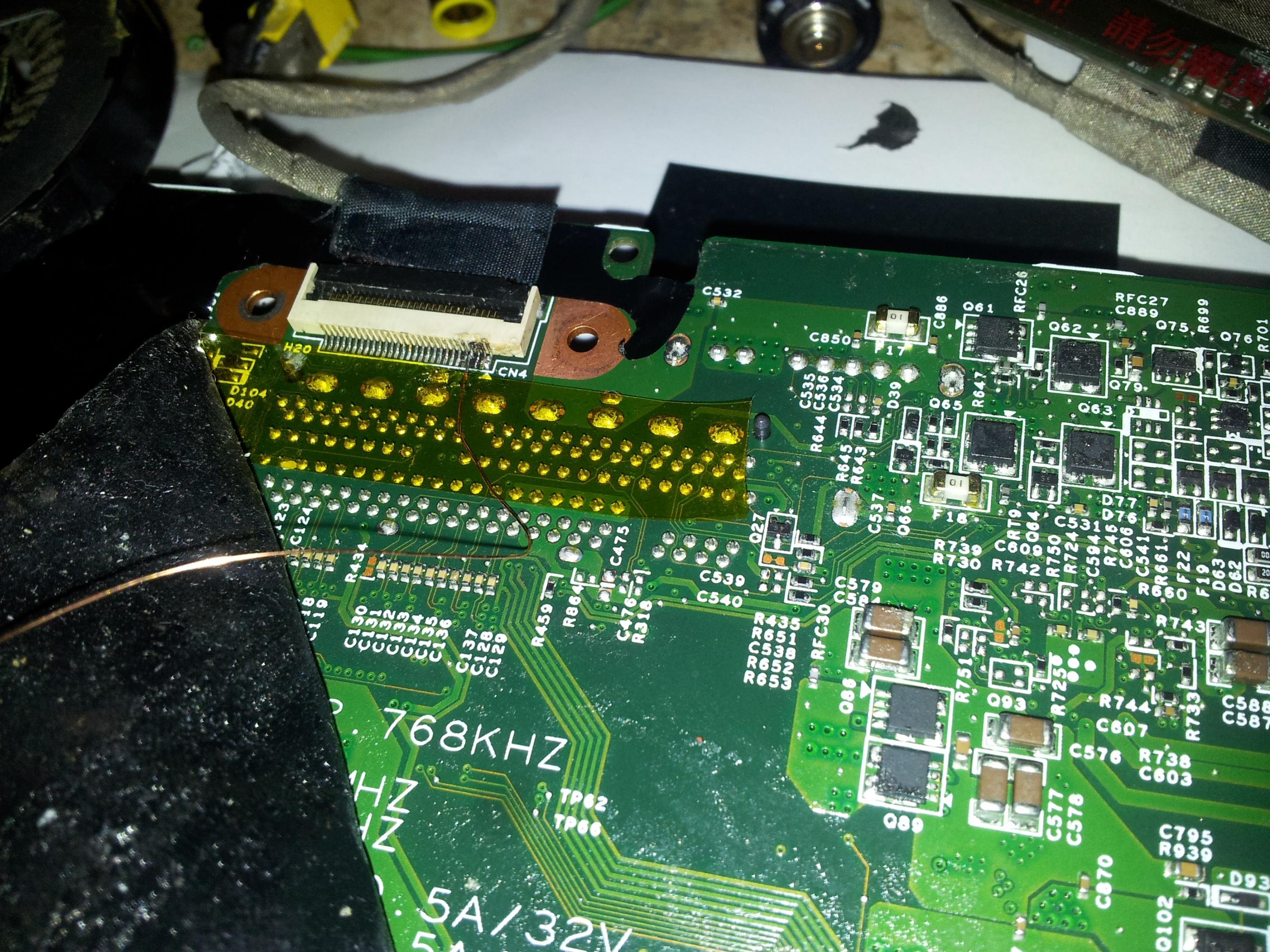

                  Yes exactly. I have the exact same problem with a Lenovo X200 that someone brought in a couple days ago. The backlight died after a water spill on the board. I have managed to fix the 20v power trace (a fuse blown and some corrosion), but i have LED_EN shorted to ground, so still no backlight.
                  I'll let you guys know if i manage to fix it.

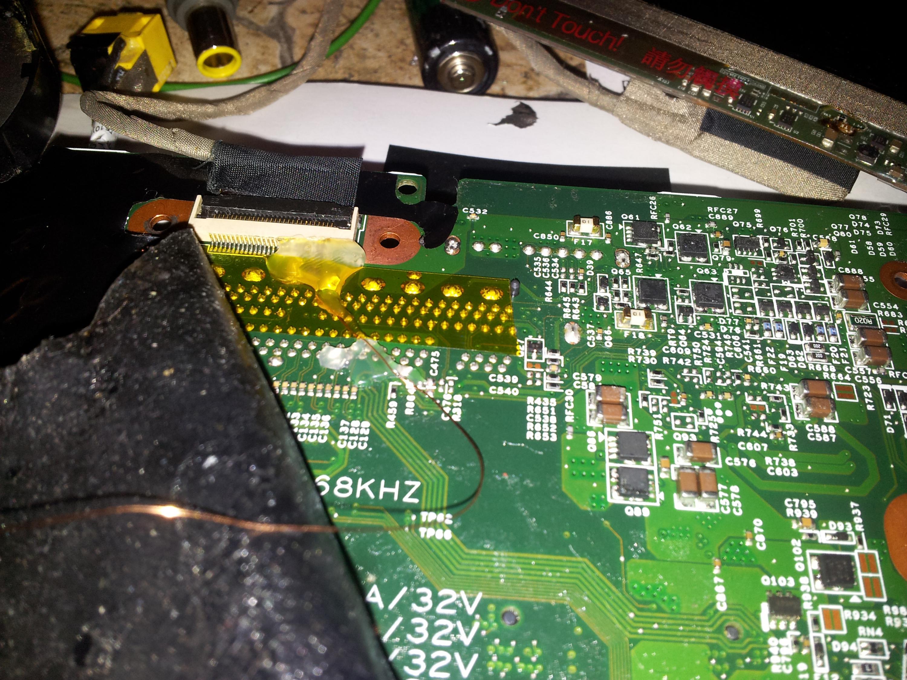

                    I did fix the Lenovo - i lifted the BACKLIGHT_ON (aka LED_EN) pin from the display connector and wired it to 3.3v from somewhere else on the board. The laptop lost ability to turn the screen backlight off but that's better than no backlight at all. It does turn off when the laptop is put into sleep or shut down, so that's good enough. It's back to the owner now.

                        Hi Th3_uN1Qu3
                        I found that pin 34 is System PWM Signal input for dimming and also has to have 3V
                        By the way, what did you put on the cable to aislate?
                          Re: After change screen no video
                          Hot glue.

                            Yesh, but do you use this one? http://www.leroymerlin.es/img/r25/04...2218640_ls.jpg
                              Something like that.
