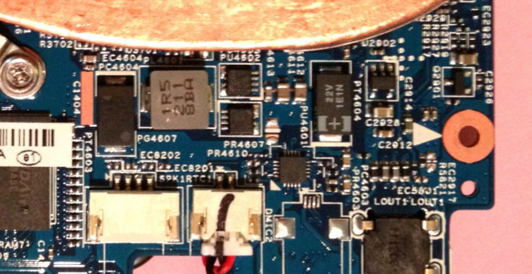

      hi all wel im back with promised picture
      hopefully this is a simple part to replace
      I have circled the area where the damaged component is
      I have multi meter so can test certain components

            Re: s3 ultrabook wont turn on has flashing blue light
            mate I don't have a decent cam at the moment
            heres is a shot of the board the part that seems to have blown is marked with red line
            and the blue circled area is the part on my board that's not there ie burned it
            what im asking for is some help with reading the components to see if its just a case of replacing them hopefully it is
              I can't see anything missing from your pic to ebays pic. Have you tried taking a photo in macro mode? Or why don't you simply post what's written on the damaged IC? Identifying the IC is half way to know how to test it..
                it looks like there's nothing in there in the first place... try cleaning that section with denatured alcohol with a brush to remove the leftover of the liquid, let it dry and test.
                • spleenharvester
                  • Mar 2010
                  • 902
                  Yeah clean it away, using 99.9% IPA or whichever you choose - burns can look much worse than they actually are.
                  But to me, on your photo, it looks like a large section of PCB tracks behind that MOSFET have blown off. If I'm right, and it's the ground side, you might be able to bridge it somewhere. If it's the source/drain side, you may possibly be able to bridge it somewhere.
                  EDIT: Just looked again, looks like ground side to me. Test every component in that area if you can.
                  Let's hope I'm wrong. Liquid spills like these can be nasty, often many other blown parts surrounding. Good luck to you.
                    my laptop will no longer switch on has a blue light that flashes every 2 seconds or so when using off the battery or steady orange and flashing blue when ac pluggeg in
                    Apologies for double posting, but I can't help but notice that's extremely similar to the problem with my L500, which I could never figure out. https://www.badcaps.net/forum/showthread.php?t=30337
                    I'd test resistance to ground of as many components/voltage lines there as you can - look at the schematic.
                    In my case, there was a short on the northbridge side which I couldn't track down.
                      there is other pic on that list from ebay but still i can`t see the codes
                      dl this pic and mark what is burn
                        hi mate these are the numbers of the mosfets I think that's what they are
                        from top left of the red square
                        part has this printed on it
                        PC3AB
                        fdmc
                        7672s
                        next one down is
                        PC2AH
                        fdmc
                        7696
                        since learned its this I think
                        Fairchild FDMC7696 30V N-Channel PowerTrench MOSFET
                        this is the one blown I think I will need to test
                        so can anyone tell me what I should be looking for I have a multi meter
                        I have now learned hopefully the burned out are all ground on pin 5,6,7,8
                        can any one tell me correct readings for 1,2,3,4 with ac connected and disconnected
                          PC3AB
                          fdmc
                          7672s
                          next one down is
                          PC2AH
                          fdmc
                          7696
                          link:
                          they are both single mosfets, if you are not sure how to test them this link will help you, https://www.badcaps.net/forum/showthread.php?t=30648
                            1-3 source
                            4 gate
                            5-8 drain
                              so if 1,2,3,4 is good basicly ,5,6,7,8 are all on a ground is that right meaning it could live again
                                you need to test it in diode setting on your multimeter, as in the link I gave you, then post results
