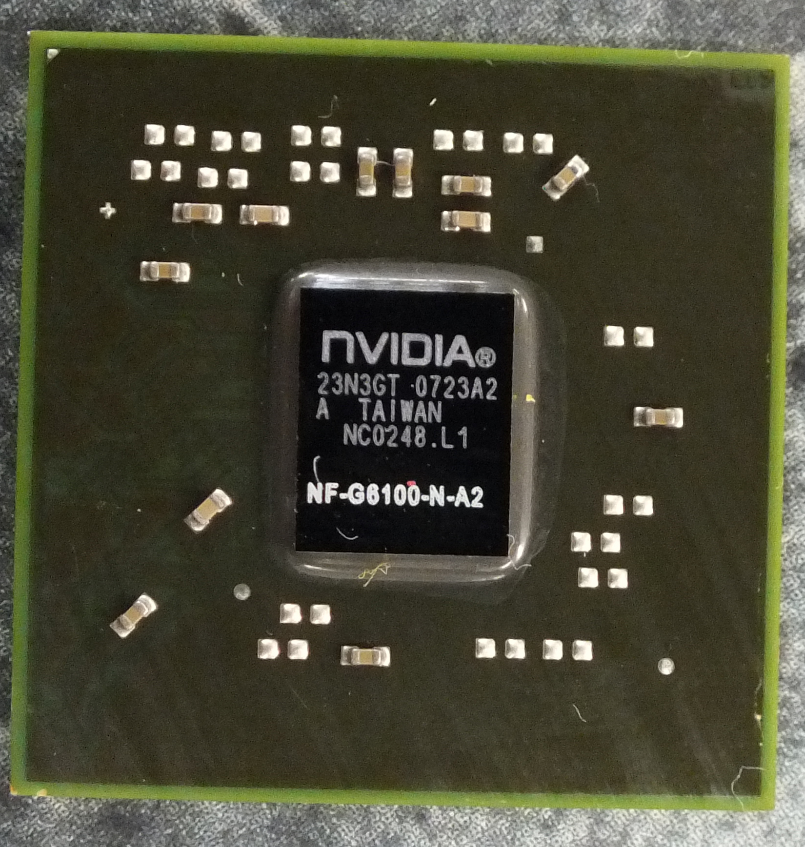

    It takes time to get a laptop naked just to get to the motherboard. It takes flux, epoxy remover, heat and electricity just to remove a chip in which I'm getting tired of doing. Is there a way to test BGA chips? I don't mind taking them off just to test.
    Nvidia Chip off an HP G6000:

    The only thing that you can probably do is apply power and see if it gets hot.

        Impossible.
        Only way to know is to first do a reflow.
        Aside from plugging laptop into external monitor first after checking other components such as CPU and RAM since they give almost the same symptoms as a bad GPU.

          You could do a OHM messure after reball still you have to reball it :P. (and sometimes it shows good rating and its crap, sometimes shows crap rating its good you can never be sure -,- ).

                    I hear what you all are saying but it's time consuming to reball and the chip is already bad. I just need a way to test before I do the reball.

                      There's no easy way.
