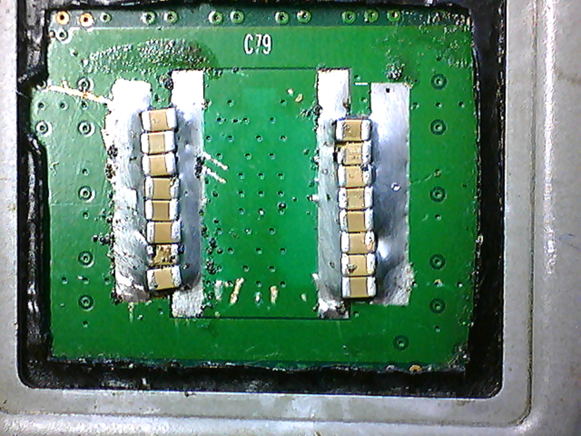

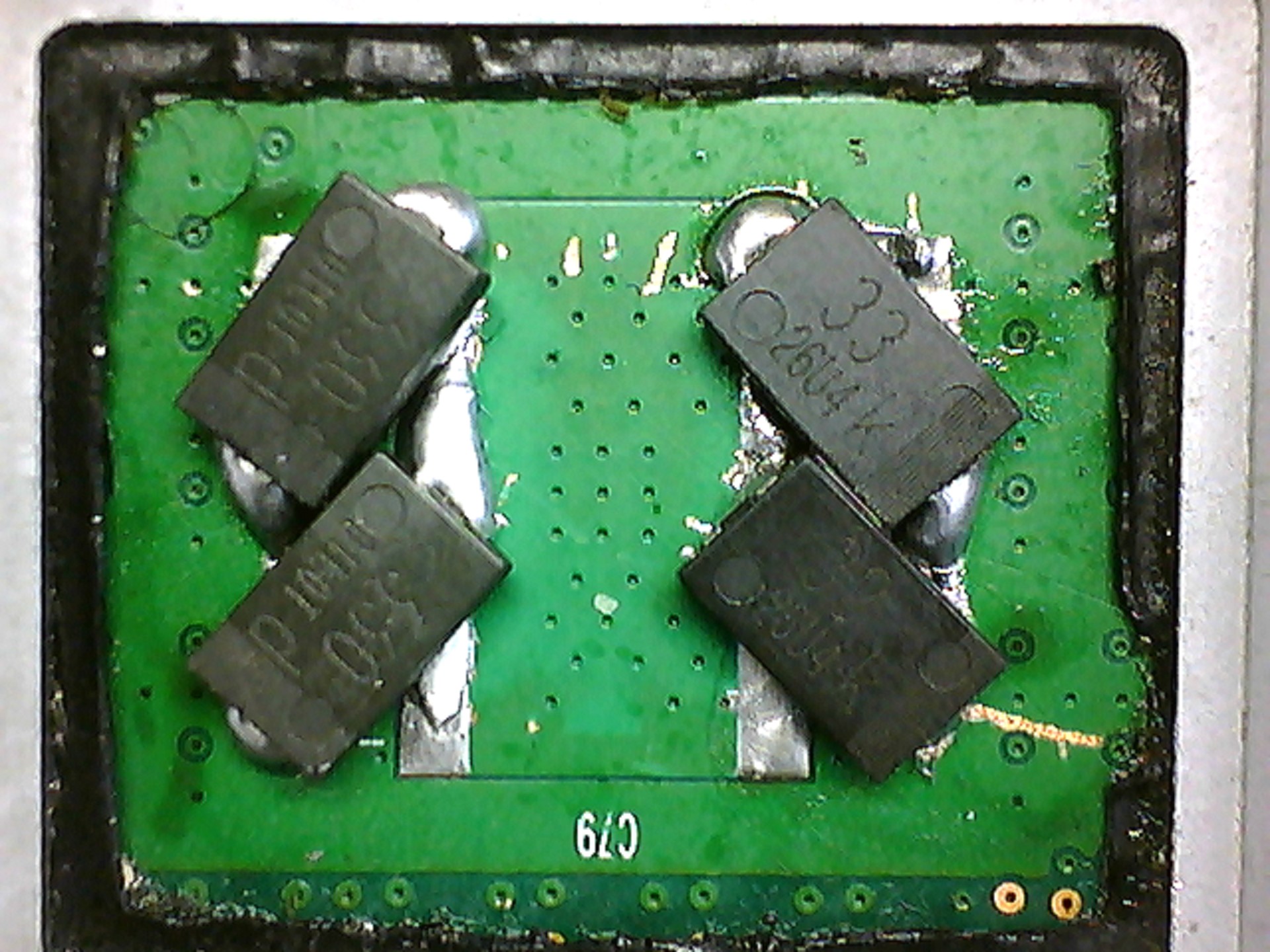

                  first i tried with 16 caps, from another mobo's from the same place under the cpu socket. but it didnt work. then i desoldered 2 ea 330 , and 2 ea 33(i didnt check from smd book but i think there're same) caps. and it works great now.
                  i attached the pics i took. hope it helps.

                        Spidey why did you place 2x 330 and 2x33 ?
                        the lowest values for tokin is 900.

                            Re: is it a faulty nec/tocin ?
                            at that time i didnt have any other.
