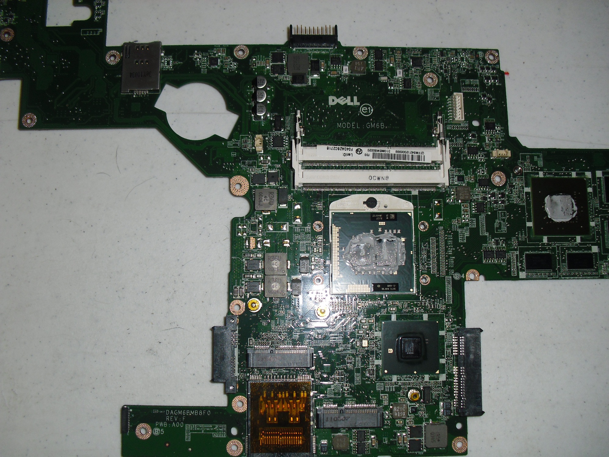

    Dell XPS L501X Power Short/Issues
    XPS L501X, when you plug the power adapter in it immediately shuts the light off on the ac adapter. Computer won't power on at all, can't test with battery due to being dead.
    Was working fine then one day just wouldn't come on. Any ideas where to look on the mo-bo for the short?

    Take out CPU, see if the short is still there on the main bus. (use a DMM to test the resistance)
    Also, take out the battery and see if there is still a short.
    Pictures would help us help you greatly!

        Pulled battery, cmos battery, and cpu and still cutting the light off on the power adapter as soon as i plug it in. Used 3 different adapters as well same result with all.
        Don't know if it matters but the cmos battery was shorted out, no resistance between + / - at all so replaced with new one.

          I have solved the same problem with dell laptops, this is what u do, put the cpu on the mobo and use a digital multimeter to test if there is short on the 10uF ceramic caps after that remove the cpu again and check if there is still short on them and get back to me

            Still have the short with and without cpu in on the caps.

              okay then it is just one of the caps that is gone bad, u need to get a picture of your board and i will show u where exactly to look, but u can start by removing all the 10uF ceramic caps, untill you can read any short again, but do not remove all of them at a time, do it one after the other and keep testing whiles your are removing, also put the ones you remove back before removing the next one

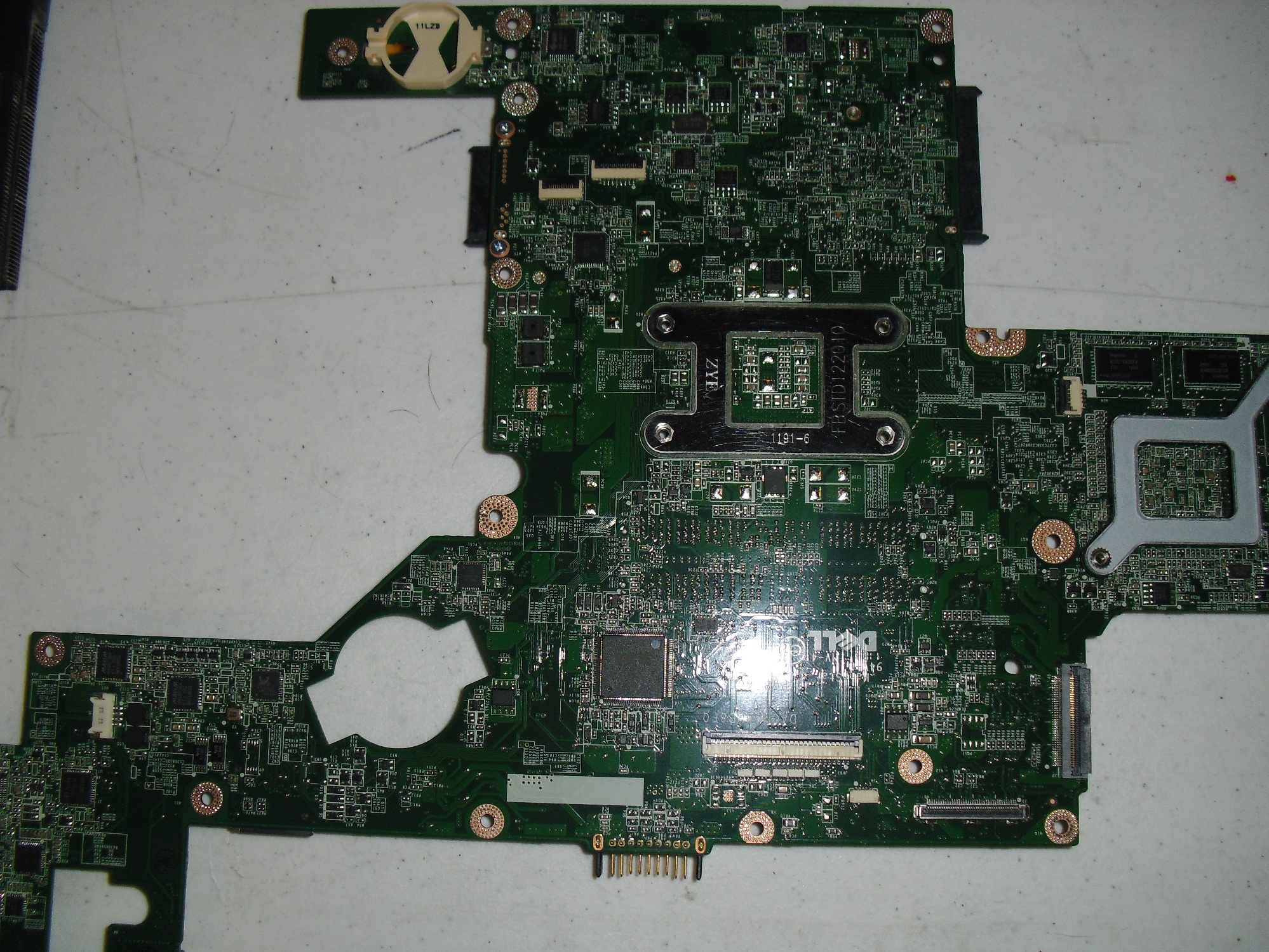

                Sorry let me rephrase that, i didn't find a short on the caps but am kinda new to working with laptops, more use to tvs and large capacitors. If I upload a pic can you help me out, really need to try and fix cause even ebay wants $200 for a used board.

                  Upload pics of the board and lets see.........

                      you should check all the places i have marked red, those are 10uF ceramic caps, check them all for short, put your multimeter in diode test mode for this.

                          I changed 5 capacitors, it worked, the system has started but working only on battery.
                          system won't work on dc power and it is not charging the battery,
                          what could be the problem? charged capacitors? or other piece to change?
