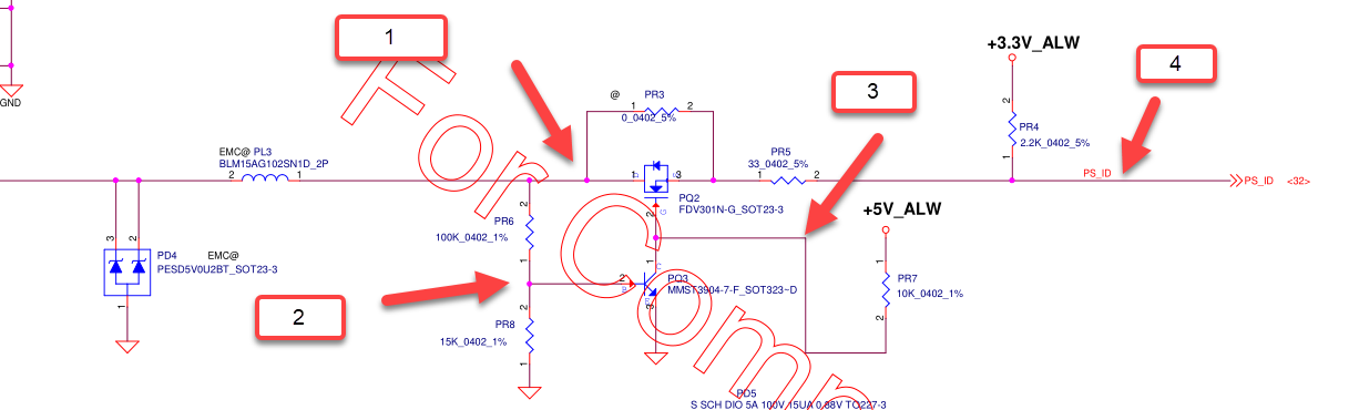

    Hi. See attached. Post the voltages for the requested areas.
    Dell uses a one-wire communication (Dallas / Maxim) to authenticate that the adapter is genuine so the ID communication must exist.
    https://hackaday.com/2014/03/03/hack...dentification/

      Thanks for the response and information! Here are the voltages those areas:
      1: 3.4 - 3.5 V
      2: 0.44 V
      3: 5 V
      4: 3.4
