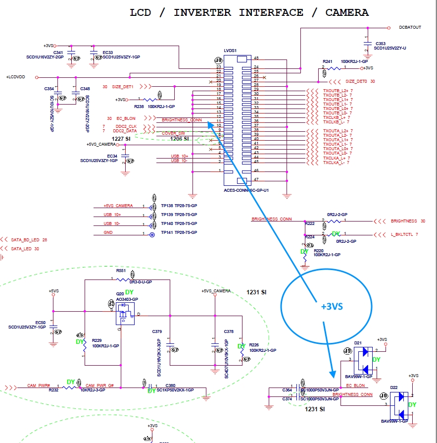

    Hi, I have problem with the screen backlight, tryed to change screen cable and inverters and still no backlight. Please help!!!

    CCFL tube in the screen is gone. Replace the panel.

          Check if the backlight voltage is present, pay attention to don't short the circuit.

            Hi ,
            i've the same problem with an laptop CQ70 .
            I tried to change LCD panel, Inverter, LVDS cable and the same problem no backlight.
            I tested if i have 3VS but no 3VS on LVDS and when i check the motherboard i seen the D21 and D22 are missing. On pad ( printed trace) of D21 and D22 on the motherboard i found 3VS but not on C364 and not on C374.
            I tried to jump on motherboard the lines of D21 and D22 each separately without any result.
