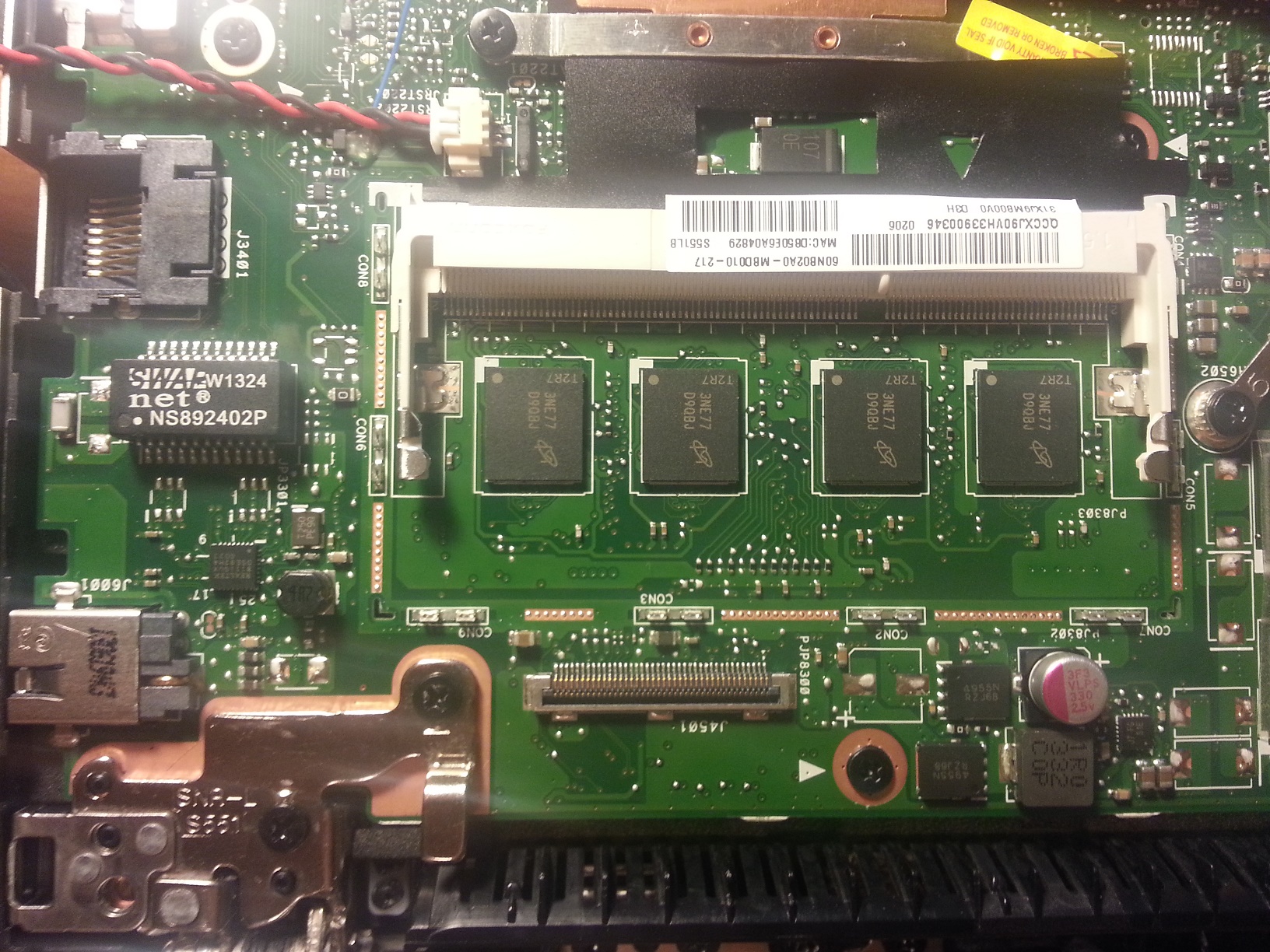

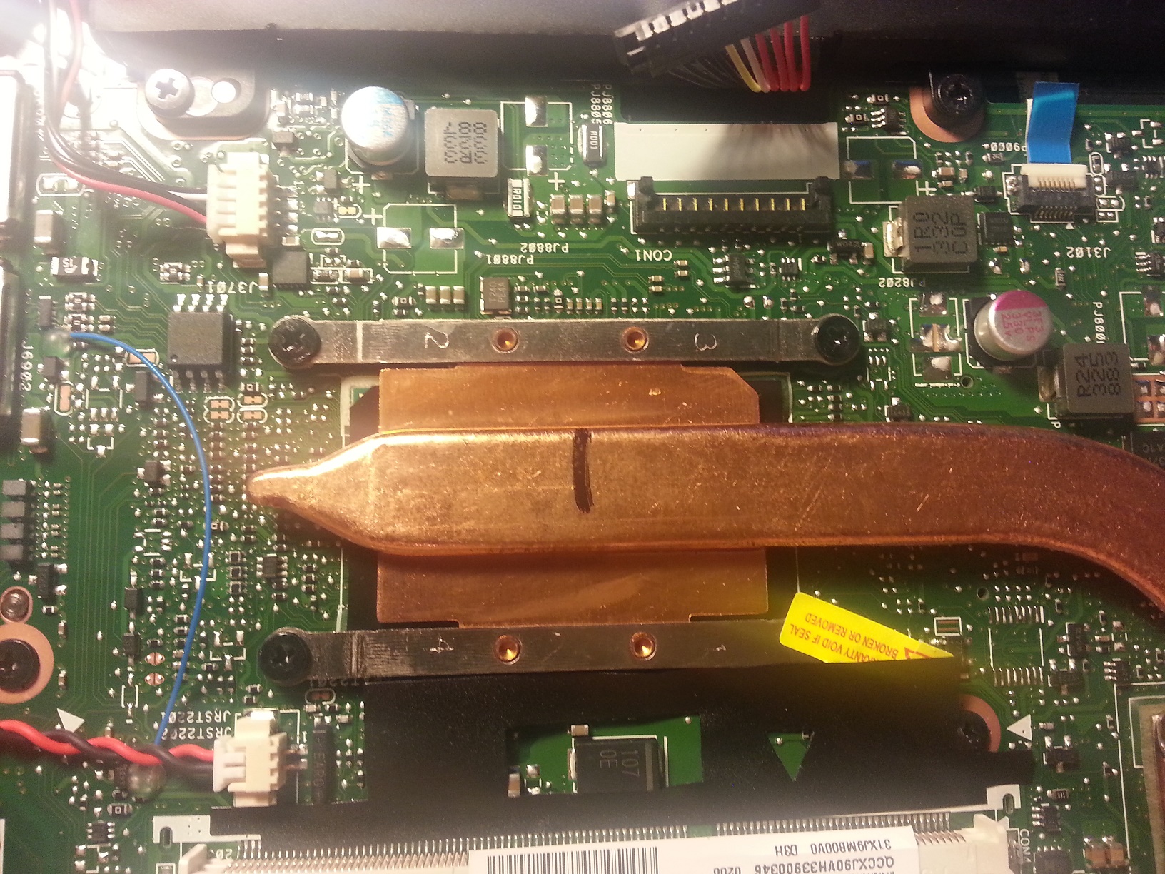

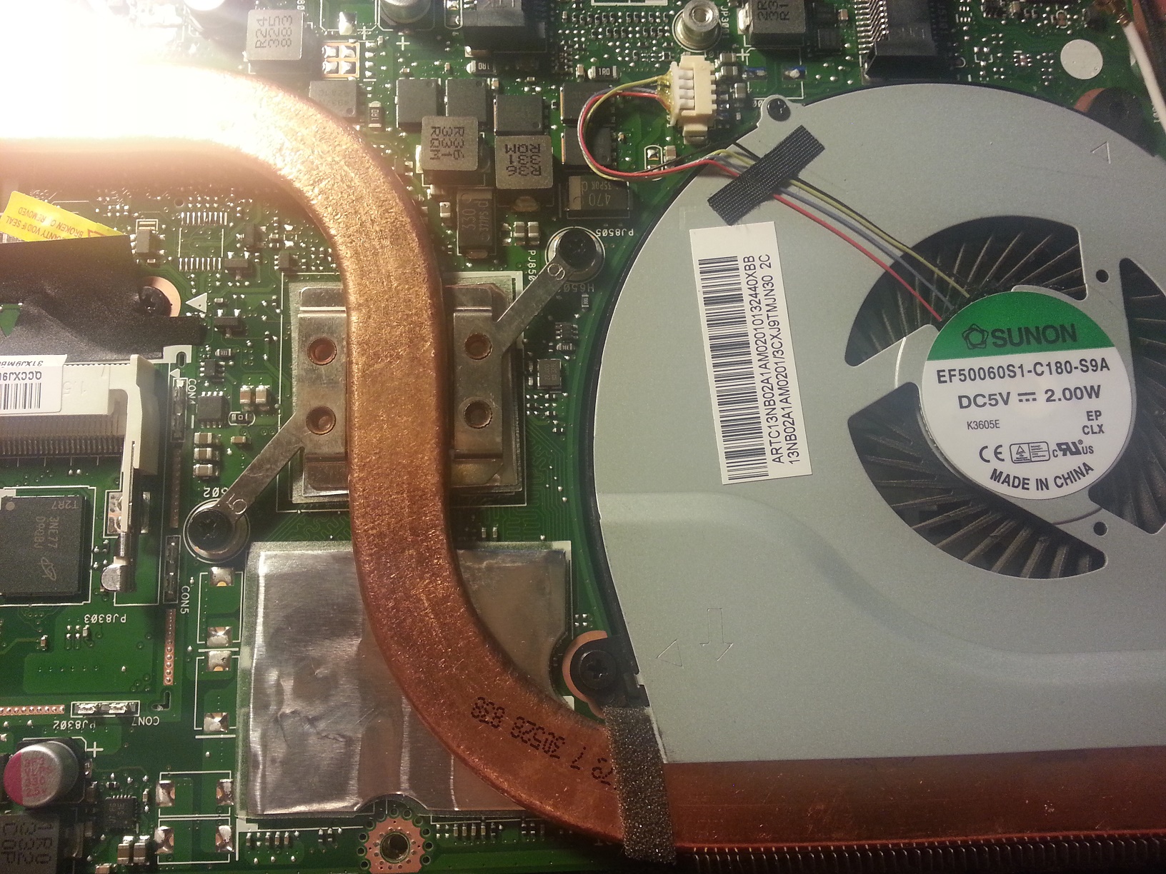

                Hello All,
                I am having the same issue as everyone else only on a different model. NO LED backlight on an Asus V551L laptop. I have picture just no backlight and the screen and cable have been tested on another identical unit and it works fine (picture, backlight, etc.) so it has to be something on this board. I have attached pictures of the board if you need any more, let me know. Any help that could point me in the right direction would be greatly appreciated. Thanks

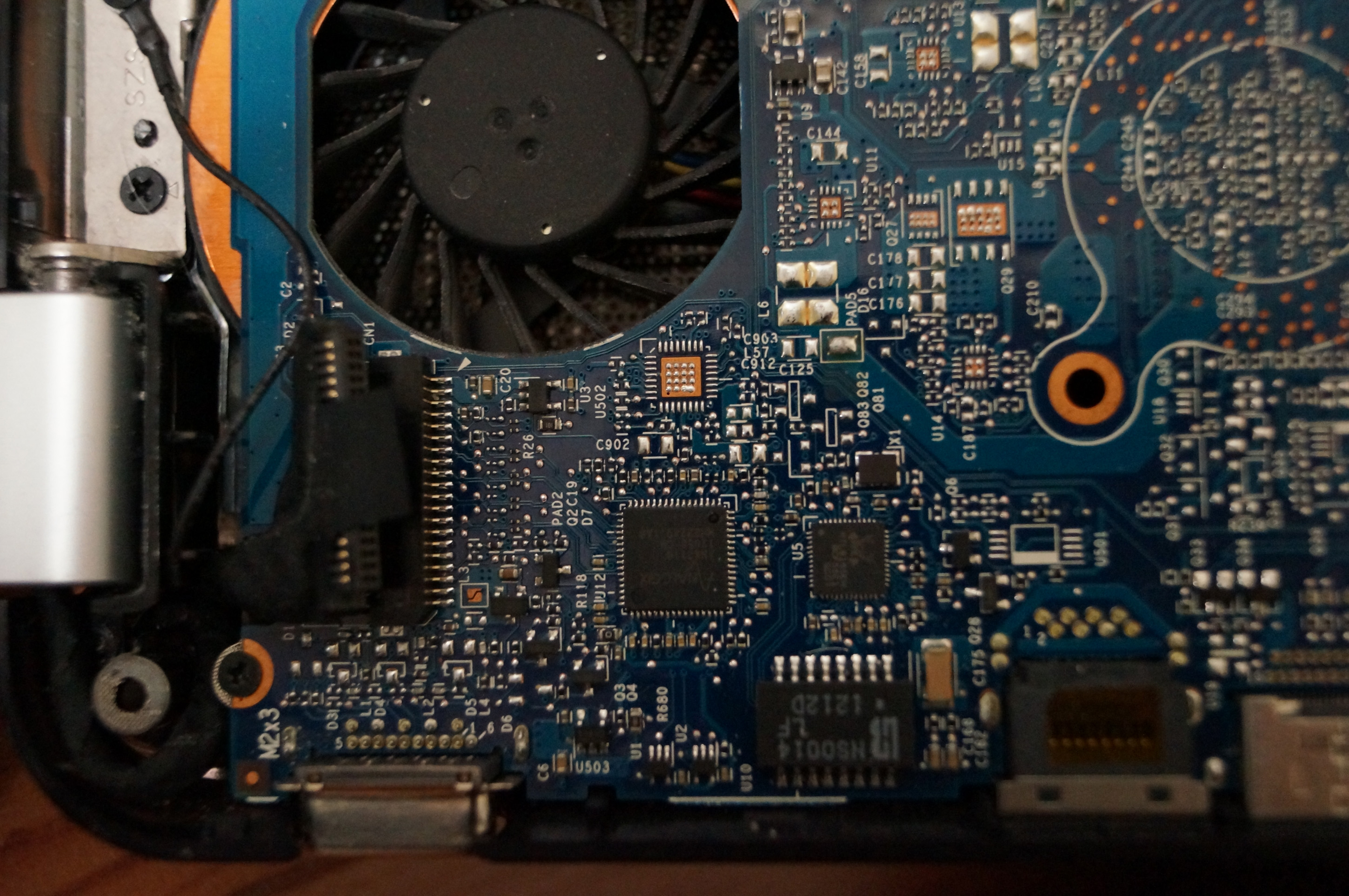

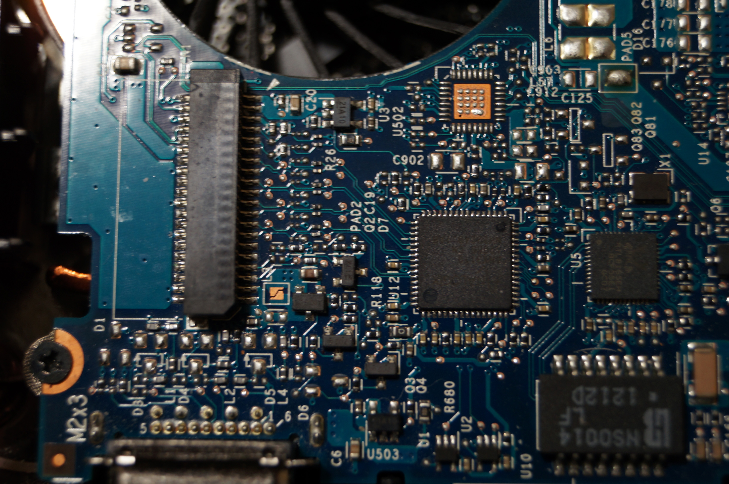

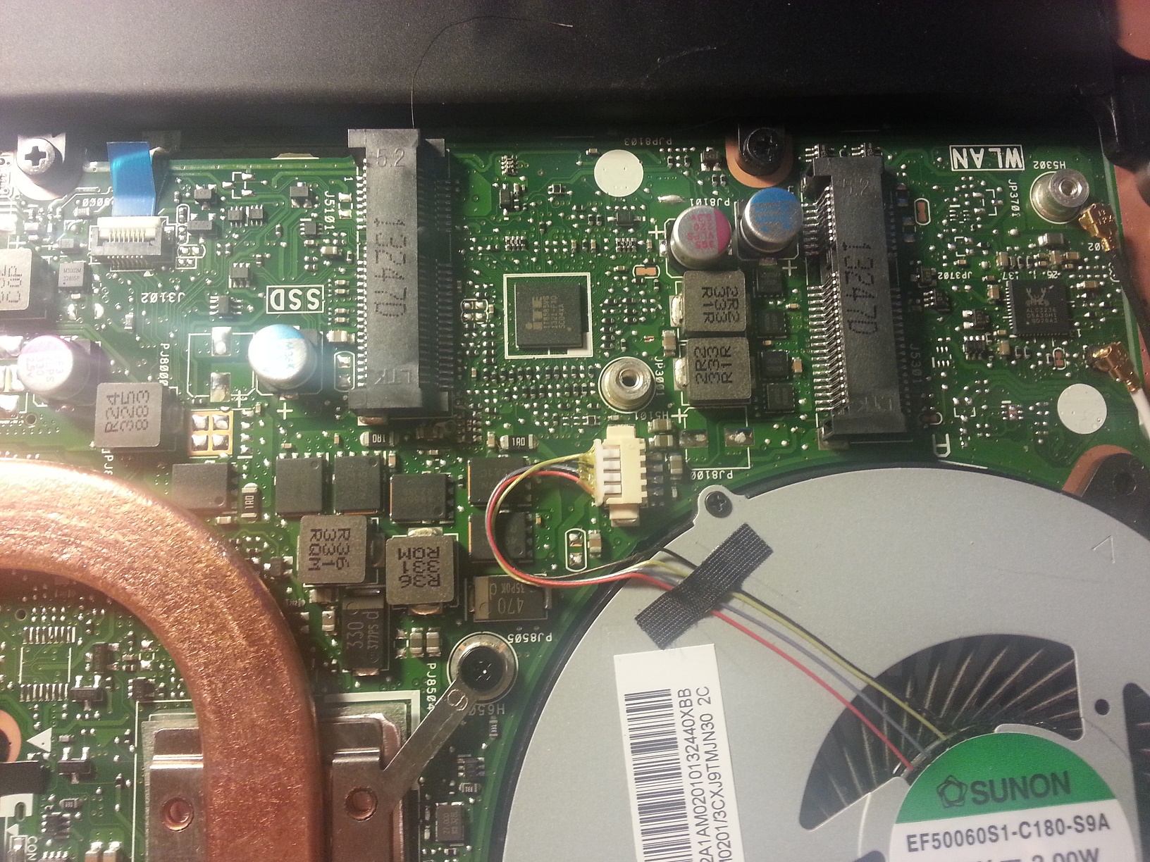

                  Hi guys, same problem here, different motherboard. It's a friend's computer, HP Pavilion G6-1D44CA, the screen was cracked and she asked me to fix it. Ordered a new screen, installed it, but lost the backlight in the process. I unplugged everything but I'm guessing the LED cable wasn't quite snug when I first tried it.
                  Hooked the old broken screen up, same thing, backlight gone. Put the new screen back on, and if you shine a bright light on it, everything is there. It's an LED so no separate inverter board.
                  Hooked it up to an external monitor via HDMI, works fine.
                  Everything points towards some kind of fuse or continuity error on the motherboard, but I can't figure out what exactly, as there are no fuses labelled. I tested continuity on a few little pieces but they all seem to work, but might have located something.
                  Found a similar thread on Tom's Hardware that had an almost identical motherboard and suggested where the issue might be but didn't really give a solution. I tested continuity on the part, it's a 3-prong resistor (I think?) with continuity from point A to B, but not B to C. Could this be the problem, and if so, can I just jump it? Thanks guys.

                    Please can you repost your pictures using manage attachments.
                    It is not a resistor do NOT try to bridge it.
                    • bray
                      • Jan 2015
                      • 5
                      #110
                      Re: Need help finding LED backlight fuse [PICS]
                      Sorry, wasn't sure how to work it. The thing marked "O" has continuity.
                      • selldoor
                        Slow Learner
                        • Dec 2010
                        • 7870
                        #111
                        You have not marked it but "thing" with a 0 on it is likely to be a resistor -zero rated.
                        The 3 legged component is a transistor can you read the number on it looks like 75 or 7S

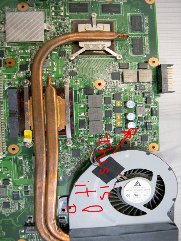

                          Sorry guys, Ive been very busy and didnt find time to post soon. A guy here asked me to post and mark the part that i bridget on the asus k53s that I repaired.

                            #113
                            Very hard to read but with contrast turned up looks like a 75

                              #114
                              It COULD be one of these - try cleaning it gently with IPA.
                              Why do you think it is bad?

                                #115
                                Literally no other reason than that picture posted above from TH forum. I can't see any fuses near the connector and don't have a mobo schematic so I'm completely at a loss with how to find the problem. I just looked at it again under a brighter light and managed to make out the label, A9BV with 1S sideways. No luck after wiping with IPA.

                                  Thats a few strides from "75" I have had a quick look but cant find it. Perhaps someone will chime in who knows this board, or can tell what it is from the circuit around it.
                                  Is it a very old post on the other forum - perhaps join and pm the writer.
                                    Didn't work for me, but I never soldered a jumper before so maybe I didn't succeed. I will try to ask a friend if he can help me.
                                    You are supposed to solder on that side you had on the picture?

                                        I have the same issue with Asus V551L. Does anyone here have any knowledge or experience with this model? I noticed Wyndon (appologies if i spelled that name wrong, cant remember the name exactly,lol) already posted pic of this laptop asking the same question. In the right lighting I can see the screen has an image just no light. I saw a video before of a narrow board in the bezel of the screen causing this. but that was not a touchscreen, so i believe this would be different.

                                          Thanks for the picture. I put a dab of solder on the thing marked with a 0 in the picture and it fixed mine. It had resistance when tested. A little tip for everybody that I learned the hard way, REMOVE battery when replacing LCD!
