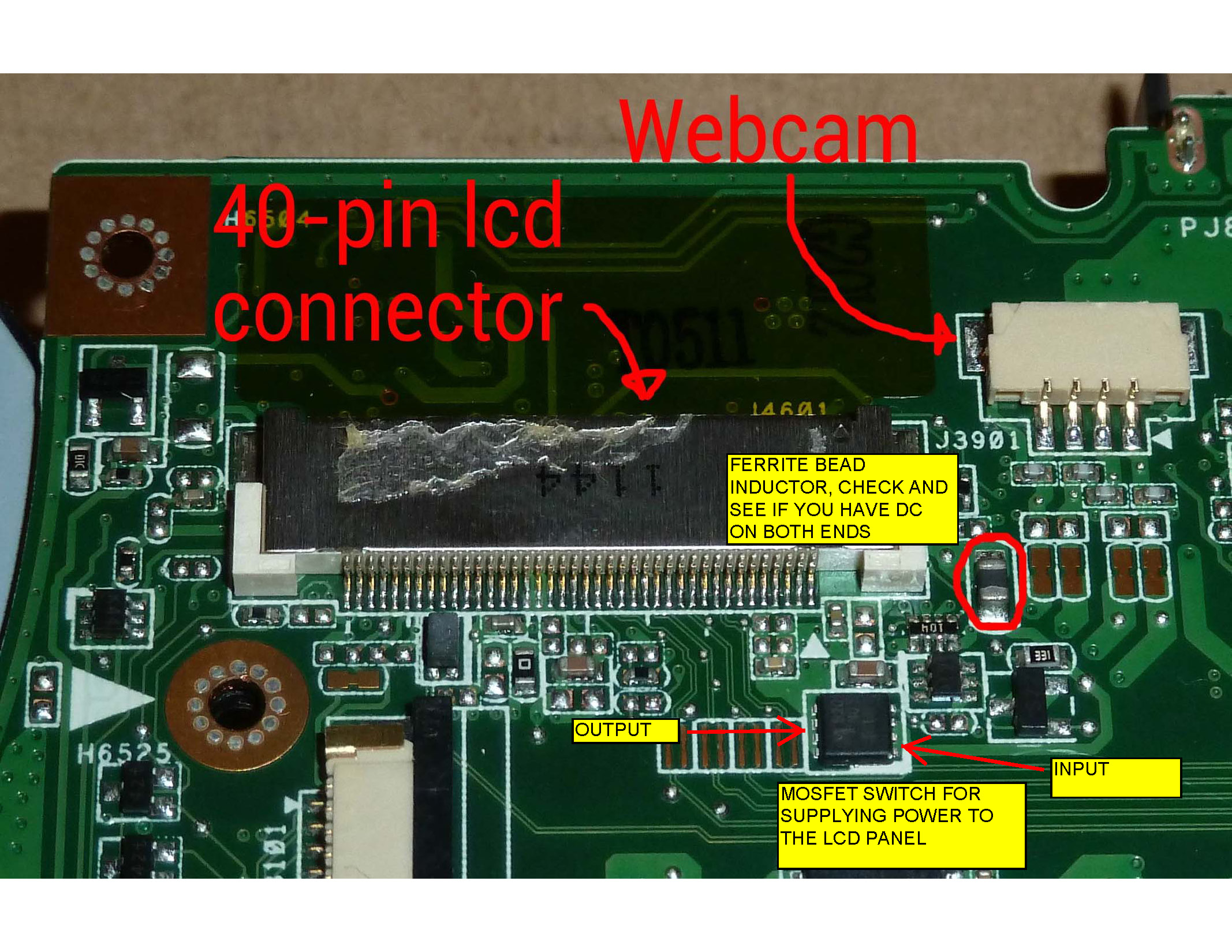

    I have an asus k53 series laptop. I cracked the lcd so I ordered a replacement from laptopscreens.com HOWEVER it was not a direct replacement. I found a slightly different asus laptop with the same screen specs (size, led, 40 pin, connector location) except for a 1080p resolution :P. After installing the screen and turning on the computer it looked like the connector wasn't on right (weird tint, etc). So I took the laptop apart again but this time I decided to test the screen before reassembly so to not have to tear it down again if it wasn't right. When I turned the computer on it still wasn't right (different tint this time) so I jiggled the connector GENTLY and after about 10 seconds of this the backlight died. Here is what I have done so far to diagnose the issue:
    1. Tried old screen, backlight not working (it was working before I took it out) leading me to think it was a problem with the cable or the motherboard
    2. Made sure it wasn't an issue with the lid switch. It works correctly.
    3. Confirmed both old and new screens working, I can see my desktop when using a flashlight. Just no back light. Also made sure windows was reading the new screen at its native rez.. all good.
    4. Tried to find a blown fuse on the motherboard around where the lcd ribbon connects. No luck, only found one fuse in the area and it passed continuity.
    5. found 4 other fuses in different areas of the board and all working.
    6. found what I think is a fuse that wont pass continuity located near the DC jack.

    Here is the connector area
    same area
    Closer. The component circled in red passed continuity and and no resistance so I'm assuming this is a fuse but is not blown.
    opposite side in the same area, looks like its mainly the transformer area for the cpu.
    Full board shots:
    Here is what didn't pass continuity, I forget what the ohms were.
    Everything is so damn small and not labeled!!

    Please see the pictures for test points. Black probe of the meter to the metal part of the chassis.

      Thanks for the reply. I just want to confirm the pins I'm supposed to test. 1/2 on the input and 6/7 on the output? What should I be testing for?
        Re: Need help finding LED backlight fuse [PICS]
        Yes.
          Am I testing with the computer on?
            Take the reading when the computer is off and when the computer is on. Do you still have the old LCD panel, you will need to have it hook up as well since the mother board may detect the present of the LCD panel or not. We just want to confirm that the MOSFET is turn on and send the voltage to the panel.

              Hey bubm, I got 3.384v on both the input/output of the mosfet and the both sides of the inductor. Any ideas?
                I expect 5V, but that means at least the panel is getting the power to it. Did you download the original panel spec and see what voltage it needs to run?

                    There's nothing on the led power input on pins 38,39,40. 36 (led enable input) registers 0.56v
                      OK, so the MOSFET that we tested is for supplying the power for the T-CON LCD panel. Then we need to trace out pin 39~40 to find out where they go to, the typical voltage for LEDs are 12VDC, so there must be a switching power supply somewhere on the board, also the LED Enable should be between 2.5~5.5V, so it is not being able right now.
                      I think you will need to find the service manual for this mother board to repair down to component level.

                        I've scoured the net trying to find the schematic for the board, no luck. I was hoping for something the same quality as we found for the screen.. such a big help.
                        I'm assuming the issue is likely origination from this location (red line indicates position of 40-pin connector)

                          Is there anything that you think I should test? One way to find out where those 38~40 go to is to put the meter in the lowest scale, then put one probe on the pin 40 and just poke around the board close to that area and look for 0 Ohm reading, it has to be connected to some kind of switching power supply on the board. You will do this test with the power and batteries removed.
                          Is it safe to poke around for voltage? can it cause damage? Just have to be careful not to slip the probes!
                          When testing for voltage on pins 38-40 we used the same ground as before.. should we have used the led ground pin that's located on the connector? The connector gorunds are tied to the chassis ground and the ground plain of the mother board. so we are OK on that testing.
                          Is the component circled in red a fuse? The picture is too small for me to see clearly.
