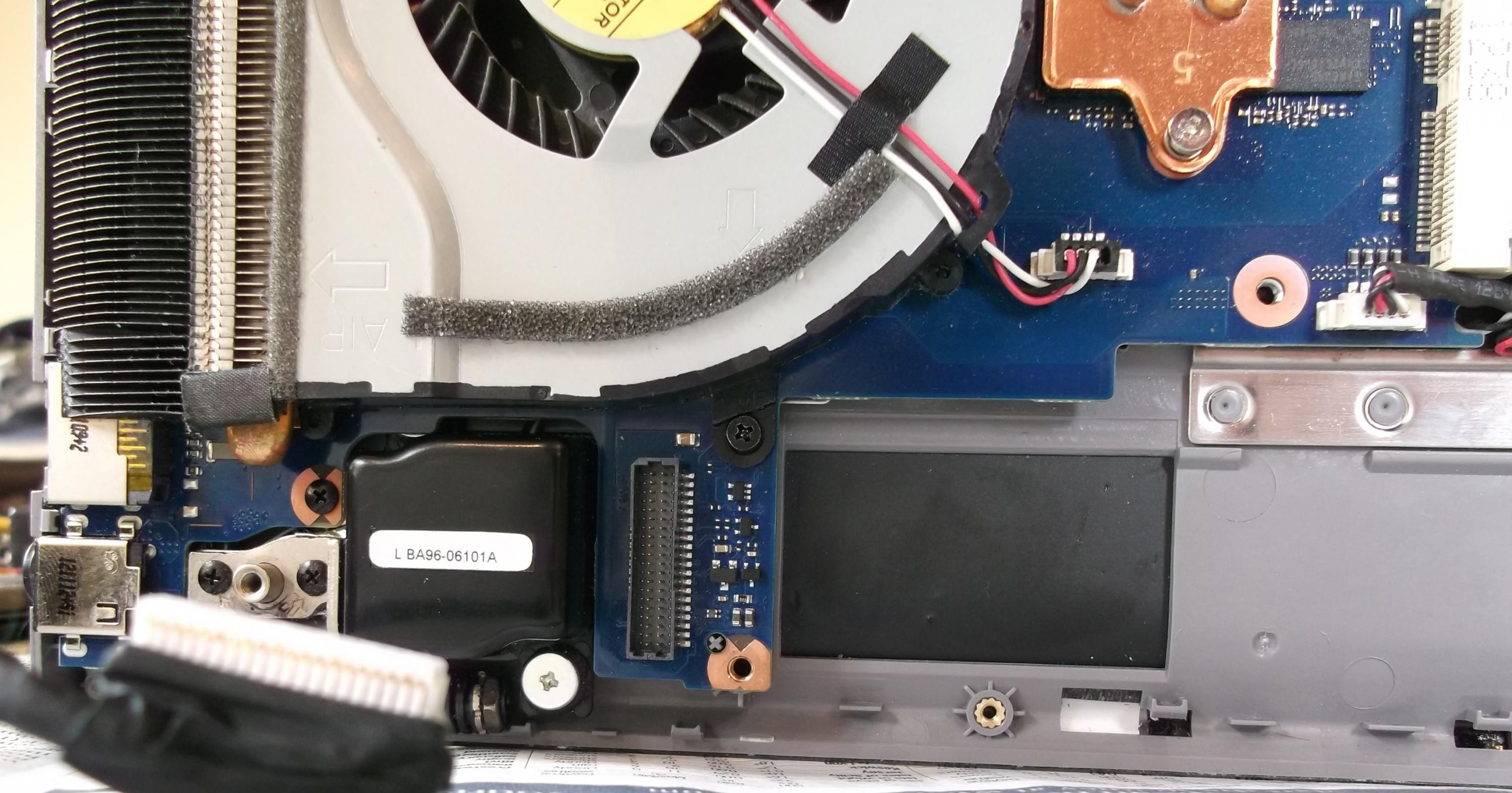

              #86
              Re: Need help finding LED backlight fuse [PICS]
              I have the same problem with a Samsung NP550P7C laptop.
              No backlight on the screen but I can see the image on the screen if I shine a light onto it.
              I rather stupidly removed the screen cable from the motherboard whilst the batter was connected!
              Does anyone have any experience of this laptop?
              Any help greatly appreciated.
              Jeff
              • Telephonewire
                • Apr 2014
                • 15
                • England
                #87
                Here is a picture of my motherboard and a close up of the connector.
                Any help gratefully received!
                Jeffrey

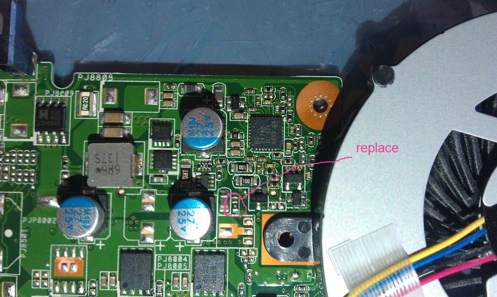

                            #93
                            Hello guys, and costin_yo, especially...
                            I have today resolved issue i have found on my K53E, that is closely relative to K53SV costin is describing... using info found here, i was able to fix it... It is second hand laptop i was intending to fix and sell for profit, so i had no idea how nicely (or badly) was the lappy treated. The fact is that once i've reassembled it (as the mobo was not the part of it), the known-working motherboard suddenly had issue with backlight... there were many causes of this problem, the LVDS cable to the screen was faulty (as even data channel to the screen was corrupted). So i've gotten my hands to replacement, which fixed screen, but didn't backlight... So i've decided to do some continuity research... and i've noticed burnt smd jumper (see photos, it's not my photo but it depicts same component) - it was replaced by solder bridge and the screen was okay now, until i've reassembled the laptop... so i've took it apart again and the screen was working again (damned gremlins...) - after reassembling and testing part by part, i've found the issue - it was short cirtuit on power button ribbon cable, caused by peeled contacts (see in photo - sorry for quality, my phone hates microscope). So i've bent them back, carefully put the ribbon to the connector and reassembled - works like charm!
                            TL;DR:
                            1) Check voltages on the MOSFET
                            2) Check SMD jumper marked on photo below
                            3) Check your power button ribbon, boot computer without it - it might be faulty (How to boot? Shorting middle pins (3 and 4) on the connector briefly using tweezers worked for me - at your own risk. Might also try powering up and pulling it out immediately...)
                            • costin_yo
                              • Sep 2014
                              • 6
                              • Romania
                              #94
                              Woow, first of all thank you very much for the quick reply...
                              I want to tell you that I tried to search for a broken fuse on the back of the board but I cannot see any, I cannot see any fuse that looks like yours in that picture so I can change it.(I noted one of them that seems to be like urs but it seems that its working, it is in the last pic that I added)
                              I made some pictures to a big resolution and please give me ideas of which fuse can be broken.....
                              I tried to test them in that area and it seems that all of them works...
                              I dont have any problem with my power on cable and I tried to power it shorting the 3 and 4 pins and the same, no backlight....I really dont know what to do...
                              I added some good resolution pics and please make some notes of which part can be broken on it...thank you very much....
                              Please help me guys....

                                #95
                                I fixed it too...you gave me the idea to check on that area with the mobo powered. I found the resistance or whatever is that, that is next to the indicated jumper. The brown thing. It was receiving 19volts but giving out only 6. I jumped it with some solder and it fixed the backlight.(I tested it first with something else for few miliseconds to see if its actually from there) I hope nothing goes wrong on the long term situation.
                                Does anyone know what is that part exactly? Where I can find it? (not from other used mobos, I want it new)
                                What can happend on long term situations?
                                Thank you very much to everyone especially to p4r4d0x for giving me the hint to look in that area...!!!

                                  #96
                                  EDIT: this is not your case, as i mistakenly thought you replaced capacitor and not inductor, see my next post...
                                  Grey-Yellow-brown components are capacitors (darker colour means higher capacity), considering their purpose, they are not meant to pass continuity (unlike inductors or resistors) - and they will allways pass it only briefly (when they are charging) - considering you havr shorted those pins and it works, you either replaced faulty power rail with working power rail (or with same rail, ommiting part of circuit). This might cause issues, i.e. Further damage to the board in long term use, overload of the said power rail when the demand from device that uses it increases, etc.
                                  In your situation, i would try to measure current trough the solder bridge with disconnected screen, and if it doesn't exceeds big deal (less than 200 mA or something - really a wild guess) it might be fine to let it run like this...
                                  You might also consider breaking up the circuit somewhere on the net, in attempt to disconnect faulty power source, as there was clear voltage difference (19 volts minus 6 is still a lot) and it might consume lots of power, which is waste and might shorten battery duration and/or further damage your board. Assuming you are using same net as ground fo both voltages. Fiddle with it a bit, you can't do irreversible damage if you just desolder something and solder it back in case it "wasn't it".
                                  Sorry for my poor English, as I rarely talk about electronics in English... And also sorry if this doesn't make much sense to you, i'm on my phone at work, and can't rephrase it atm, will look here in the evening, so let me know if you need to clarify something, i prefer drawing while talking as i'm not very good at explaining, but that aint possible over internet
