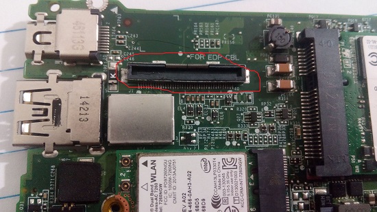

                                #135
                                Re: Need help finding LED backlight fuse [PICS]
                                Hello, i replaced the broken screen of my UX303U, but after i turned it on there was no backlight at all, i tried using the broken screen but it didnt have backlight either. After looking around the internet i found this forum and checked the motherboard of my laptop. I found that a fuse located just below the screen flex had exploded. I'm attaching the only clear picture i've found of that motherboard showing the fuse, do you guys think it can be fixed?
                                Thank you in advance.

                                  #136
                                  Yes it can be fixed. Clean up the area first. It's an inductor not a fuse that is missing/exploded. Once of a similar size can be used from another motherboard. It's a common failure if the screen is replaced without removing the battery first.
                                  • Peztoa
                                    • 2
                                    • Perú
