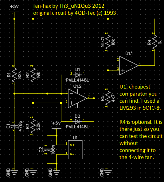

        @ momaka: The circuit i am designing is for 4-wire fans. Older laptops are likely to have 3-wire fans, for which you can use a very simple circuit with one transistor, one resistor and one NTC thermistor, ala the fan controller you see in cheap power supplies.

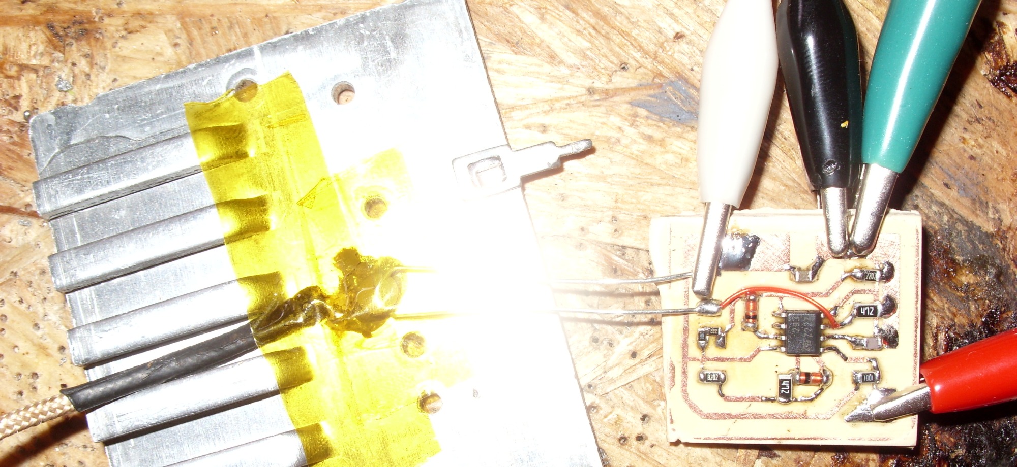

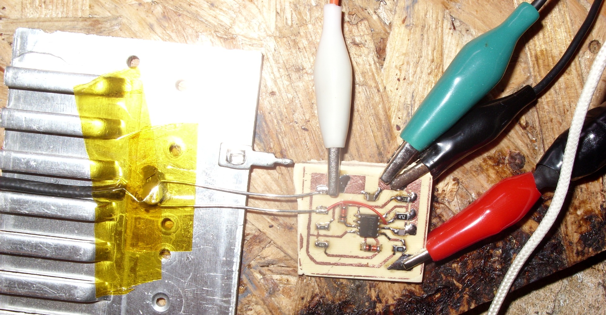

        The guy with the tx1000 came Monday but i didn't have time to do the board by then, so i just reflowed it and cut the PWM wire on the fan (which made it run at 100% because there's an internal pullup resistor). He's coming back on Friday to get the controller board fitted. And there will likely be some extra holes drilled in the case, as the thermal design of that tablet is just atrocious. Even with the fan blaring at full throttle, load temperatures were in the high 60s. That's better than having the fan only reach full speed at 85C, but if that thing is to last any reasonable amount of time, something needs to be done about it.

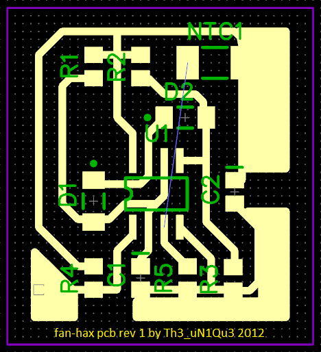

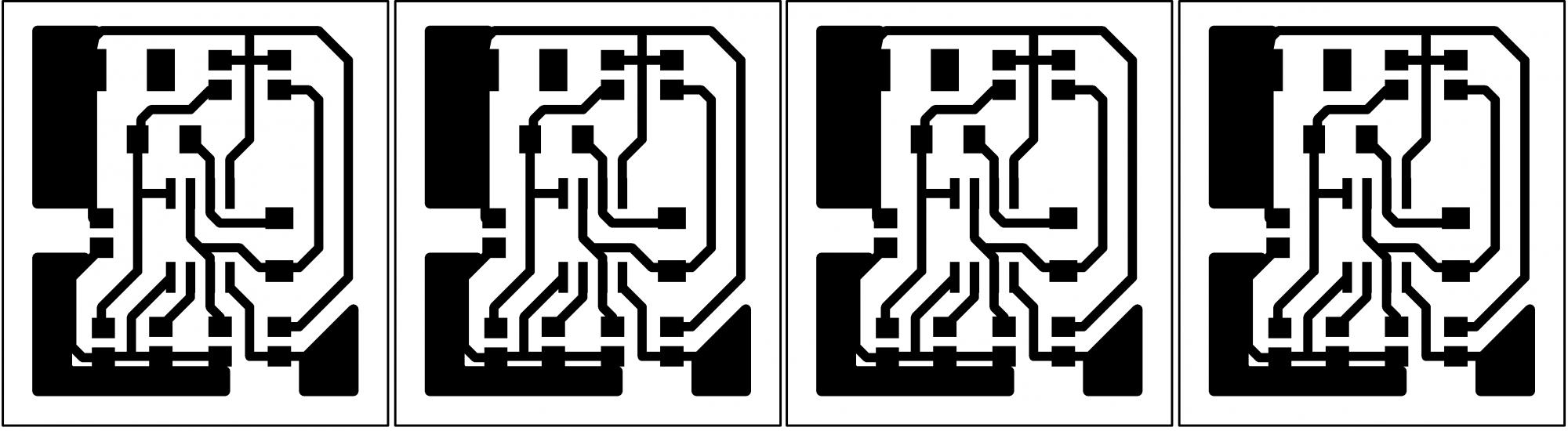

        Anyway, here's a sample of Fan-Hax rev. 1. I realized the MC34063 wouldn't work, as it is variable-frequency, and the fan in this tablet adhered to the intel standard of 25kHz (even tho it's an AMD based machine). I believe most of them use this fixed frequency standard. So i used another circuit which i've built before for the same application, only this time i made it smaller. It's the 2nd circuit on this page: http://www.4qdtec.com/pwmmod.html only with slightly different values.
        It uses all jellybean parts, and the PCB is designed to be easily hand soldered. In fact, i could have made it smaller and still be easy to build, but i thought it's enough. You can make 4 of them on a 100mm wide PCB. It's got one SOIC-8 and all passives are in 0805. Well, in my case one resistor is 0603 because they didn't have 0805 in stock but that's a different matter. There's one ugly jumper wire but i couldn't be bothered to shuffle the component placements again. For now, one thermistor input only, as that's all the tx1000's gonna need. PCB for 2 inputs soon to follow.

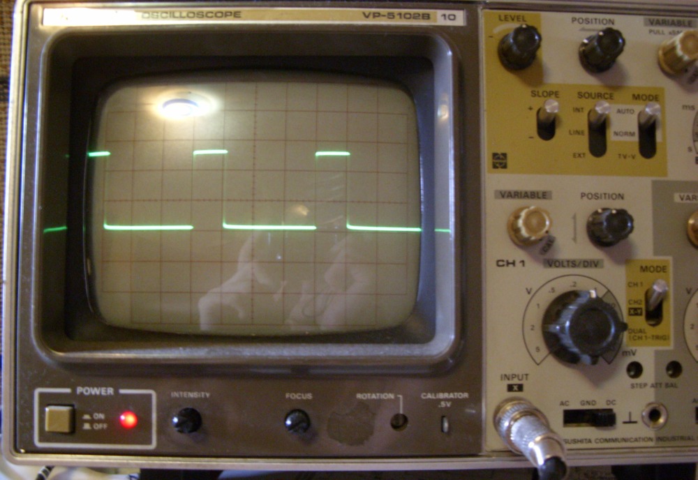

        I have tested this board i just built and it read as follows:
        PWM frequency: 22.8kHz. Intel says 21-28 is okay, so this oughta do.
        Duty cycle: 40% to 100%, from 30 to 55C. I would have liked a lower limit of say 10%, but since the laptops this is designed to fit in have poor cooling anyway, it's likely that the fan would never go this low even if it did have the range. Either way, at 25C it's likely around 30% - but it's too hot in here to be able to test that.

          I wasn't entirely happy with 40% minimum, so i found a way to get a wider duty cycle variation for the same temperature range. Since what it did is it "bent" the ramp waveform, it sorta compensated for the nonlinear characteristic of the thermistor as well, so i now have a pretty nice PWM fan controller, even if i say so myself.
          Minimum should be around 20% at 25C, lowest i could measure right now is at 29C, where the duty cycle sits just a smidge over 25%. It reaches 50% at 41C, and it's at full blast at 53C. Frequency sits now at 24.96kHz, it doesn't get much closer than this. We'll see how it fares tomorrow.

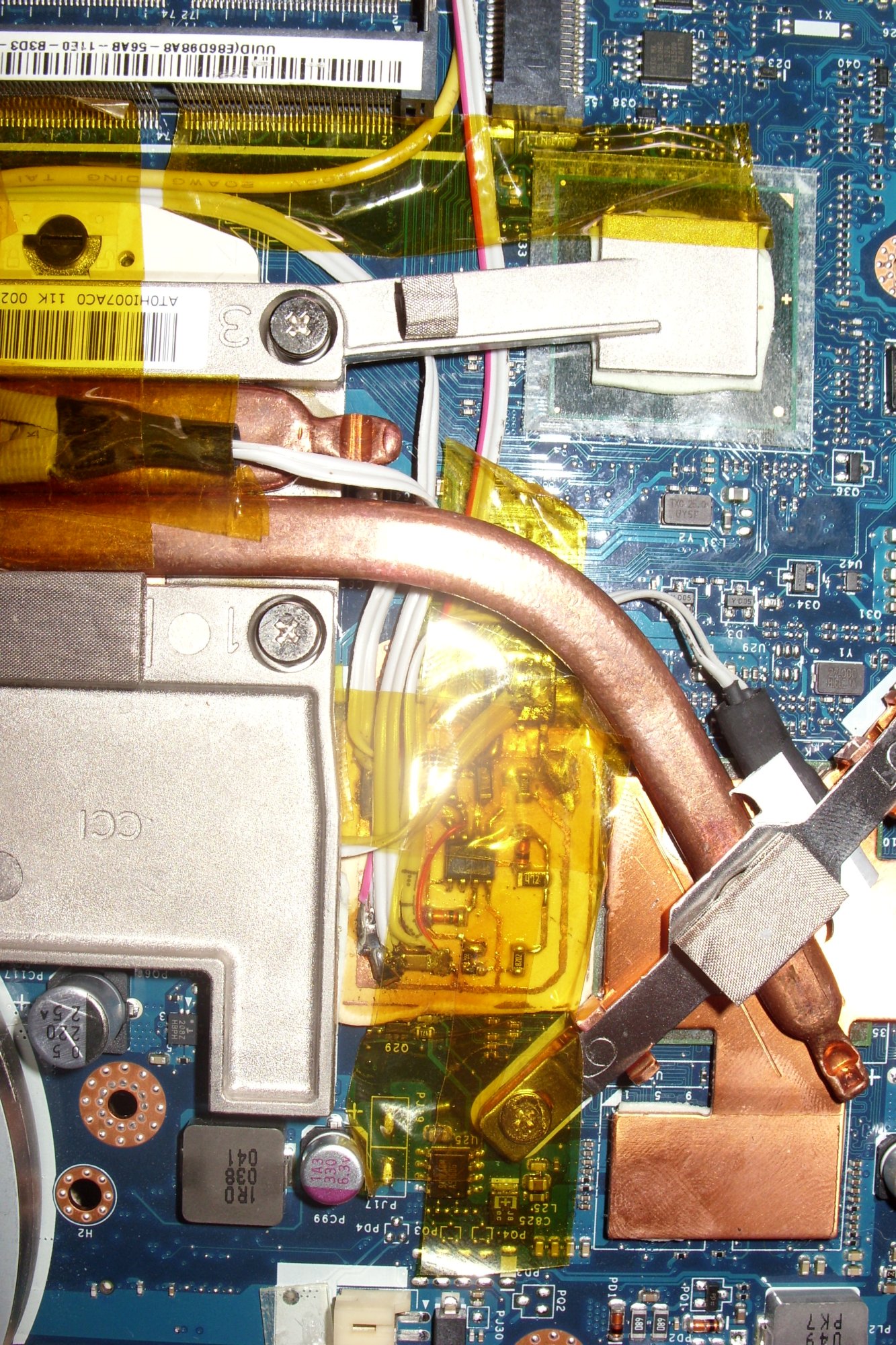

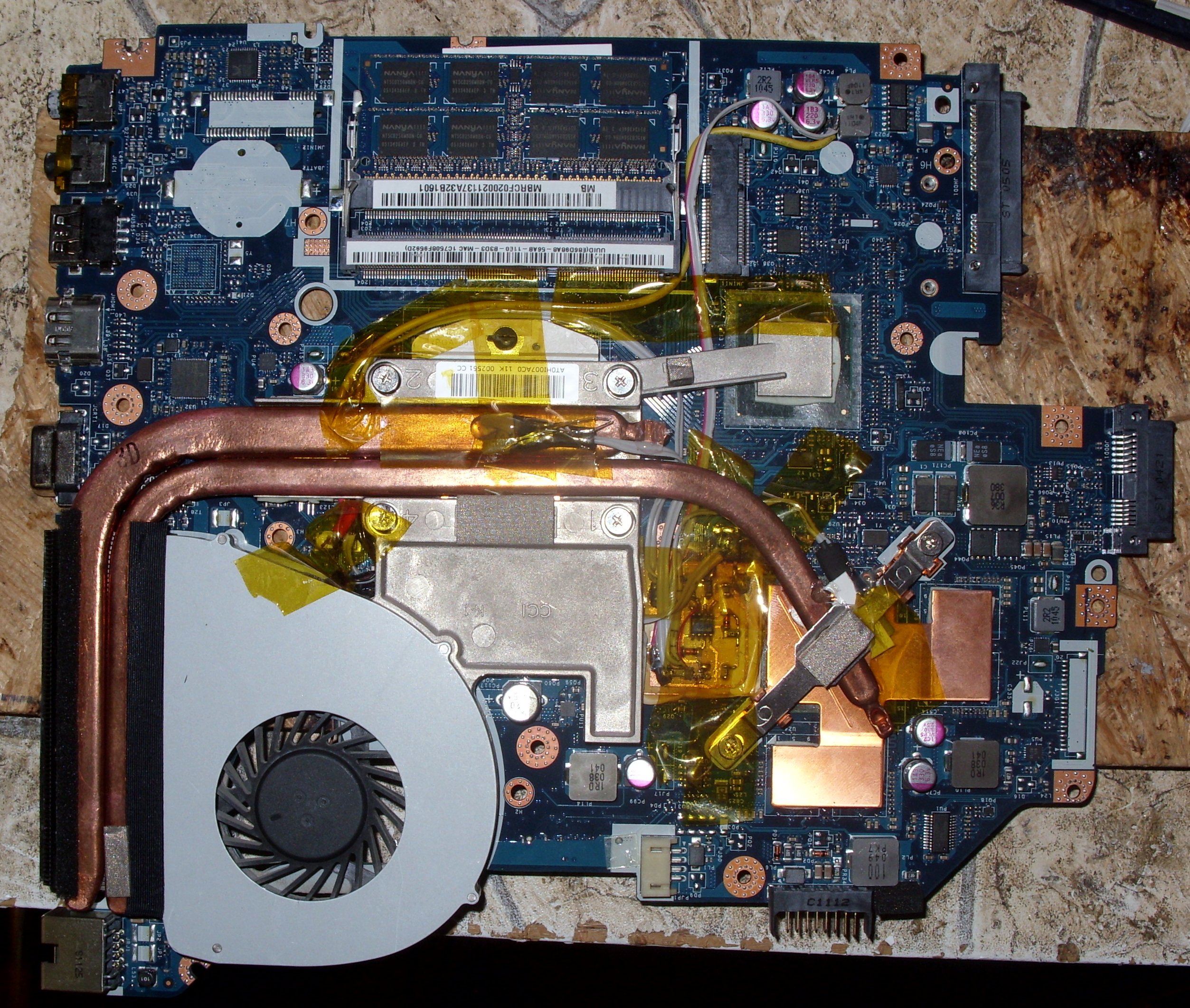

            The first Fan-Hax board was installed today.
            Not in the tx1000 as that guy has yet to show up again, but in an Acer. I forgot the model name, will update... I was too busy soldering and taping stuff to remember that. All i remember right now is it had an i7 with turbo boost and a GT500 series GPU. The thing would reach 105C when gaming and shut down, and the fan never even got close to 100%... Owner told me the only time he really heard the fan was when flashing the BIOS. To keep it from reaching shutdown temperature he had to disable turbo boost on the CPU and underclock the GPU. Good job Acer.
            I hadn't bothered updating the boards yet, so i just hooked both thermistors up in parallel, and adjusted the voltage divider resistor to suit. I know that this basically means that when only one device is hot the fan will run based on the average of the two temperatures and not the maximum, but i was sure that in a laptop with a single fan the temps will average themselves out, and they do. Upon inspecting the thing i noticed that the fan was 3-wire, so it was voltage controlled not PWM. I had to do some extra hax to the board, namely adding a MOSFET and lowering the PWM frequency from 25kHz to somewhere around 10Hz, didn't measure it exactly. Anyway, the PWM clicking is barely audible and that only if you put your ear close to the exhaust, and once the fan ramps up you can't hear it at all.
            Result: Success. With everything maxed out, the CPU runs in the high 80s, and the GPU just a smidge over 90. That's still high, but at least it doesn't turn off anymore and can be used to its full potential. In games the temperatures are going to be lower. So, the fan can do it, they just didn't bother to configure it properly...
            Another nice touch, that i realized only after we put the thing back together: I wired the power to the controller to the USB 5v supply, which means that even after the laptop is turned off, the fan will continue to run until the heatsink has cooled. It does not do this on battery, as the USB power is cut to avoid a forgotten peripheral from draining the battery.
            Here some pics. Before you ask: Yes i did move the wires away to clear that screw hole before i put the board back in.

                  Are you sure it will not start smelling like burnt cables once that heatpipe goes hot?
                  • Th3_uN1Qu3
                    Believe in
                    • Jul 2010
                    • 6031
                    • Romania
                    Re: Fan-Hax Inc
                    Yes, i am sure. I got asked about that before i wrapped the whole thing up. All wires are covered with kapton tape, they don't touch the heatpipe. If you were asking about the wires on the sensor on top of the CPU, i added a bit more tape after i took the pictures.
