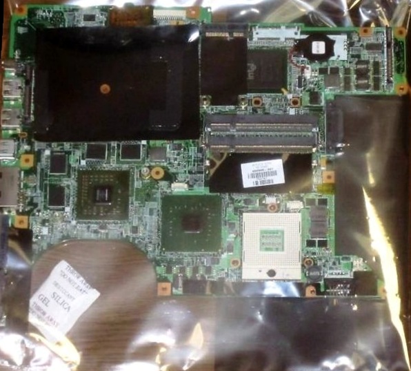

    Probably not many people still interested in these but I wanted to share a recent bad experience.
    Beware of EBAY advertised "Sealed HP New" "2nd Generation Video Chip" "Improved" motherboards.
    I paid over $200 + international freight for a DV9000 series INTEL MB with the NVIDIA GO7600 chip and 512M of video ram.
    This was advertised as A brand-new, unused, sealed HP new, 2nd generation improved over original realease board.
    What I received was a 2006 built board including the NVIDIA video chip also 2006 model in a heat sealed anti-static bag.
    Anyone who knows this model would also know 2006 would be the very beginning of the production run for this model laptop. It was a 2006 release model.
    On top of this there was evidence of previous screwdriver impressions on the cpu locking screw and the power button LED intermittently worked.
    I queried the seller who assured me the board would not be an issue. They also had a high satisfaction rating, so I took their word.
    By the time I got around to installing this I estimate I got about 2.5- 3 months recreational use out of this and then the Video chip failed.
    I got an apology from this seller but no support.
    They are based in Connecticut, United States of America.
    This is what happens when the alarm bells ring but you still put your faith and trust in people.

    You should have gotten a 8600. Anyway, hit it with the hot air gun and you'll get another 3 months out of it, more if you do a little case mod. I cut a hole underneath the GPU heatsink on my dv9000 and installed a small fan with thermal control. Working great since.
        I've tried the oven trick and had the chip bubbling away but could only get a couple of weeks out of it. I have not been able to work out what exactly is a normal temp for the chip to run at but the best I could get was 55C usually 60-65C.
        I have seen 2009 production GO7600 chips which supposedly have different substrate material.

          I disputed it with the seller but he assured it would be ok but it just happens sometimes I guess. it's nice to trust people once in a while but it's hurts being let down.
          Already left positive feedback and more then 3 months now. i should have installed it straight away and used it heavily because it would have failed within the 60 day wty he gave.
          Foolish of me, the odds were stacked against resurrecting this laptop.

            If you keep it under 60 it'll work good. Also try not to drop the laptop, once reflowed the BGA is sensitive to physical shocks as well.
            How does it behave when it dies? Artifacts or just no video at all? If you've done it in the oven and it artifacts but otherwise boots up and loads windows, no BSOD and normal resolution, not 640x480, then it's the video RAM not the GPU.
            I don't know the 7600, but on the 8000 series the RAM chips are on both sides of the mobo, and it's usually the ones on the top, that go under the keyboard and have no heatsinking of any kind, that fail. You're going to need a heat gun to do those. I got creative and cut out a piece of aluminum from an old notebook HDD caddy, and applied thermal grease to it so that the RAM chips on top dissipate some heat thru the top cover and keyboard. Seems to be working fine since (2 months). Well, the GPU failed in the meantime, but that's another story... And that's quite a hack i did to its case, but it's doing a great job. https://www.badcaps.net/forum/showth...t=18907&page=3
            Also if you haven't used flux, that would explain why it failed again so quickly.

              let me ask something, how do you get flux under the chip? that area is very very tiny to get flux into
              also, your problem was you got an nvidia motherboard for a dv6/7/9 series. Those are so inherently flawed cause of this same issue. You should of looked for a dv board with an ati chip

                                  and there is no way it was new or 2nd gen beacause the board and every
                                  component including the NVIDIA GO 7600 video chip was 2006 production.
                                  2006 was the very first year these were manufactured. There was also a
                                  screwdriver impression on the CPU mount screw.
                                  Given the class action taken against HP and NVIDIA which has determined
                                  these to be defective from the beginning and ordering compensation, this
                                  seller is therefor selling known defective items.
                                  I contacted this seller immediately but was assured this board would be
                                  ok but "it should have been " one of the newer boards. He's a conman.
                                  This board has predictably failed and just after 3 months of light use
                                  with NVIDIA video chip failure just as pretty muc every other DV series
                                  laptop with this chip.
