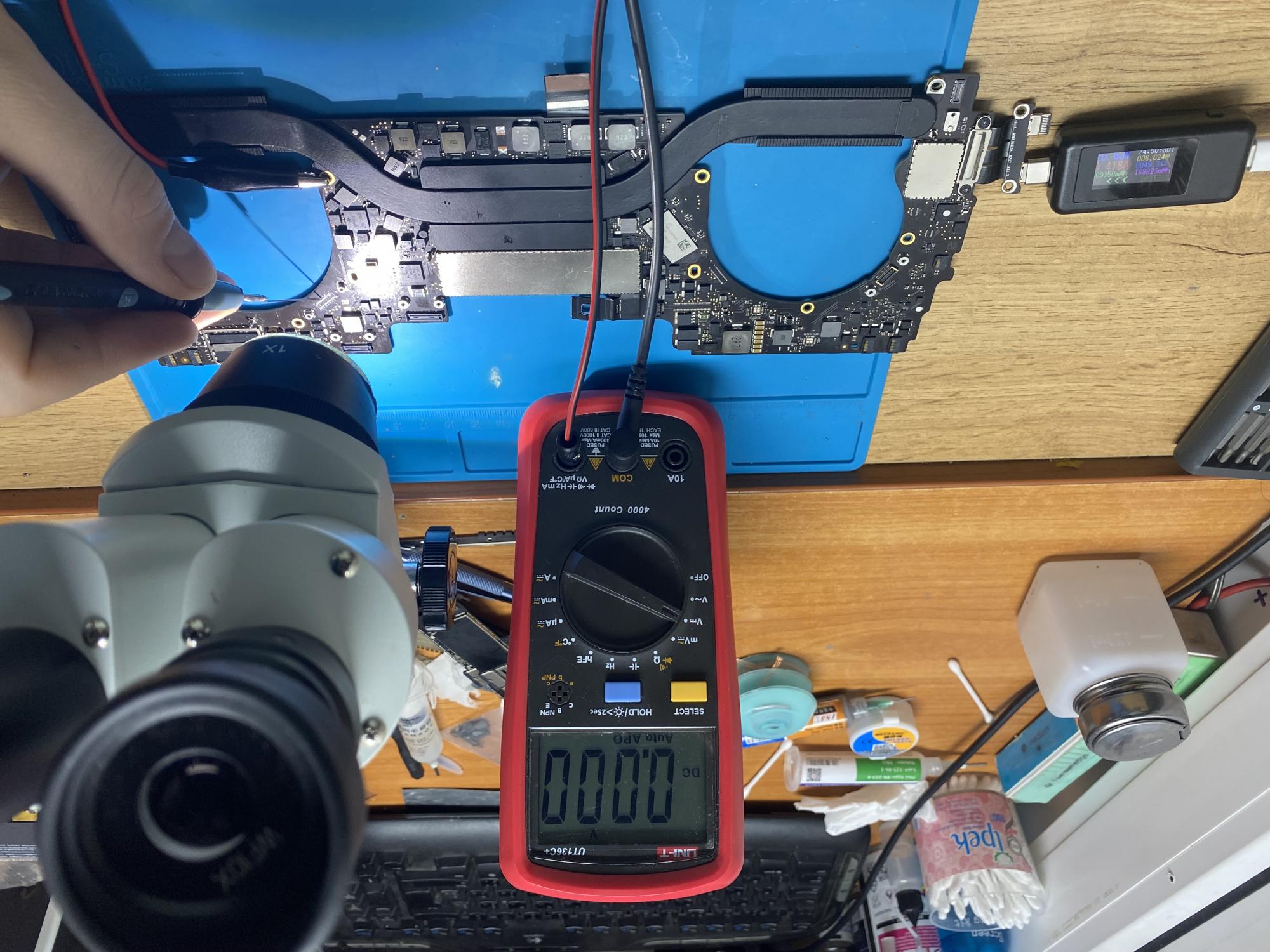

                                What is the voltage to ground for the following?
                                PCIE_SSD_D2R_P
                                PCIE_SSD_D2R_N
                                Remove all power. Then check the above lines in DIODE mode.
                                Red meter probe to GROUND - yes ground.
                                Black meter probe to PCIE_SSD_D2R_P. What is the voltage ?
                                Then repeat with PCIE_SSD_D2R_N.
                                Checking to see if these lines are shorted or not.
                                I am assuming that the PCIe SSD is a high speed model so it will demand that both the Pair #0 and Pair #1 lines will be active to kick up the transfer speed.
                                x1 = PCIe slowest interface
                                x2 (SSD) = faster
                                x4 = faster than above
                                x16 = faster than above
                                • PITERPENY
                                  • Jul 2023
                                  • 461
                                  • Ukraine
                                  #36
                                  Re: Macbook A1706. 820-00239-A doesn't see SSD questionmark folder
                                  PCIE_SSD_D2R_P
                                  PCIE_SSD_D2R_N
                                  x2 (SSD) = faster
                                  PCIE_SSD_D2R_P=0.388V
                                  PCIE_SSD_D2R_N=0.389V
                                  no short circuit

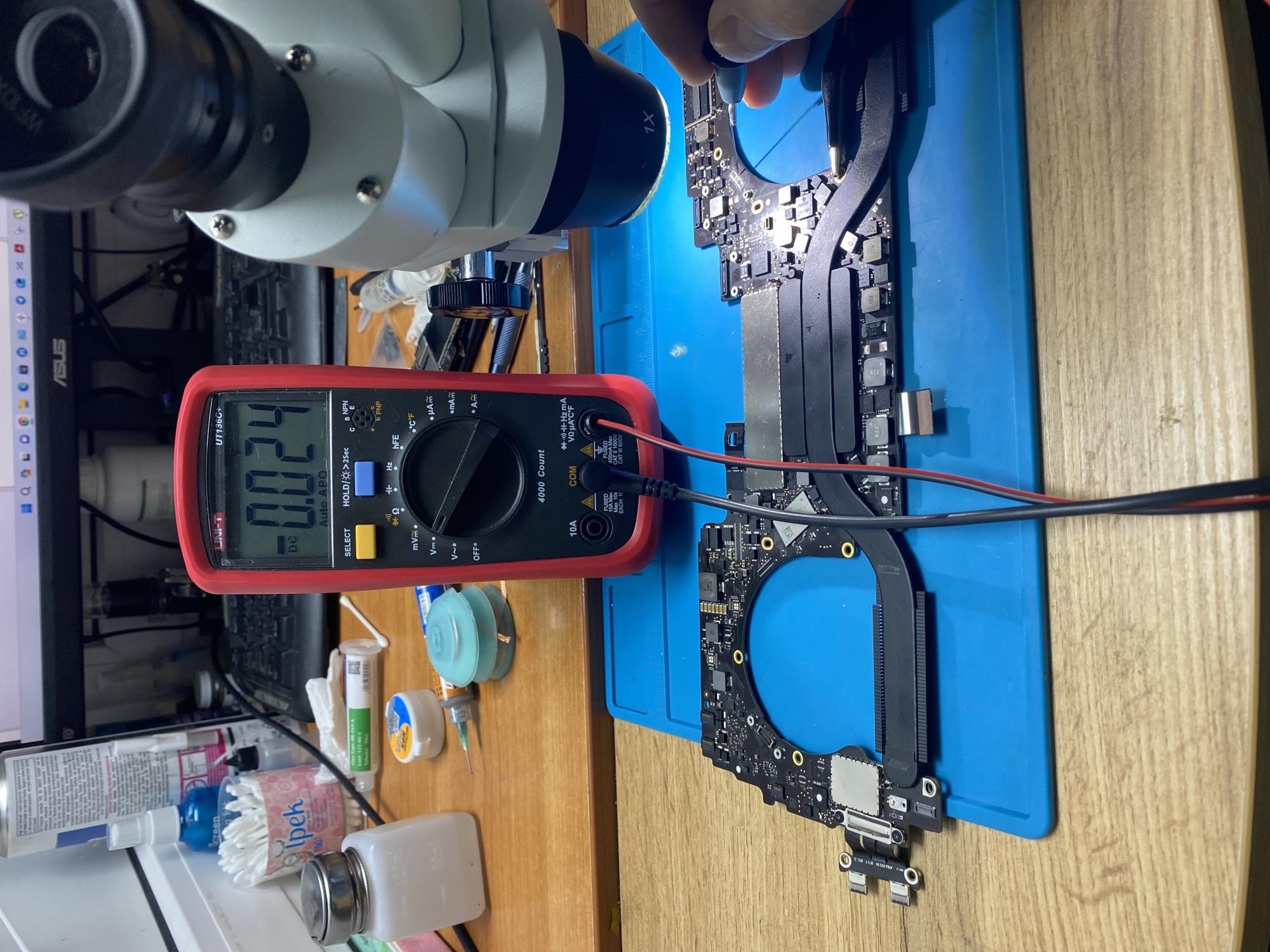

                                  • mon2
                                    • Dec 2019
                                    • 14660
                                    #37
                                    In dc meter voltage mode, do you see a voltage to ground on these lines?
                                    • PITERPENY
                                      • Jul 2023
                                      • 461
                                      • Ukraine
                                      #38
                                      When the power is connected, both lines are equal to 0V.
                                      without connecting to the power supply, the power is 0.019V on both lines.
                                      • mon2
                                        • Dec 2019
                                        • 14660
                                        #39
                                        Confused. With no power, there should be no voltage.
                                        Can you confirm that your meter is in DC volts mode? Select the lowest voltage scale since these pins should be under 3v3 for each. Then measure again.
                                        Red probe on the pin to measure; black probe to ground. What is the voltage?
                                        • PITERPENY
                                          • Jul 2023
                                          • 461
                                          • Ukraine
                                          #40
                                          there is no voltage on these lines
