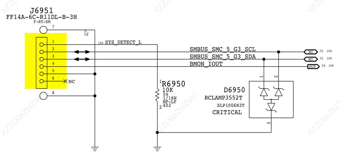

            With no power. Meter in red mode. Measure the resistance to ground of each pin on the battery connector. Checking if the smbus lines are defective.
            • johnbeton
              • Jun 2021
              • 95
              • Belgium
              - is 0,01Ohms
              + is NC

                Need the vitals on the other pins of this battery connector. We are investigating specifically the pin # 2 and # 3 details which are the communicaton lines to the logic board and also linked to the PPBUS_G3H controller.

                  pin1 = 3,1 Ohm
                  pin2 = 10,2 KOhm
                  pin3 and 4 = variable from 35 KOhm - 125 KOmh (keeps going up and down)
                  pin 5 - 8 = 1,2 Ohm
