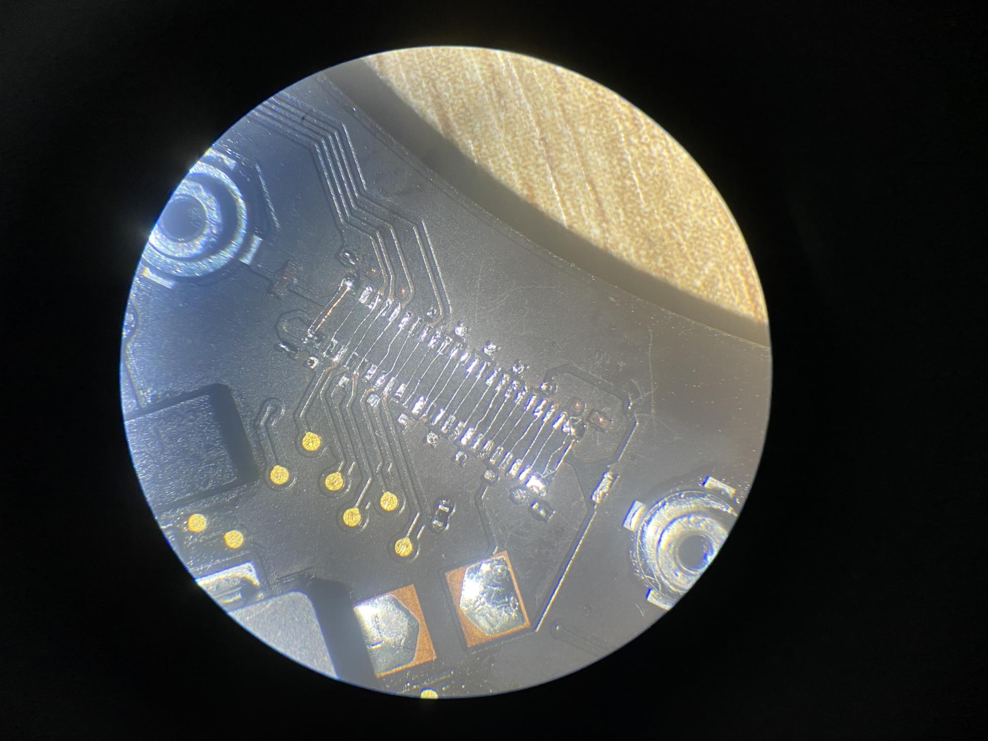

Macbook A1706. 820-00239-A doesn't see SSD questionmark folder
  • PITERPENY
    • Jul 2023
    • 461
    • Ukraine
    Hi all. help with diagnosing Macbook A1706. 820-00239-A. doesn't see SSD. question mark folder. runs from an external drive. All power supplies are normal except for the SSD power supply.
    PICCOLO_IUVD=1.834v.
    PP3V3_S5_SSD=3.352v
    PP3V3_2V7_NAND_VCC=0v.
    PP1V8_SSD_COLD=0v.
    PP1V2_SSD_COLD=0v.
    PPBUS_G3H_R=13.08v.
    PPDCIN_G3H_CHGR_R=19.90c.
    PPVIN_G3H_P3V3G3H=19.65v.
    SSD_BOOT_LB_L 1.8V
    SSD_PWR_EN_LB_L 0V
    STORAGE_LB_EN 3.33V
    SSD_RESET_LB_L 3.32V
    SSD_PCIE_CLKREO_LB_L 3.32V
    LPSR_EN_LB_L 3.32
    replaced U9300 everything remained unchanged. please help me out

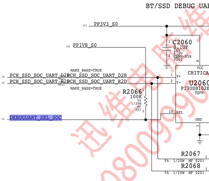

        Check SSD_DBG_UART_R2D/SSD_DBG_UART_R2D_R for activity, pullups etc. These lines come from U2060 and appear on the JTAG header as well so check both of these too.
        • PITERPENY
          • Jul 2023
          • 461
          • Ukraine
          Re: Macbook A1706. 820-00239-A doesn't see SSD questionmark folder
          Originally posted by reformatt
          check ssd_dbg_uart_r2d/ssd_dbg_uart_r2d_r for activity, pullups etc. These lines come from u2060 and appear on the jtag header as well so check both of these too.
          ssd_dbg_uart_r2d=3.3v
          ssd_dbg_uart_r2d_r=3.3v
          pp1v8_s0=1.8v
          debuguart_sel_soc=1.79v
          pch_ssd_soc_uart_d2r=3.3v
          pch_ssd_soc_uart_r2d=3.3v
          • reformatt
            • Feb 2020
            • 1497
            Needs to be low for PCH data to route to M+/M-. Coming from the CPU. It could well be that these signals are active during boot, and as SSD not detected it reverts to debug state. I would be checking these signals during initial power on.
            • PITERPENY
              • Jul 2023
              • 461
              • Ukraine
              compared debuguart_sel_soc
              on the working board there is also the indicator debuguart_sel_soc=1.79v.
              at startup the readings do not change debuguart_sel_soc=1.79v
              ( . the diagram also indicates debuguart_sel_soc=1.8v

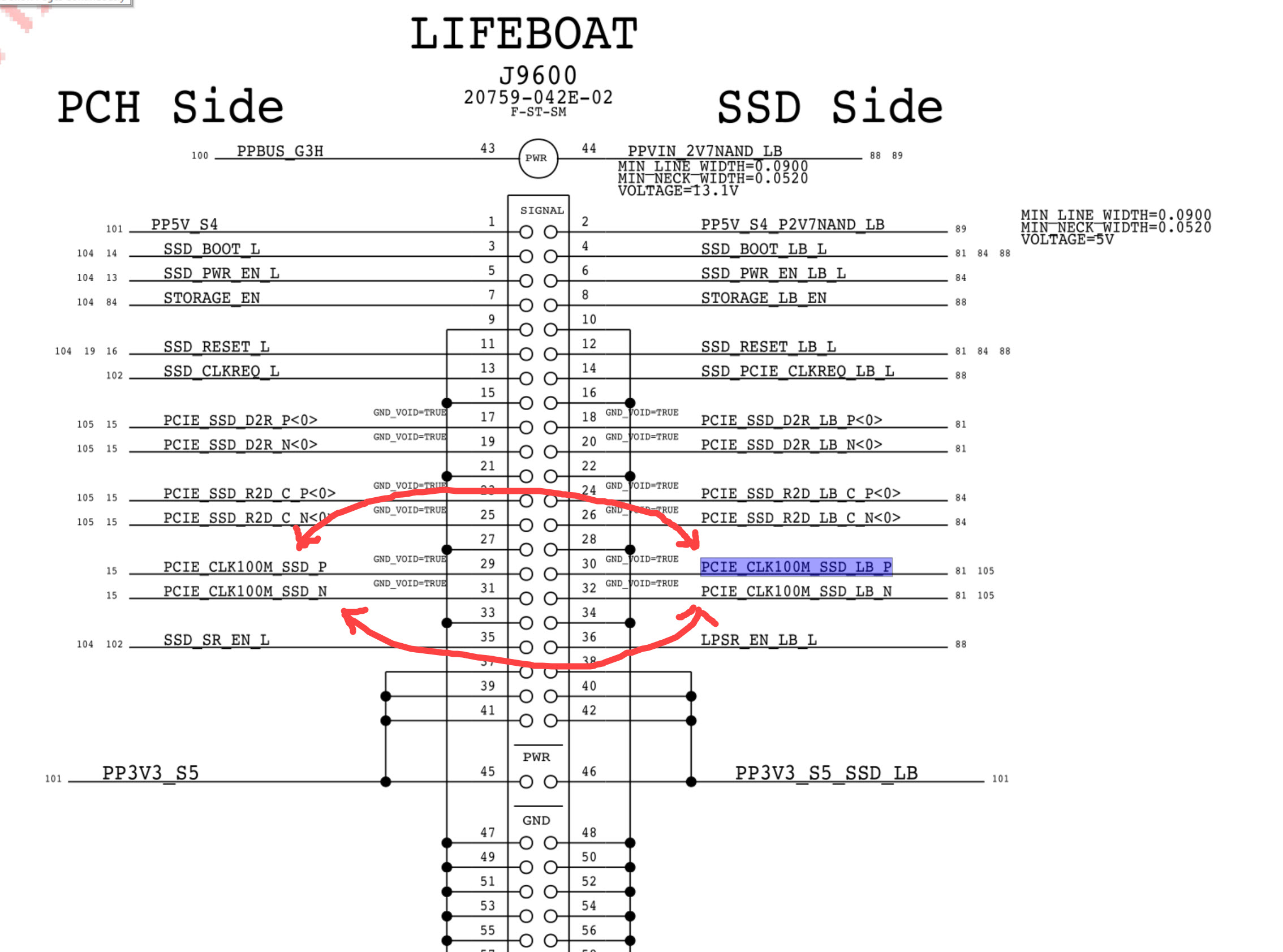

                Checked Lifeboat dongle presence and connector state?
                • PITERPENY
                  • Jul 2023
                  • 461
                  • Ukraine
                  LIFEBOAT SSD Side
                  PPVIN_2V7NAND_LB=13V
                  PP5V_S4_P2V7NAND_LB=5V
                  SSD_BOOT_LB_L=1.8V
                  SSD_PWR_EN_LB_L=0V
                  STORAGE_LB_EN=3.3V
                  SSD_RESET_LB_L=3.3V
                  SSD_PCIE_CLKREQ_LB_L=3.3V
                  PCIE_SSD_D2R_LB_P<0>=0V
                  PCIE_SSD_D2R_LB_N<0>=0V
                  PCIE_SSD_R2D_LB_C_P<0>=0.9V
                  PCIE_SSD_R2D_LB_C_N<0>=0.9V
                  PCIE_CLK100M_SSD_LB_P=0V
                  PCIE_CLK100M_SSD_LB_N=0V
                  LPSR_EN_LB_L3.3V
                  PP3V3_S5_SSD_LB=3.35V

                    • mon2
                      • Dec 2019
                      • 14662
                      I think you have received excellent advice from the best of the best already.
                      Do review this video if not done already:
                      https://youtu.be/yt0f3sGSZas?si=C5BqifVFAdVsZZIs
                      Note that the _L suffix net names are active LOW. So active only if that signal is logic LOW.
                      The pcie clock is not running so the ssd is not being detected.
                      What is the history of this logic board? Any liquid damage?

                              • PITERPENY
                                • Jul 2023
                                • 461
                                • Ukraine
                                detected unusual behavior of the SSD_PCIE_CLKREQ_LB_L line 3.3V power appears on it for just a moment and then it becomes 0.088V. Does anyone have any ideas what's wrong?
                                • mon2
                                  • Dec 2019
                                  • 14662
                                  This is a netname with a '_L' suffix so it is an active LOW signal.
                                  When this line is LOW, the signal is active and enabling the SSD_CLK.
                                  With the J9600 (LIFEBOAT) jumper hat closed, confirm the continuity (diode mode is good to use here) from the PCH to the SSD side. No power during these tests.
                                  That is, you are confirming that the LIFEBOAT jumper block is performing the shorting across the pins.
                                  Also,
                                  are PCI Express clock signals that are to be driven by the bus master. These pins must be oscillating @ 100 Mhz (differential signals with a positive / negative phase) to allow for the PCIe slave (SSD) to communicate.
                                  Your PC motherboard has the same set of signals on each PCIe expansion slot. The host motherboard creates this PCI Express clock to drive the target PCIe device (ie. could be a video card, USB host controller - addon, serial ports = our market . This is not related to the clock function of the motherboard which is often linked to the RTC (real time clock) label and is usually a slower 32k768 frequency for the clock / calendar chip.
                                  Regardless of the above details, these lines must toggle else the SSD cannot communicate. Do check these same signals on the PCH side for activity:
                                  PCIE_CLK100M_SSD_P
                                  PCIE_CLK100M_SSD_N
                                  • PITERPENY
                                    • Jul 2023
                                    • 461
                                    • Ukraine
                                    Also,
                                    PCIE_CLK100M_SSD_P
                                    PCIE_CLK100M_SSD_N
                                    thanks for the extensive answer).
                                    checked with a LIFEBOAT multimeter (in diode mode)) everything is flawless.
                                    PCIE_CLK100M_SSD_N=0.436v
                                    PCIE_CLK100M_SSD_LB_N=0.426V
                                    PCIE_CLK100M_SSD_P=0.436v
                                    PCIE_CLK100M_SSD_N=0.426V
                                    SSD_CLKREQ_L_R when switched on 3.34V and then 0.096V
                                    It seems that the voltages of the SSD chips themselves are normal. how do you think ? Tell me what else to watch, otherwise I haven't been able to solve this problem for five days now(:да:
                                    • mon2
                                      • Dec 2019
                                      • 14662
                                      Sorry, should have been more clear. Meter in diode mode.
                                      One meter probe on pin # 1 on the lifeboat connector; other meter probe on pin # 2. Should tone beep if pins #1 and #2 are shorted.
                                      Repeat for each horizontal pair of pins to confirm the lifeboard short block is doing its job. Perhaps an overkill task but worth a review.
                                      • PITERPENY
                                        • Jul 2023
                                        • 461
                                        • Ukraine
                                        I temporarily removed it and soldered it directly.
