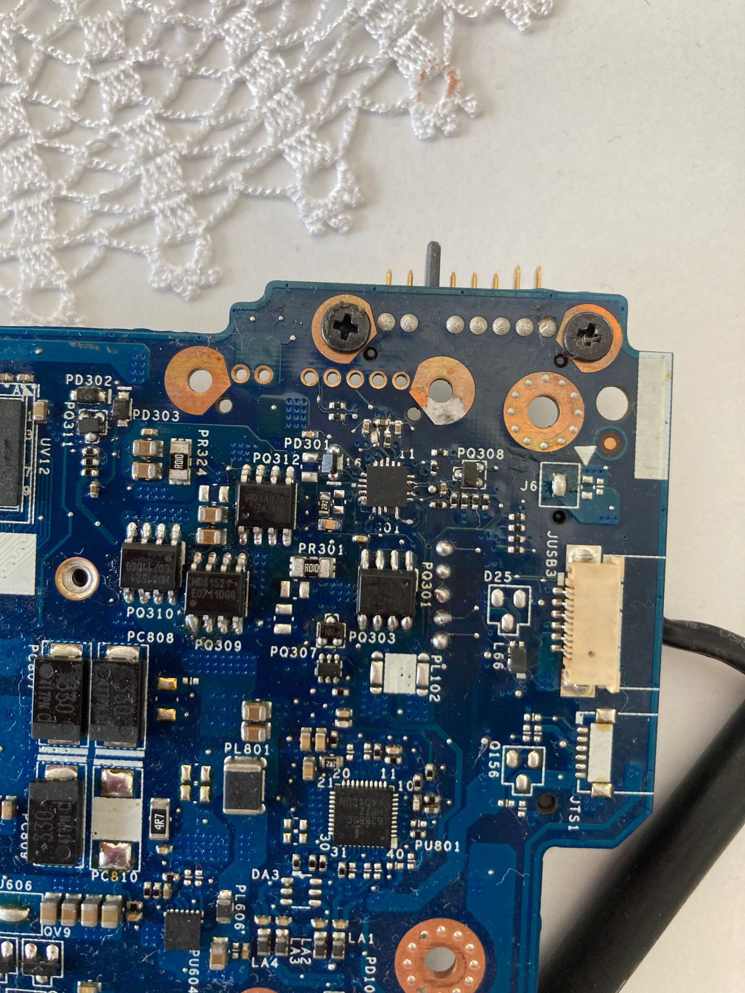

                        I solved the problem because replaced again new pu301 ic.
                        But ı have new little problem.I broken the way point pin8
                        • mon2
                          • Dec 2019
                          • 14837
                          #72
                          Re: Lenovo G510 Slow Charging Problem
                          Can you clarify? Post a picture.
                          Broke pin #8 on PU301 charger IC?
                          • ay_erdi
                            • Feb 2013
                            • 74
                            • turkey
                            #73
                            Motherboard works with adapter but I plugged in battery;battery leds flash orange led.
