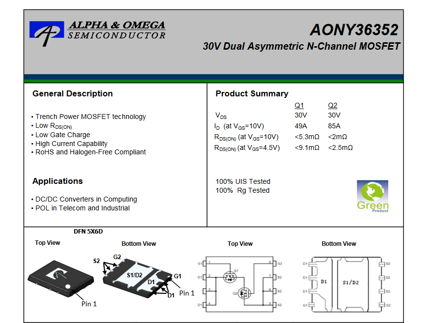

    I have a problem with charging circuit in this laptop. Unit came with no power at all (USB-C meter was cycling turning off and on). I discovered that when I unplug battery laptop works on charger only. So after few measurements I found shorted 1st dual mosfet AONY36324. Unfortunately i was not able to order exact this one, so i ordered AONY36352 which i believe is the similar one. Now the problem is, when i connect battery and charger USB-C meter is not cycling anymore, it starts charging (reading 20V@2,7A) but after few seconds it is going down to 20V@0,20A and laptop switch to battery power. In windows it shows PLUGGED IN, CHARGING but percentage is decreasing. I tried 2nd battery and also replaced BQ25700A and USB-C DC Jack without change. Without battery attached laptop works on charger only. Could AONY36352 be the problem or is there anything else? I am attaching schematics and boardview also.

    It is the replacement dual mosfet. The replacement part is not the same pinout as the original.

      Could you please explain where is the difference ?
      Ordered exact same mosfet, will arrive in 2-3 weeks. I will keep updated.

        See attached. Compare the internal symbols of the dual mosfets against the schematic internal symbols. For starters, review pin # 7. On the replacement, pins 5,6,7 are tied together. This is not the same as the original.
