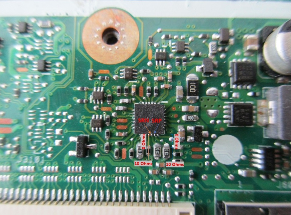

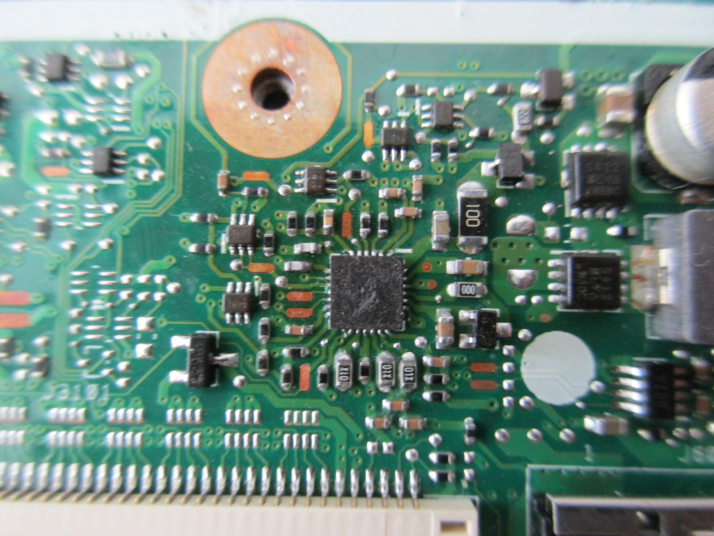

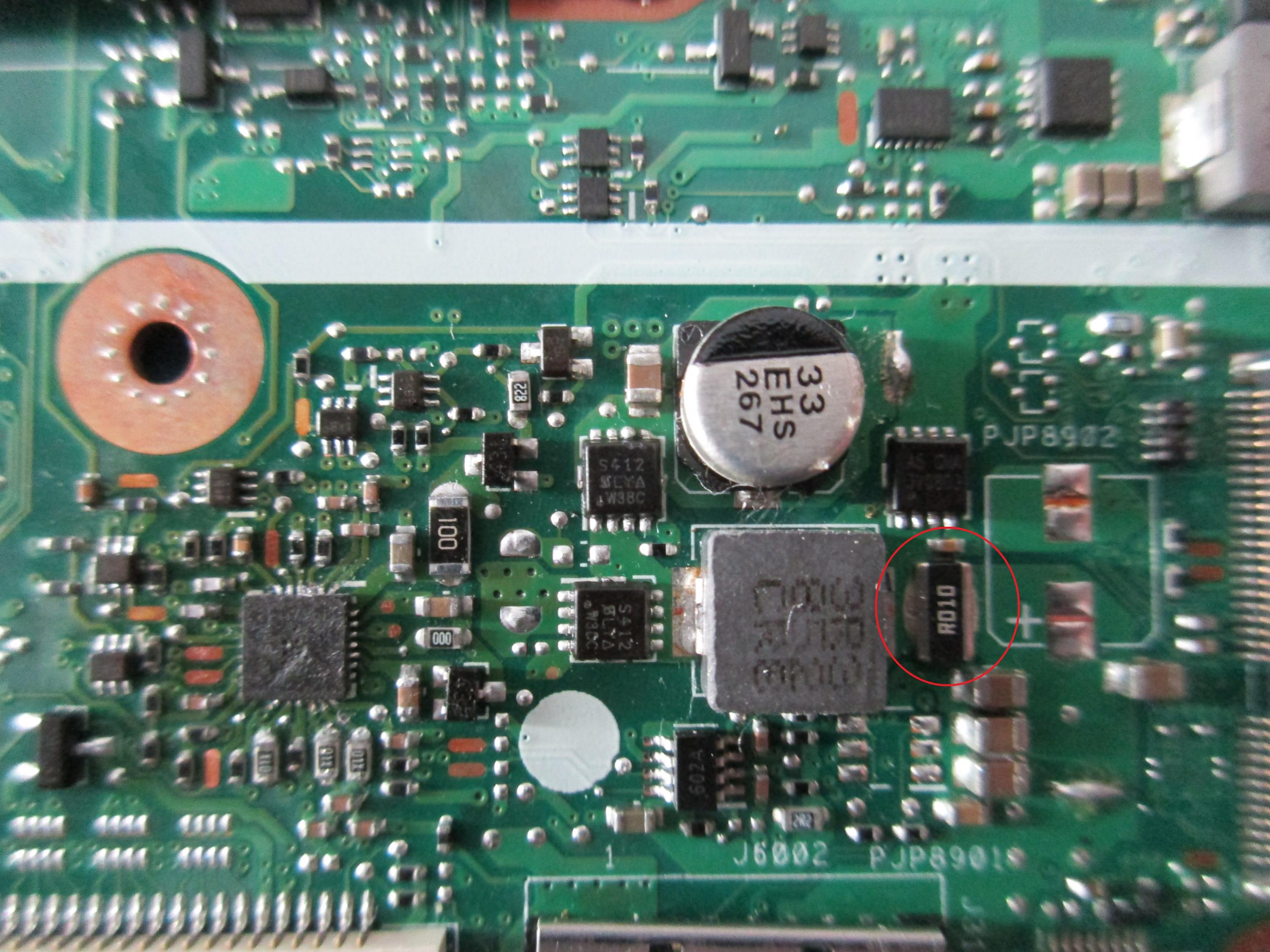

                                    • Kambi13
                                      • Aug 2022
                                      • 134
                                      • Portugal
                                      Re: Asus X512F won't hold on battery charge
                                      Hi again mon2, see the attached picture. The closest resistors to SRN and SRP are both 10 Ohms.
                                      Now if you're looking for the current sense resistor for the battery, from SRN and SRP to both sides of that 0 Ohm resistor, there's still those 10 Ohms before and after the current sense resistor
                                      • mon2
                                        • Dec 2019
                                        • 14659
                                        The resistor with R010 markings = 10 milli-ohms = 10/1000 ohms.
                                        Let me try to trace the path which may make sense if they have additional resistors in the current sense loop.
                                        Update:
                                        In reviewing other boardview files for Asus motherboards, they do indeed like to place 10 ohm resistors in series with each pin of the SRN and SRP for a total of 20 ohms extra in the current sense path.
                                        So total resistance between SRN & SRP = 10 ohms + current sense resistor (10 mOhms) + 10 ohms = ~20 ohms as you have measured. This leg appears to be ok.
