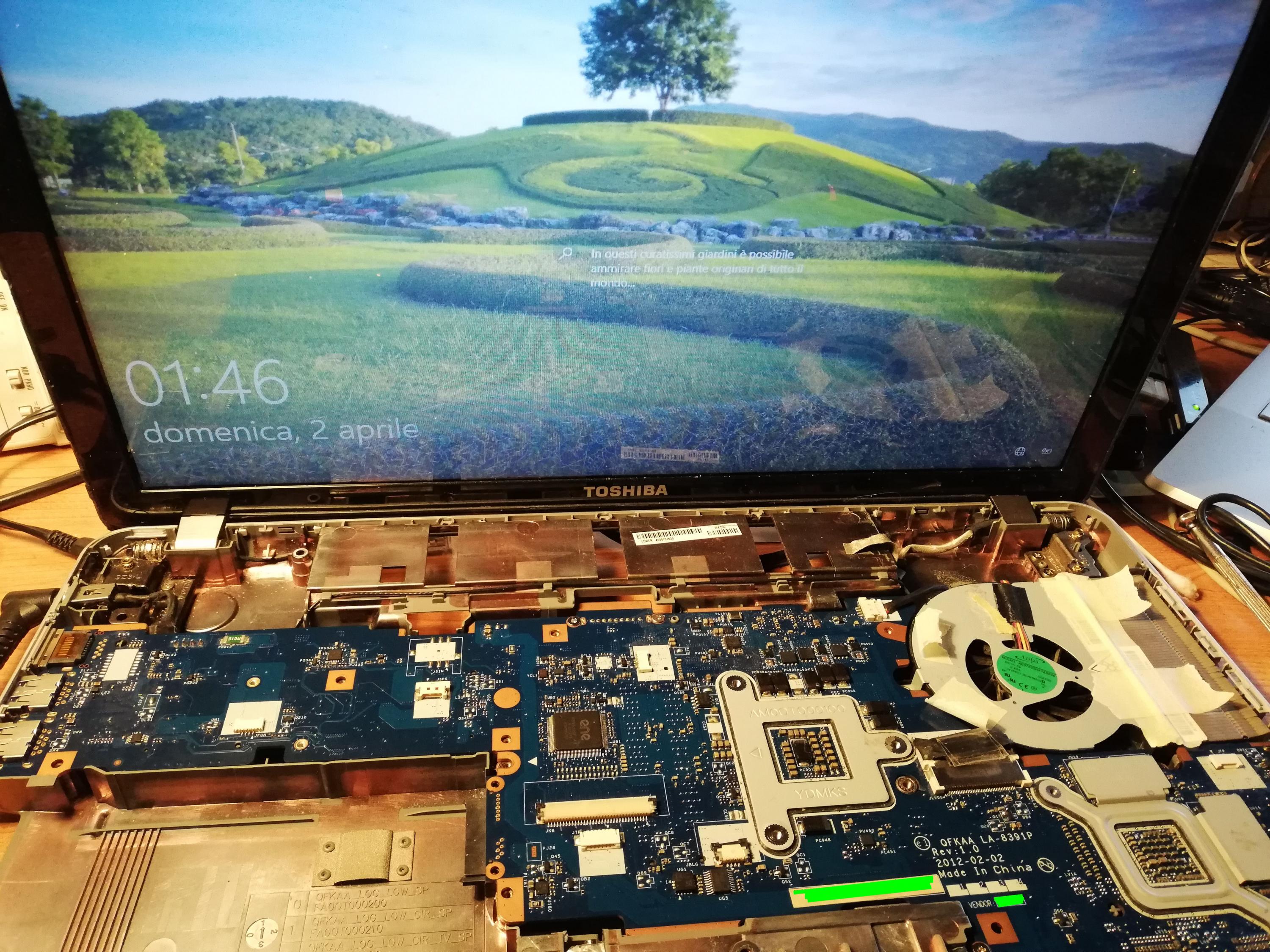

        Re: Toshiba P855 only works with battery
        Unbelievable, I tried taking out a stick of ram and it booted up to windows

          #44
          More specifically, I have 2 sticks of Ram one of 4MB, present since the beginning of a laptop bought new, and the other of 8MB bought online recently because I suspected the Ram but I hadn't flashed the bios yet.
          After the flashing it started only with the battery and just now, by chance, I wanted to try only with 4MB of ram but I moved it by slot, then I added the 8MB one in the slot where there was the 4MB one, then in reversed positions and the laptop booted up.
          I try to reverse the positions, as they were before, and in fact it does not start and remains stuck on the logo.
          Question: but when the sticks are different, for example 4MB and 8MB, is it possible that the 8MB one has to fit in a specific slot to start the machine ? It's strange because the bios sees 12MB exactly equal to the total ram installed.
          • mon2
            • Dec 2019
            • 13849
            #45
            Interesting observation. You will have to review the Toshiba laptop memory guide for this model to understand which permutations are permitted.
            I recall a similar bad experience from a motherboard vendor who offered a table of all permitted ram stick combinations. We wanted to expand to 32GB yet none of their approved vendor list sticks worked. Killed a day of trial and error and truly believe the fault was with their BIOS coding. Purchased a different brand (ASROCK I believe) which on the other hand, could not fail to recognize the many different sticks of ram we purchased -> each set allowed for a working 32GB configuration. The ASROCK bios actually came back with guidance that we could clock the sticks even faster than the defaults while the first motherboard would just not power up unless we went for a lower amount of ram.
