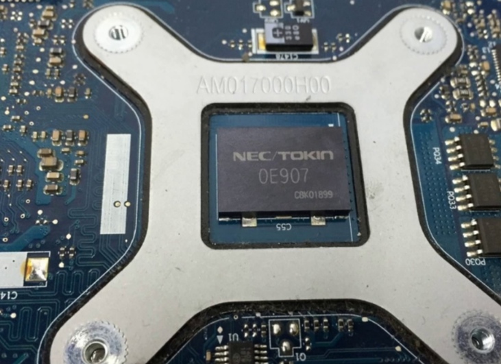

              Does it have NEC-TOKIN type capacitor in cpu vrm circuit?
              • zioricci
                • Jan 2023
                • 125
                • Italy
                Re: Toshiba P855 only works with battery
                If you're referring to this genre,
                no it doesn't have it and if you ask It me about the row of pixels, it's gone for the moment. In this regard I would like to ask a question: did it disappear because I changed from CSM boot to UEFI or because I soldered some choke coils
                that were missing on the hdmi port?
