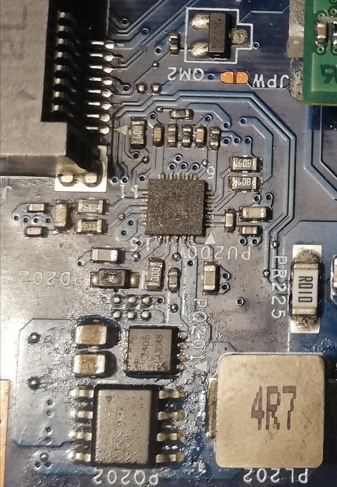

        Re: Toshiba P855 only works with battery
        While hunting for shorts in the vicinity of the IC charger, I found this capacitor circled in green on the figure with a resistance of 0.4 Ohm...maybe a little low in value. Could this value explain the exclusion of the adapter as a power source?
          It is ok since you are measuring the resistance of pr225 which is a low value current sense resistor.

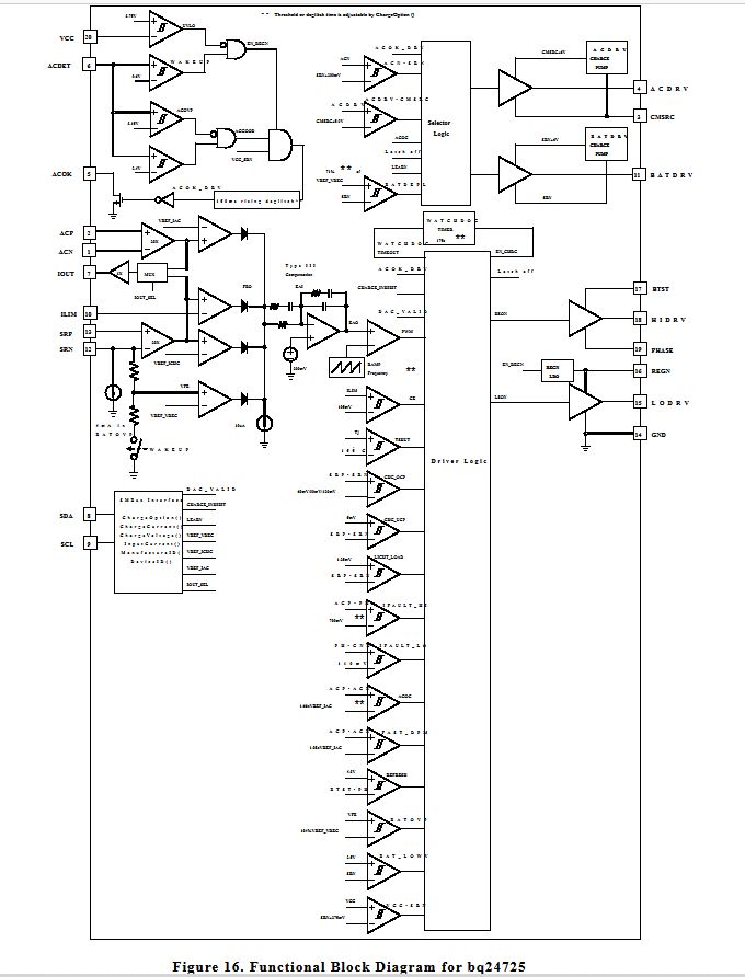

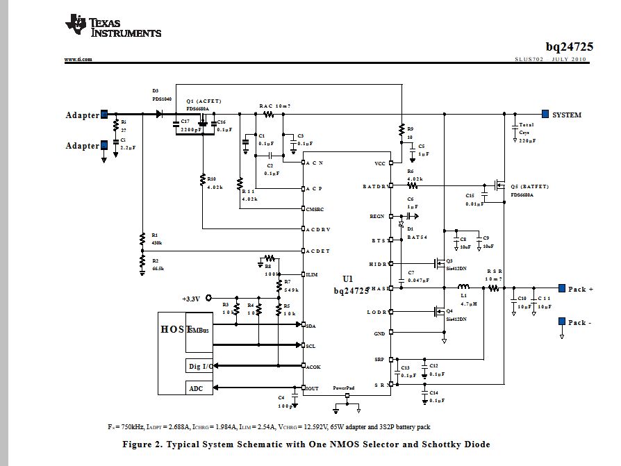

                    • zioricci
                      • Jan 2023
                      • 125
                      • Italy
                      #30
                      I enclose pictures of the internal BQ24725 taken from the datasheet

                            • zioricci
                              • Jan 2023
                              • 125
                              • Italy
                              #34
                              the PD202 zener diode that looks like it burst works, it's just dirty

                                #35
                                Is PD202 with a chipped topside ?
                                Concerned about why there is a voltage @ BQ24725_LX when the battery is removed.
                                With the battery removed, PQ201 & PQ202 should be OFF so expecting 0v @ BQ24725_LX.

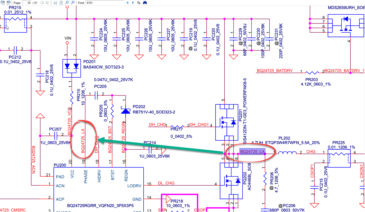

                                    #37
                                    See attached. The voltage @ PHASE pin #19 to me is of concern.
                                    This is the voltage created by both the high side mosfet (PQ201) and low side mosfet (PQ202) working together to lower the high adapter voltage that is fed into the drain pin cluster (5-6-7-8) of PQ201.
                                    When the adapter only is connected I would not expect a voltage to be present on pin #19 that monitors the lower voltage.
                                    For now, test the following ideas:
                                    Remove the 0 ohm resistor @ PR217. This will remove the gate voltage on PQ201.
                                    Then measure again the voltage to ground of BQ24725_LX. You can measure at the BATT+ battery connector pin. Do not have the battery connected.
                                    What voltage do you read now ?
                                    In summary, we want to disable PQ201 from the circuit.
