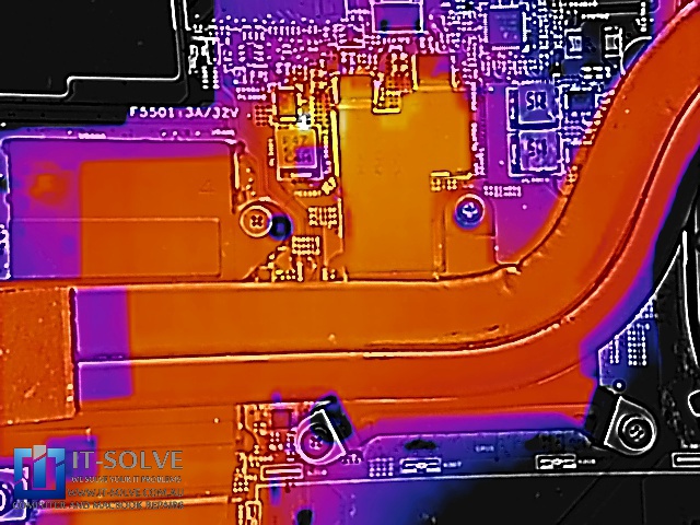

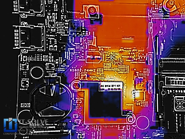

    Without heatsink and battery, I can see under IRCam the CPU and GPU heat up for a sec, which means all voltages are OK.

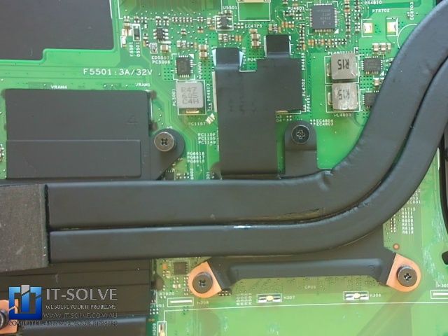

      Voltage on pin #28 = Vcc is too low.
      Connected to this pin is a low resistance series resistor (~10 ohms). Confirm the resistor value with all power removed.
      Next are 2 diodes that you can see in your posted pic.
      Check that each diode is ok with no power, meter in diode mode.
      Then with battery connected, measure the voltage input to the diode, voltage output at the common cathode of the 2 diodes but before the series resistor.
      Vcc is too low after this group of parts.

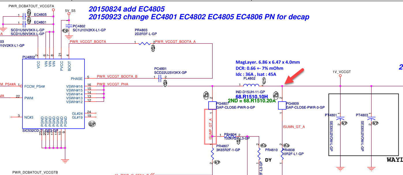

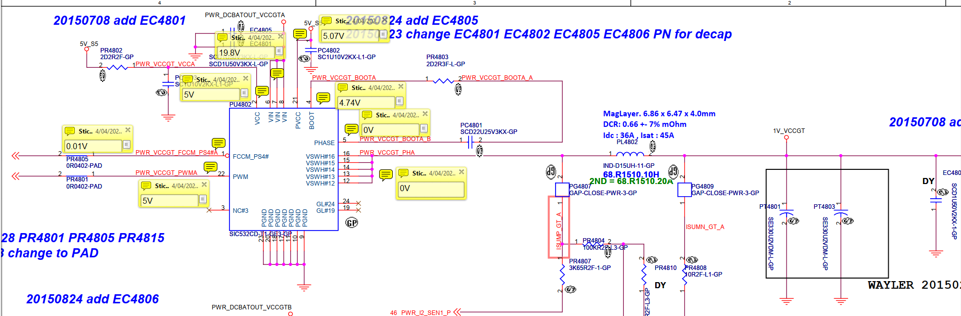

        Voltages on coils seem to be present apart from 1V_VCCGT which is 0V with connected LCD. I assume this should be 1V. All voltages here seem to be OK apart from PWR_VCCGT_PWMA, which seems to be coming from ISL

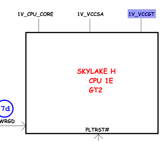

          1V_VCCGT - 0V
          This is concerning. This is a voltage rail used by the CPU.
          Remove all power. Meter in the lowest resistance scale.
          Measure the resistance to ground of 1V_VCCGT @ PL4802, pin # 2.
          If the resistance to ground is very low - the CPU may be defective.

                Thanks, @piernov that makes sense. Although this is 1V_VCCGT on the CPU coils.
