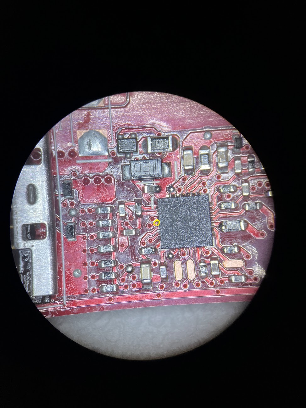

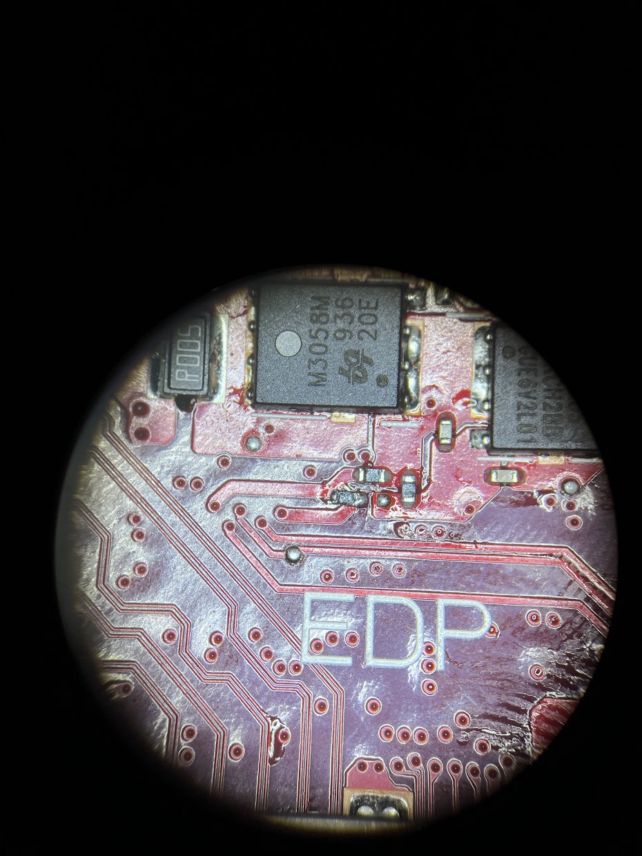

            Well! Just received the new EC.. Soldered it, and checked that the short was still gone (it is).
            The laptop is still dead though, I still get 19V in to first DC-in mosfet, 0V out, next mosfet is 0V in, 4V out?
            I could just go ahead and solder all new mosfets on the board, but I have the idea of working blind, and just throwing stuff at it until it might work.

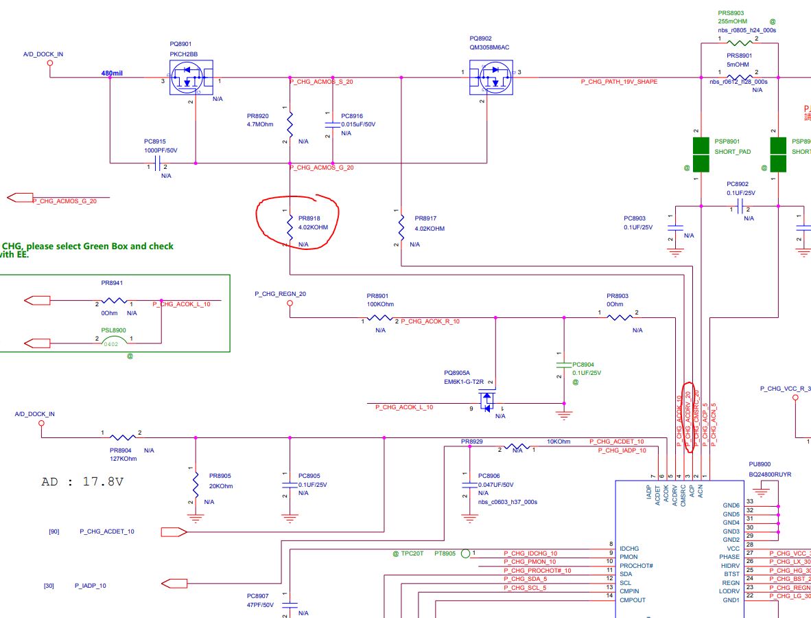

                              • jacobtc
                                • Apr 2016
                                • 274
                                • Denmark
                                #35
                                Re: Dead ASUS ROG G14 (GA401)
                                Is this the resistor you are talking about?
                                • mon2
                                  • Dec 2019
                                  • 13908
                                  #36
                                  Yes. Very likely that you will get back your 25v on ACDRV pin #4 but confirm it.
                                  Then the suspect is the 2nd DCin mosfet. It is probably defective and must be replaced.

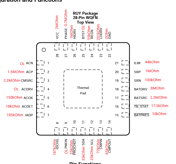

                                        #39
                                        I just moved it, so it only had one pad connected. I have not removed it completely, no change.
                                        I did the requested readings, see pic.
                                        I still find it weird that the first DC-IN mosfet has 20V in, 0V out, then the next mosfet has 0V in and 4V out.. How is that possible?
                                        • mon2
                                          • Dec 2019
                                          • 13908
                                          #40
                                          Sorry, I meant to measure the voltage to ground of each pin. Post the list again.
