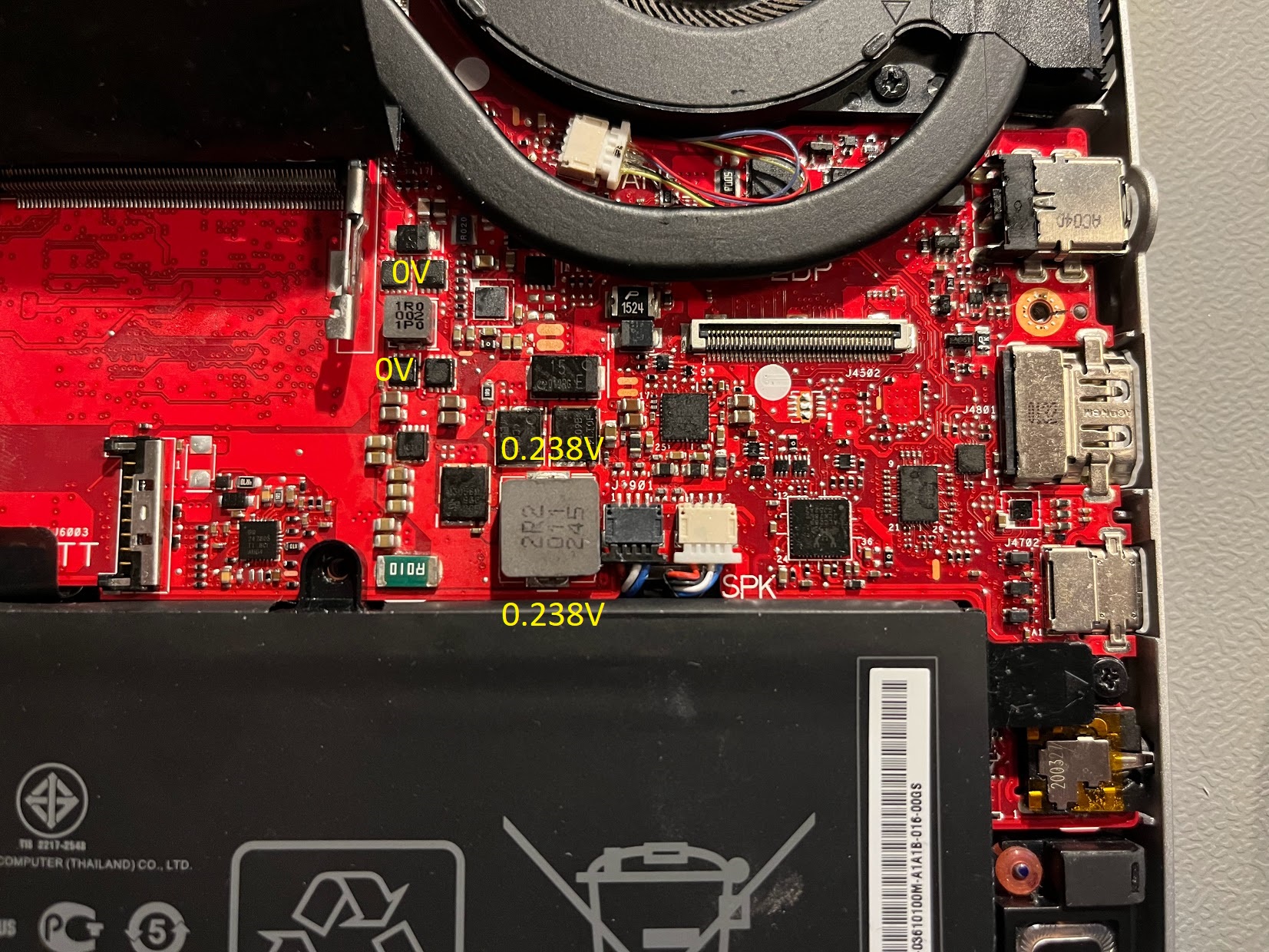

        Alright... No internal shorts, everything is Mohm...
        Now, I replaced the transistor..
        ACDRV now measures 2.2v!? I might have done bad measurements before, but I doubt it, I normally double check..
        What the hell is going on?
        REGN is 0.6V again...
        Let me give you new measurements for the before mentioned pins...

          Lalala... it seems, the Charging controller went bad again...

            Third times the charm it seems! Resoldered a new BQ IC and it seems to boot, I need to get everything installed to check for output etc, but at least I have lights!
            I Had a real hard time actually getting some off the pads connected with the BQ installed, this might have been the problem in the first place, they pre-tinned fine, but when the BQ was placed, the and I went to retouch the pins, the solder was just removed from some of them, I did you enough flux to coat the whole area. Could you advice on why this could be, and a solution?.
            This time around I carefully pre-tinned the pads on the BQ chip itself as well, making sure that there was no way a connected pin could be missing, when soldering it on the board.
            I use a Weller WMRP with a 0.2mm tip for the fine soldering, a WSP80 for larger pads/Ground pads and Amtech Flux (Real) with some leaded solder, but still, some of the pads seemed like they repelled solder
            I use 380C on the big tip for ground pads etc, and 380C on the small 0.2mm tip for fixing up pins etc.
            I've marked the pads (red) I am not happy with in the pic, also a pic of my setup.
            Again, Thank you so much for the help, I am slowly learning, and appreciate your and the communities patience with my at times stupid questions

              I've challenged the same from time to time. Some boards have a massive heat dissipation in this area which make the task very hard. Additionally often the pins of the charging controller does not access the solder as it is supposed to be.
              The only solution is to apply enough heat, maybe work with preheater, use leaded solder, a soldering tip which is neither to small, nor to big and as you already figured out, to pre-tin the pins.
              I'm satisfied you figured that out in the end. Hopefully there doesn't appear a second issue.

                I spoke to soon, laptop does turn on, but turns off after 20 seconds, no display or anything, just fanspin. I tried unplugging display etc, but nothing makes it stay on.
                EDIT: Does not register USB-C power either. No external display either. CPU and GPU get hot.

                  Nooooo...
                  Check all coils for voltage within these 20 seconds. Maybe you can take a picture of the board and write the values near the coils.

                    Yeah
                    Got the readings of the coils, I do get 1.2, 1.8, 3.3 and 5V at the CPU GPU area, but the coils at the DC in area are wrong I believe?

                      Re: Dead ASUS ROG G14 (GA401)
                      I'm afraid to tell, there are more coils underneath the heatsink. Don't be afraid to remove it (carefully ofc!) since the Boards doesn't stays on for long anyway. So overheating won't be a issue right now. Will be very helpful to clarify where it is stuck.

                        Oh yeah, missed those.
                        Got them for you here.

                          I'm concerned about these two right now. Double-check voltage first. Then remove power and check resistance to GND at any coil, any side.
                          I have the feeling there could be a issue with the +1.35V supply for VRAM.
                          Is it possible to share the schematics or is it already shared somewhere and you can share the link?

                                  Both measure OL, no shorts.
                                  EDIT: I tested again, and I do infact get 1.2V on the two coils, just very shortly, which is why I missed it last time. Also, after removing the heatsink and fans, the laptop turns off faster (3-4 sec), I'm pretty sure it doesn't overheat, as the CPU and GPU is only slightly warm.
                                  Sometimes the laptop stays on (light on) but no voltage on coils.. Very weird.

                                    Neither boardview nor schematics seems to match exactly for this board. Maybe someone can enlighten me regarding this issue.
                                    However. Neither 0 Ohms, nor O.L. is a normal value for +FBVDDQ and i'm pretty confident, that's the rail we're dealing with.
                                    So please check again. Try to exclude some kind of contact issue with your probes, maybe by measuring each coils between both pads (they should show short ofc).

                                      Yeah, the boardview and schematic is for a different model, but was the closest I could find. I just checked from a grounding point to both sides of the coils...
                                      EDIT: You were right, I get 35ohm on both sides on both.

                                        unfortunately 35 Ohms are perfect, so still no clue and i guess when you measure again, the 1.35V +FBVDDQ is coming up there?
                                        i have not much hope left for this device to be honest. Maybe, to rule out a corrupot BIOS will be worth a try.

                                          1.2V is measured on both coils.
