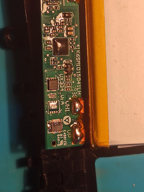

    Hello.
    Have this Asus UX433FAC that came with shorted mosfet on main power rail. After replace laptop works ok, but battery is dead. Laptop show charging but voltage on battery is 0.2V. when remove battery voltage on battery connector goes to 8.5V, but when connect battery again it goes down to 0.2V.
    can that short shorted battery? batmon show that battery is full at 80%

      Check the voltage to ground on the SMBUS lines (SDA / SCL) on the battery which spit back data from the BMS inside the battery pack.
      SMBUS lines looks ok 3.3V when connected and charger attached. measured mosfets and all looks ok. Battery was ok before. batmon shows good capacity. dont have another battery so i like to be sure that problem is battery because battery is not cheap
      i unwrap battery and cells is all 4.1V. on some points of BMS i measure 12.5V
      can be bms measured if it is ok?

            thanks i will look at it. i have airduno and some UART reader
            2. battery packs have all 4.1V and together 12.3V . I mean that without battery on bat. connector on board i have 8.5V, but when connect battery it goes to 0.2V. not fast so it more looks like controlled
            3. it is BQ24790
            4. measured and all lokks good 500ohm/infinity
            Looks like the battery can be problem, because i found shorted mosfet on BMS. remove it and it is really shorted S-D. but after replace still same behavior. on one of that output mosfet i have 12.3V but nothing on battery output
            so controller can store hard fault
            can i use battery from other laptop with same connector and pinout?

                without connected battery, no voltage on any pins of battery connector on battery. i know how to test mosfet

                      With no voltage, I think the BMS is dead or locked up.
