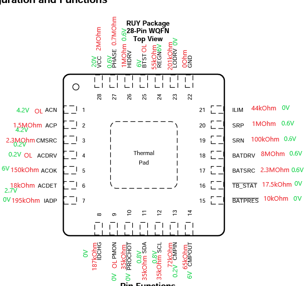

    Need to check if the charger IC has the conditions to spit out the boosted voltage on ACDRV. Be sure that the part is well fluxed and well heated to swim but settle down on the PCB pads, naturally. Low air pressure but enough heat to make it swim. Just in case there are any shorts, this process will correct the hidden shorts.
    Alright, I will remove and resolder the BQ IC and get new measurements tomorrow, it's bedtime for me

          Got some voltages for ya'
          Wouldn't the voltage only tank if something was connected? I have everything disconnected when doing the measurements...

            Pin 10 voltage on the charger IC is of concern.
            See attached.

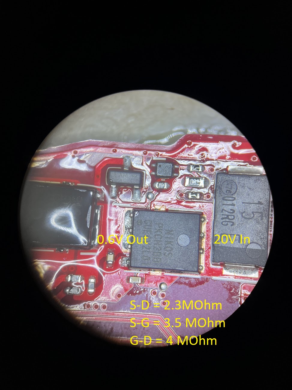

            Can you remove the 2nd DCin mosfet? Then measure the resistance of the removed part while it is on your work table.
            Intered in the resistance readings of the removed mosfet between:
            source (1-2-3) & drain (5-6-7-8)
            source (1-2-3) & gate (4)
            gate (4) & drain (5-6-7-8)

              Just did S-D, and that measures a dead short... Jesus, these are hard to find. I did voltage injection, although only 1V1A, but still, that did not show up on the thermal image...

                What are the topside markings of this mosfet?
                Being n-channel, you can probably replace it with many others on donor boards, etc.
                First, need to be sure there is a physical match.
                2nd - the mosfet is N-channel.
                3rd - current / voltage support.
                If you have donor boards around - check if the charger IC is any of the BQ series. The BQ charger ICs use N-channel mosfets.

                  It is a M3058M, I have a couple of those laying around as well

                    Before you proceed..check that there are no shorts on the source, gate or drain pins on the PCB pads.

                      No shorts on pads. Soldered new mosfet, no change. Still same 4V out, and 0V on Pin 10.

                        Measure the voltage to ground readings of the first mosfet.
                        Post each measurement.
                        • mon2
                          • Dec 2019
                          • 13887
                          #52
                          Re: Dead ASUS ROG G14 (GA401)

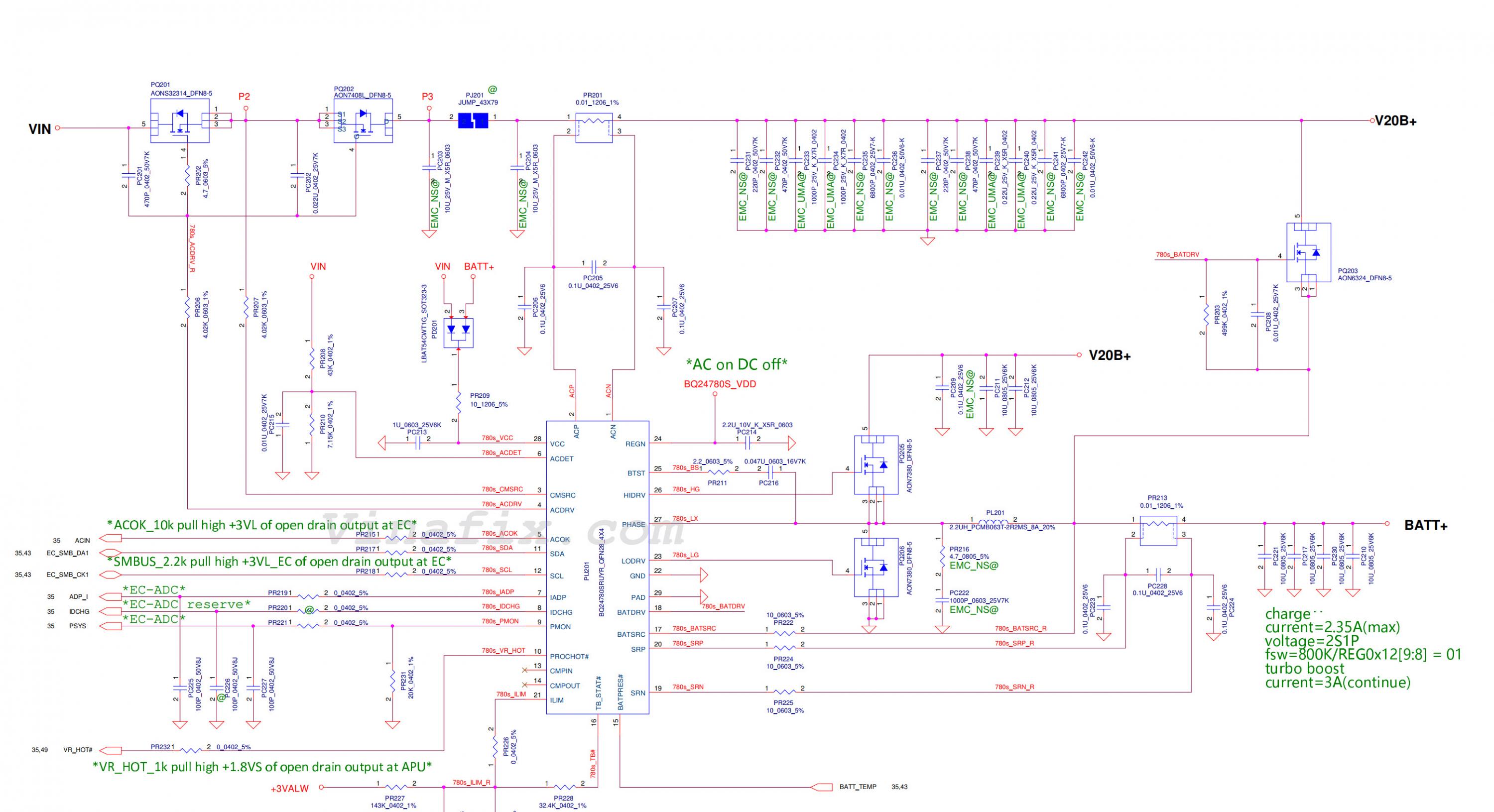

                          I also missed the low voltage on pin # 3 (CMSRC). Mosfet # 1 is a suspect.
                          Attached is a typical hookup of this charger IC.

                            So with AC connected?
                            • mon2
                              • Dec 2019
                              • 13887
                              #54
                              Yes, with the adapter connected.
                              After the voltage check, remove all power.
                              Measure the resistance of the same mosfet:

                                Here you go.

                                  What is the gate voltage to ground on this mosfet with the adapter connected?

                                    0.58v
