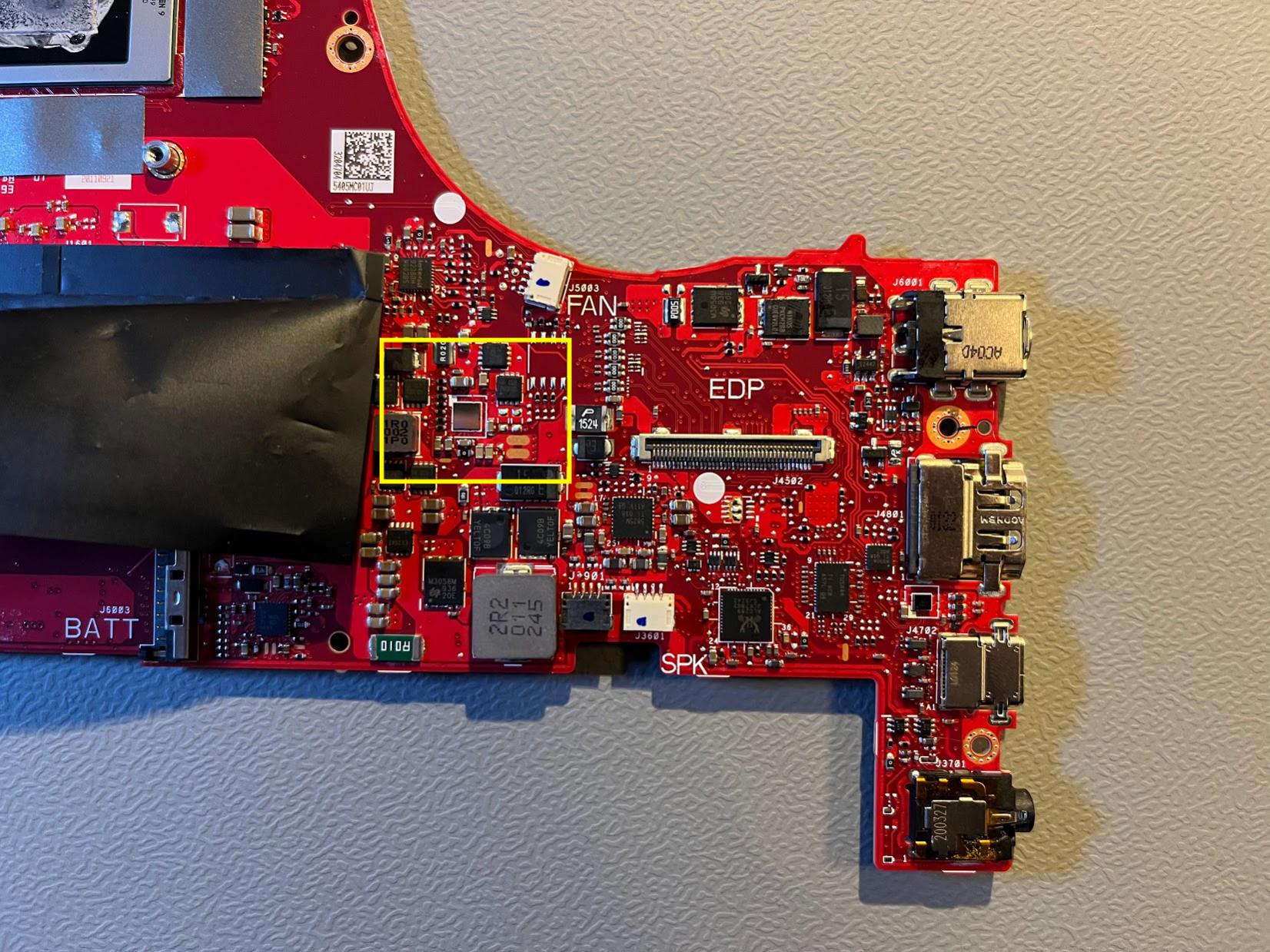

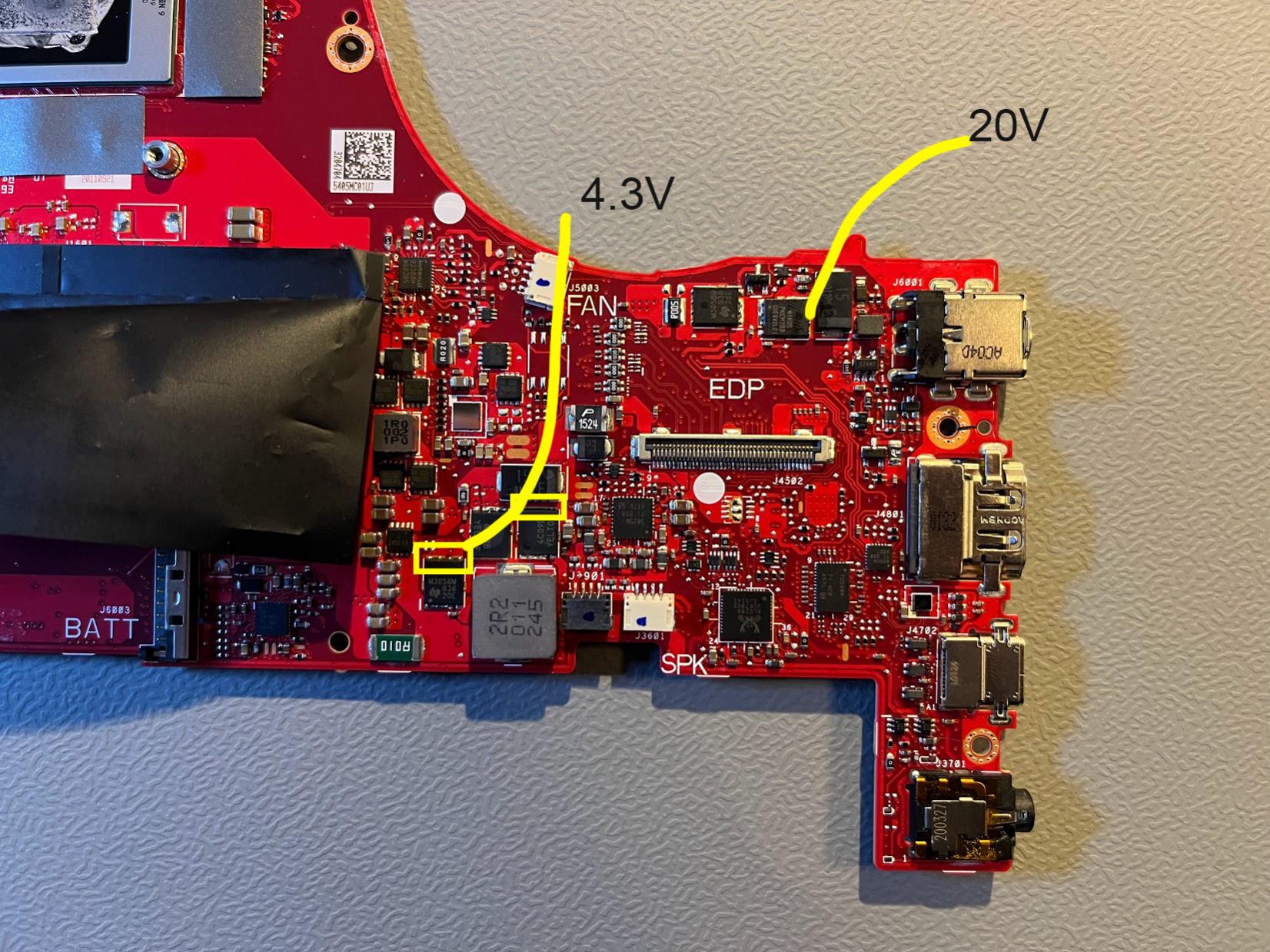

    Hi!
    It seems like all the laptops I get are dead G14's. I already had two, in which one was fixable, and one wasn't. This one is different though, I promise!
    The previous owner used it without a screen, as the panel was dead, and suddenly it just died.
    The board looks fine, no visually burnt components as I can see.
    I do not get a short on the DC-In mosfets, however as I had with one of my other machines, the first mosfet does not seem to let voltage through, so the second mosfet does not receive 20V. (See pic).

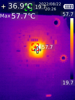

    Only the BQ chip gets a little warm when the board is plugged in, nothing else.

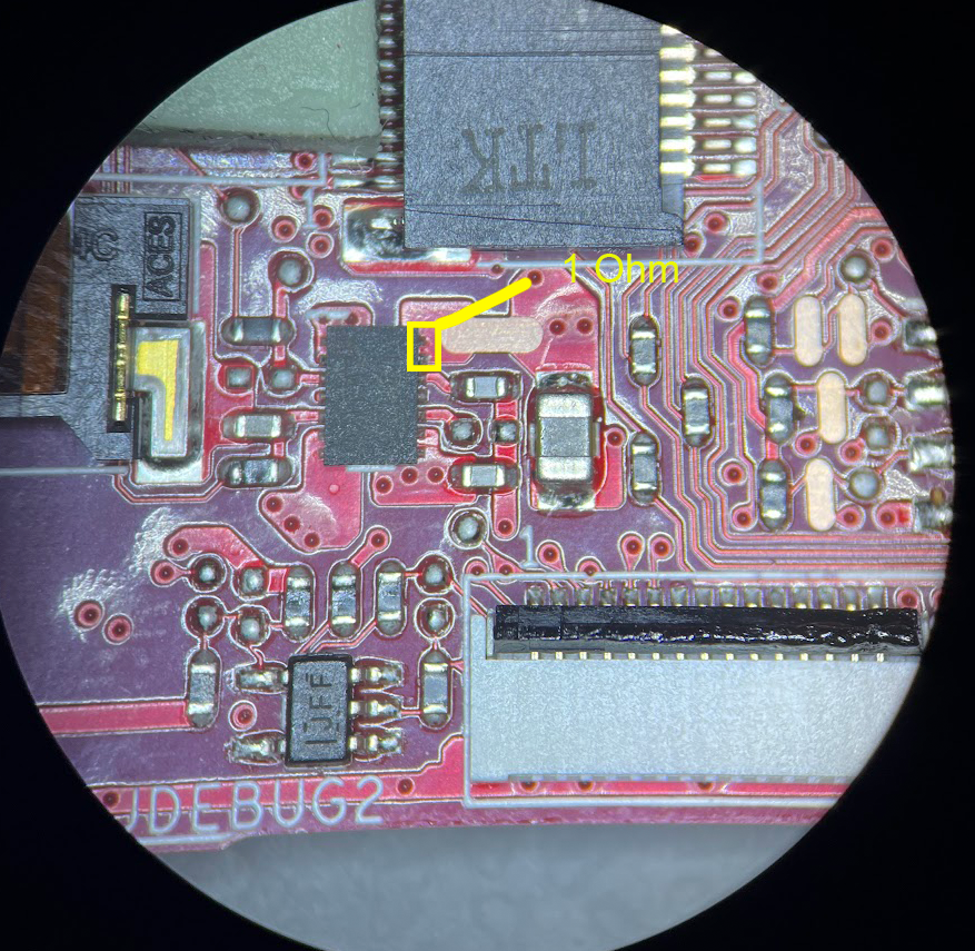

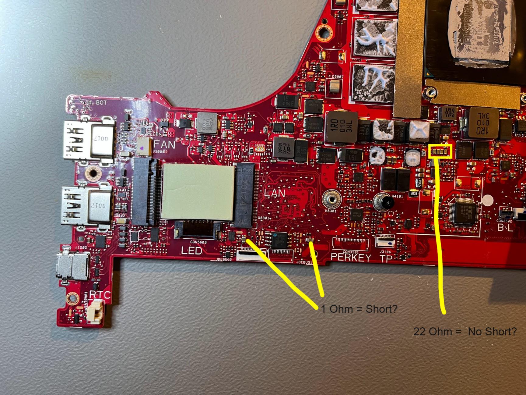

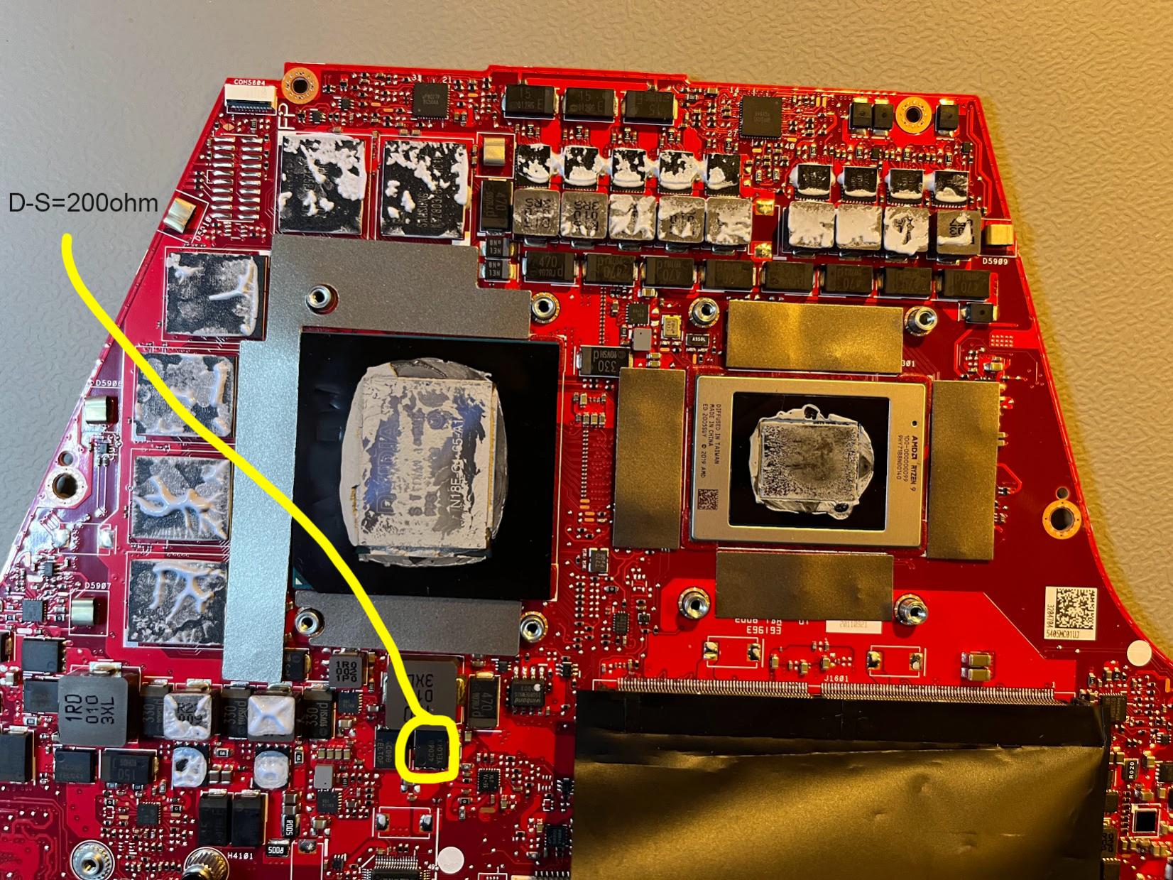

    I believe I detect a short around the caps at the bios chip (1 Ohm), not sure if they should be that low. I removed the bios chip, but reading is still as low.
    Caps at GPU area are 22 Ohm, so they are probably not short.
    All Mosfets measure in the K or MOhm range, except one, which is 200 Ohm at D-S, so not really sure what is going on there.
    I would have hoped that a completely dead PC would mean an obvious short somewhere, but nope
    The other G14 I had, had sign of life with USB-C charging, but this one seems dead.

    I injected 1V1A into the cap on the right of the bios chip which were 1 Ohm. The IT5125VG-128 IC on the back side got hot, could this be the culprit?

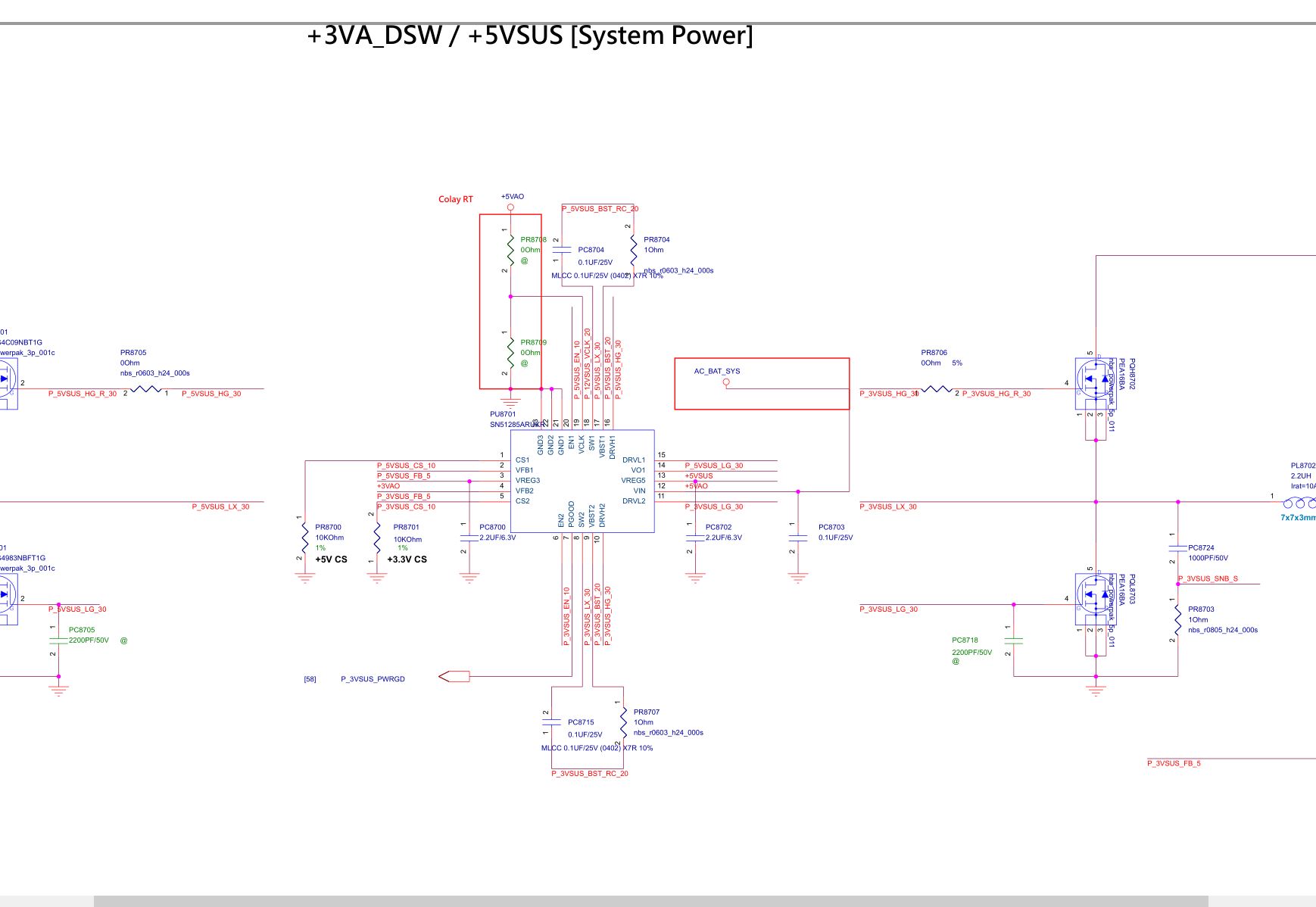

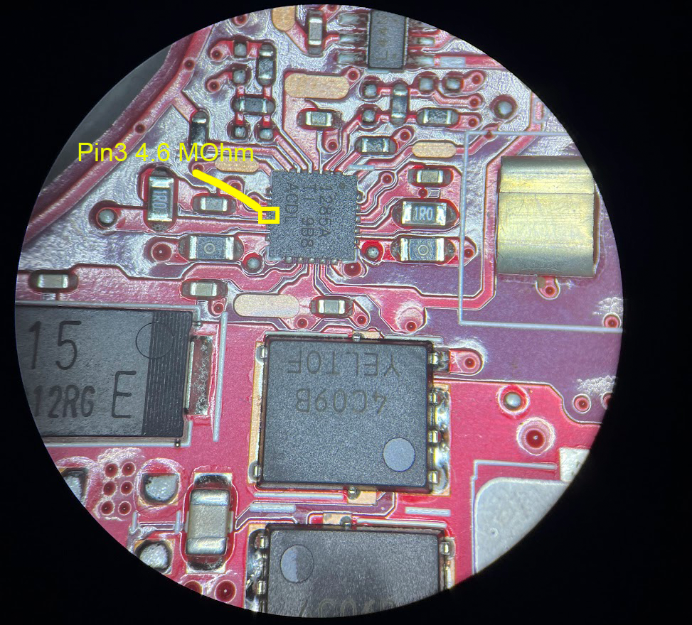

          I found this in the schematic, not sure if this is the 3V3 though. Having a hard time finding what makes 3V3...
          Im new

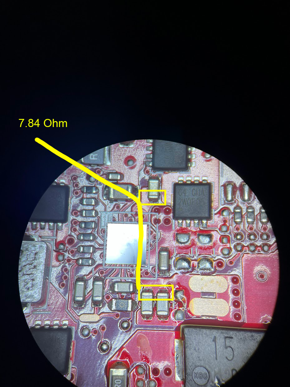

          EDIT: Also, some caps are very low resistance right above the lower mosfets.

              It's a convoluted design compared to most other laptops and I'm still scratching my head a little following what should be a simple path for powering the EC.
              +3VAO/+3VA (pin 3 of PU8701) is your LDO voltage. However +3VA_EC goes via load switch (PU8801) so if it's shorted it might read it on the other side of that load switch. So check resistance to ground for +3VA and +3VA_EC. Pg 101 has the power sequence diagram for further troubleshooting.
                Thanks for you support! Yeah, the schematics are not easy to figure out.
                I checked both Pin 3 on PU8701, it was 4.6 MOhm to ground.
                I checked VOUT1_1 (Pin 13) on PU8801, and it was 1 Ohm to ground.
                How would I use the power sequence diagram? I guess it is for knowing the starting sequence of the components at boot, but how would that help me?
                Thanks!

                  Based on your previous post, that does sound like a shorted EC (U3001). You can use 1V voltage injection and thermal camera to confirm. Removing U3001 would be the next step to see if the short is gone.
                  No datasheets available for IT5125VG-128/CX, however the 128 suggests that it has 128k of ROM. Some EC's when empty download their code from the main BIOS chip automatically. Given I can't see any EC dumps on the web for this model seems to indicate that this is likely the case.

                    I injected voltage here (see pic).
                    How often do EC's die though? I am fearing that it is something else that is shorting the EC.
                    Yes, as I have reseached, especially Asus downloads to EC from BIOS at boot.

                              Removed the EC, and the cap that previously measured 1 Ohm, now measures 10 kOhm!
                              Is it safe to say that the EC was at fault? The EC is 20USD from Aliexpress, so I want to be somewhat safe before ordering one
                              Also, I guess that I should not connect power to the board without the EC, correct?
                              Thanks for your help!

                                  yes, then it was at least ONE fault. there could be more. nice job . mostly it is not safe to connect power to a board without controller ics... but in most cases the board will be just brain dead and that's it.

                                    Yes EC is shorted, replacement should theoretically come pre-balled. I personally wouldn't power the board without it fitted.
                                    Replacement needs to be blank or off a donor board (of the same model) as well. I ran into some issues transplanting an EC with different programming once. I didn't have a 128 pin ZIF adaptor and thought I could reprogram it via the keyboard connector. Well it didn't end well and I won't be doing that again. To date, I've not seen any programming adaptor for the 128 pin BGA EC's.
