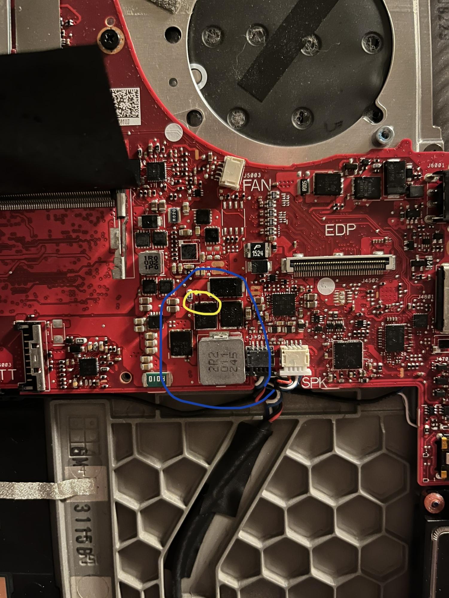

    Im sorry if this is a stupid question, but is this side ground? It measures 0.12 ohm, but the ?diode? Right above measures 20V on one side and 0V on the other… It just seems like the area marked with blue does not turn on, all measure 0-0.2V when plugged in and does not change when power button is pushed.

      It is GND and the "diode" is probably a Capacitor. Maybe we are on something with the 1.2V there, though. Detailed inspection of the circuit necessary, but not today (at least for me^^)

        Alright, but I am guessing 0.2V isn't normal either, right?

          I strongly suggest to forget this area immediately. That's for battery charging and has nothing to do with your issue. Voltage without battery present is useless and meaningless.
          Edit: except you measure a short to GND at the coil.

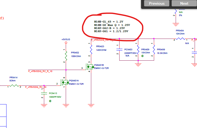

              Is this the expected voltage for VRAM described in the schematic? Page 78.

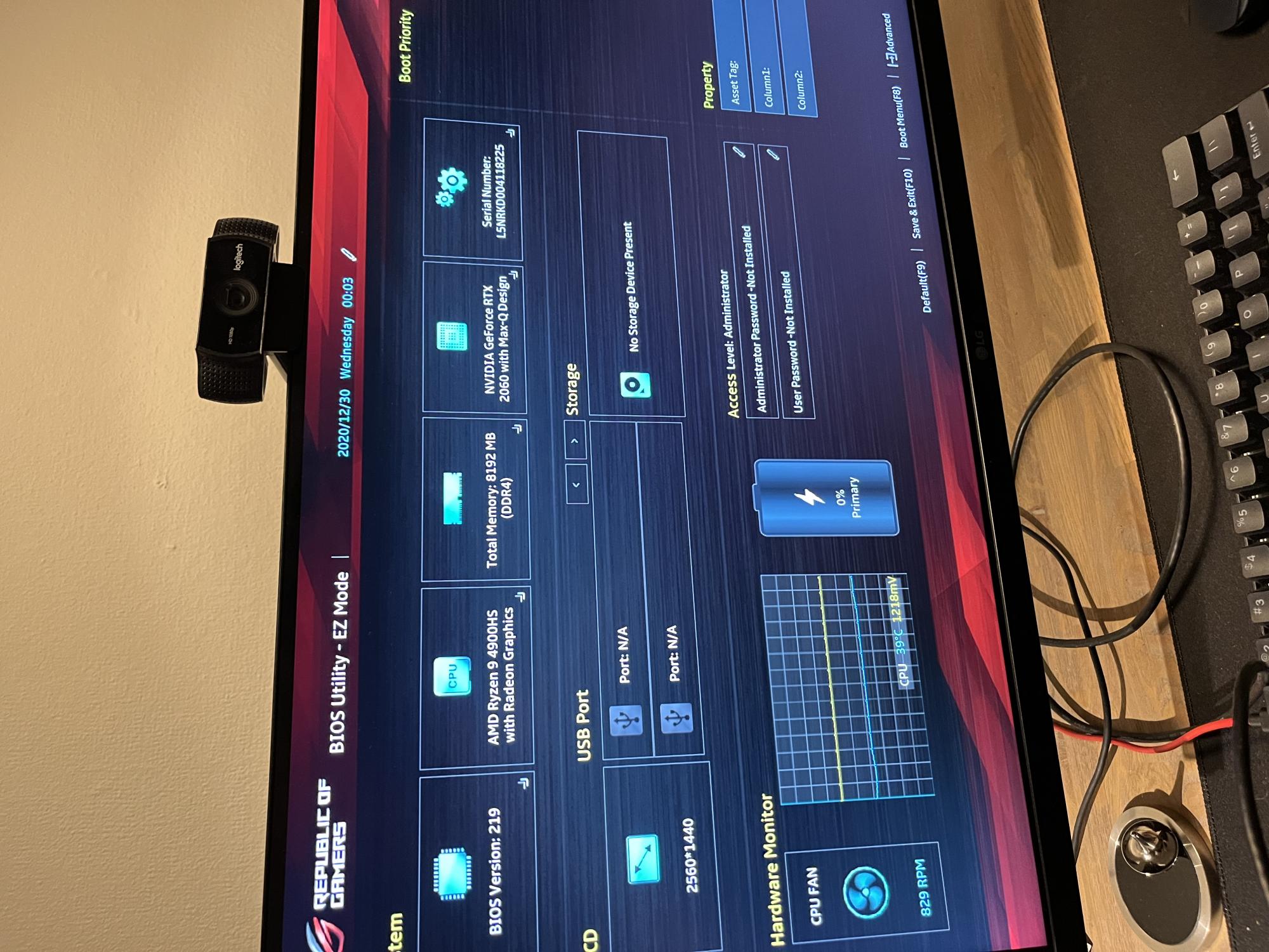

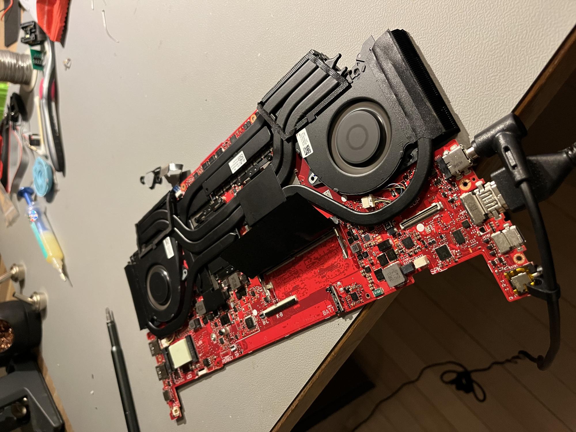

                Great success! New BIOS fixed it! Got it all stripped down to test, but it outputs display!
                Now to figure out if the battery is salvable. I've had three generations of these G14, and common for them all is that they lock/kill the battery if anything happens with the board...

                  Good to know, the thing you pointed out in the schematics is just feedback Reference voltage and has nothing ro do with the actual output of the Phase anyway.
                  Now I'd be happy if the issues stop from now on...

                    Got Windows installed, and everything seems to work but the battery, so I will have to look into that... Have you had any luck unlocking batteries?

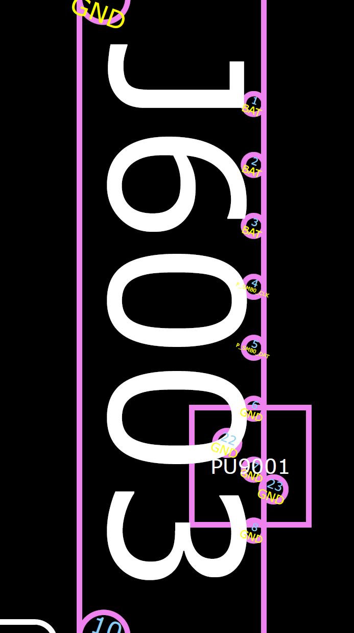

                              BATPRES is an active LOW signal. So when the battery is present, this pin should be low = 0 volts.
                              Remove the battery and this voltage should become a logic high value. Confirm it.
                              Measure the voltage to ground of each pin on the battery connector.
                              Post all measurements.

                                #115
                                Re: Dead ASUS ROG G14 (GA401)
                                BATPRES is still low (0V) without battery.
                                All battery pins on board measure 0V.

                                    We are interested in the diode mode readings of pin #3 and pin #4 of the battery connector. Again, disconnect the battery during these checks.
                                    Pins #3 & #4 are the smbus SCL and SDA pins on the battery. We are checking if the ESD diodes at D5902 and D5903 are ok or if there are damaged from an ESD transient event.
                                        Do you mean Pin #4 & #5? Pin #3 is a BAT+ line.
                                        Pin #4 (CLK) reads OL
                                        Pin #5 (DAT) reads 0.5V
