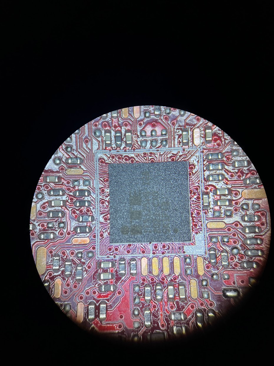

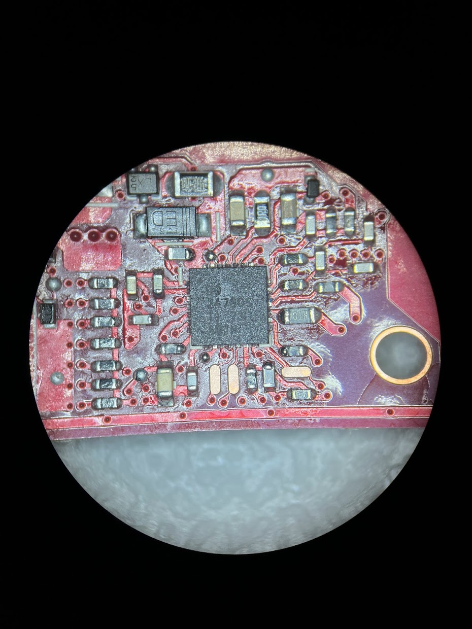

            #65
            Re: Dead ASUS ROG G14 (GA401)
            Originally posted by Sephir0th
            I don't know. A few pics of alle the jobs you have done on this board so far would be nice.
            Alright,
            First I found a couple shorted caps around the BIOS chip (2 Ohm), removed it, but the short was still present. I resoldered it and injected 1V1A at one of the shorted caps, and saw the EC IC get hot. Removed the EC and found the short was gone. Ordered a new EC IC and soldered it, short was still gone.
            Installed the board again, but still no sign of life.
            I then replaced the BQ IC, still no life. I replaced the second DC-In mosfet, still no life.
            That is pretty much what I have done.

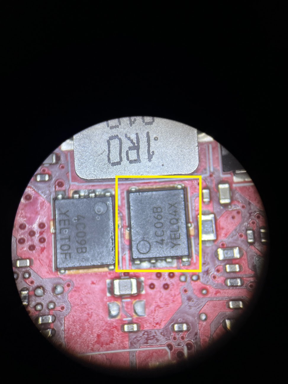

              • jacobtc
                • Apr 2016
                • 274
                • Denmark
                #67
                My suggestion would be to check both mosfets again a) for internal short and b) for unexpected short to GND at either Source, Drain or Gate. Without power of course.
                Then a updated voltage measurement of the charging controller would be nice, Pin 4, 5, 6, 24, 28. Then remove power and switch to beep mode. Check any of the 28 pins for unexpected short to GND.
                Then report back here
                Thanks, sorry for late response.
                I did some measurements, see pic.
                I also changed the BQ again, no change.

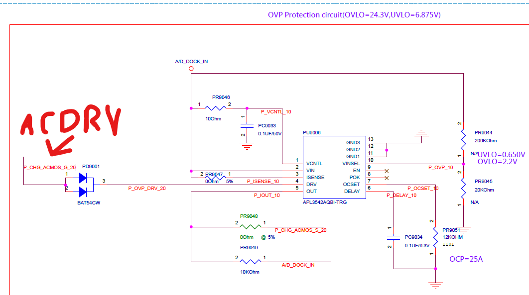

                              #74
                              Everything looks normal, except ACDRV not coming up. Since this component connects to ACDRV line i strongly suspect it to be the culprit here.
                              Are you able to trace where else it connects to?
                              FairRepair on YouTube
                              • Sephir0th
                                • Oct 2020
                                • 1262
                                #75
                                Look, what i've found in the schematics of a ASUS GX531GS. Same charging IC and this extended ACDRV circuit. Maybe i'm wrong, but if this is a faulty diode, you should get ACDRV back as soon as you have removed it.
                                Check, try and report please.

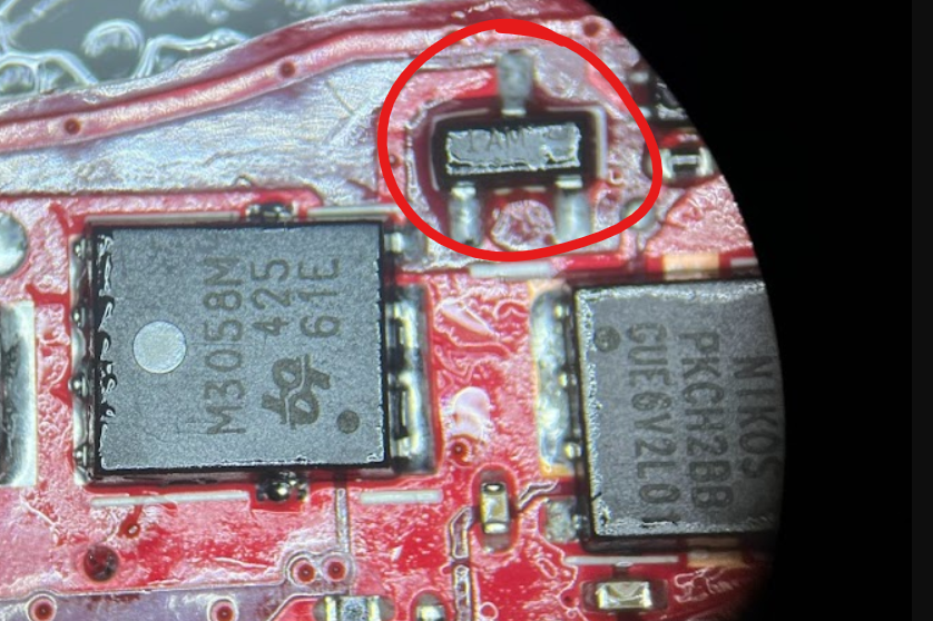

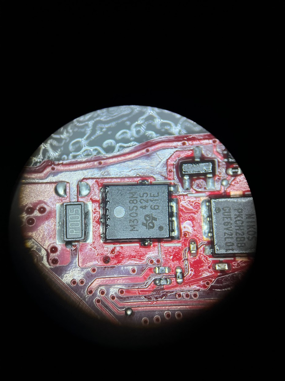

                                    #77
                                    This is the one, should I remote it and connect power?
                                    It's a transistor.
                                    I also uploaded a screenshot of the ACDRV path...
                                    • Sephir0th
                                      • Oct 2020
                                      • 1262
                                      #78
                                      It's a transistor.
                                      It is not a diode, but basically does the same like in previous shared schematics.
                                      so yes, remove it and see what happens. You'll lose the overvoltage(?) protection then, ofc... but that's a secondary issue right now...

                                        #79
                                        Alright, ACDRV is now 1.2V!
                                        DC-in mosfets are still low, 1.2V output from the first and 4V from the second.
                                        • Sephir0th
                                          • Oct 2020
                                          • 1262
                                          #80
                                          This is so weird. Check the Mosfets again for internal short, for sanity
                                          And then place the component back and check voltage at all three pins pls.
