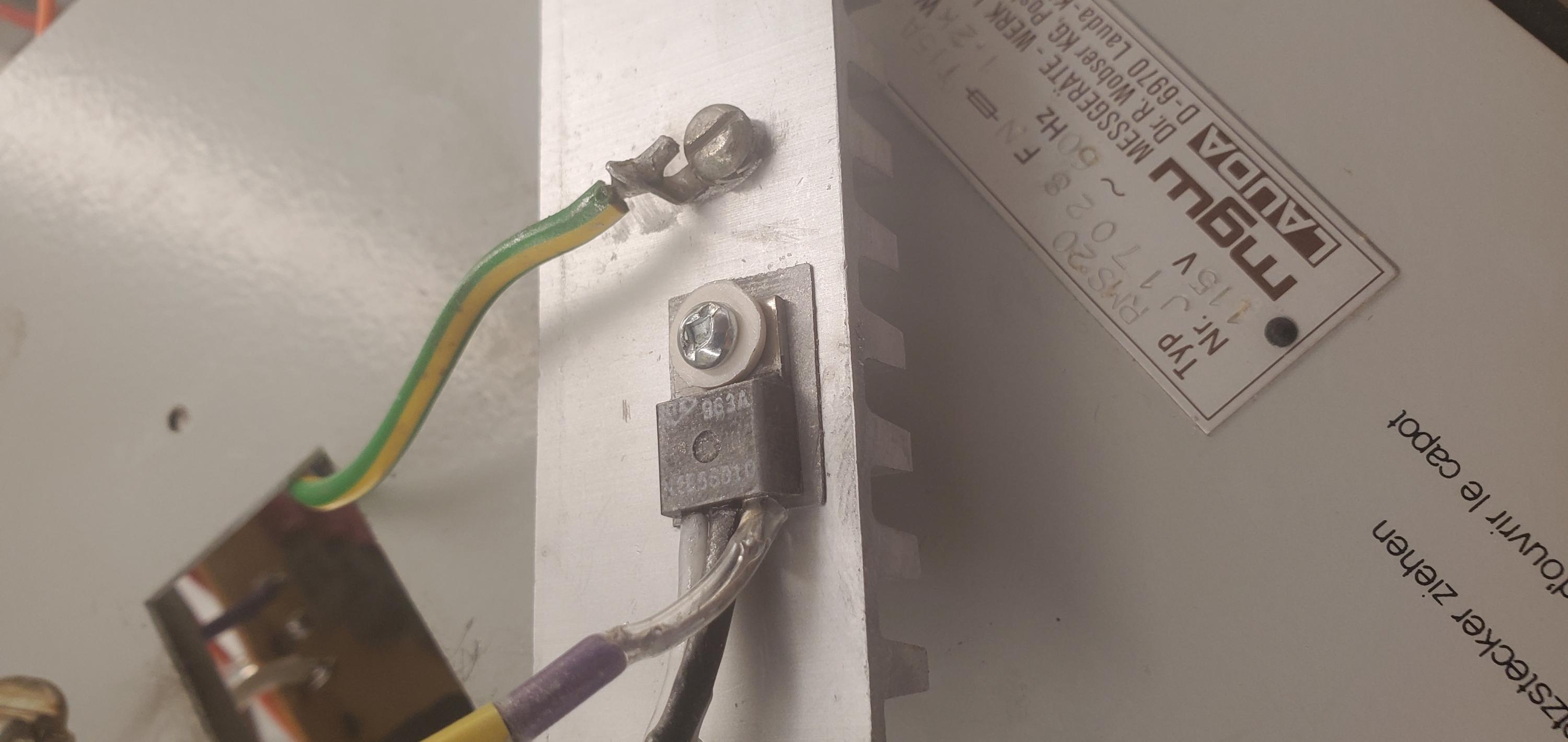

          I think I finally got to the bottom of this.
          I plugged the waterbath to the wall (no bulb in series) and got a short on MT1. The 15A fuse didn't even blow but the circuit breaker of the laboratory did. I thought the fuse would blow before the circuit breaker. I don't know why that was not the case. Anyways, I decided to remove the TRIAC from the heatsink and left it hanging without touching anything. Then I turned the waterbath on and this time there was no short and the lamp in place of the heating element turned on.
          I then put the TRIAC back on the heatsink, this time with two mica. Now everything seems to be working fine (lamp turns on). I have no tried it with the heating element yet.

              Sigh...so it turns out something silly... If we can't trust measurements, what can we trust...
              dirty probes? Probes have sharp points for a reason - to dig through thin oxide layers.
              Using two insulators, though better electrically, is significantly worse thermally. Usually TO-220s can handle at most about 2W without a heatsink. For TRIACs this means you can pass about 2A before you fry it when not attached to a heatsink.
              Also are you using conductive thermal paste? Don't, or don't bother with thermal paste at all. Wish I could trade you this ZnO heatsink compound I have, I'm still waiting for "gray" heatsink compound to see if it's better for my CPUs...

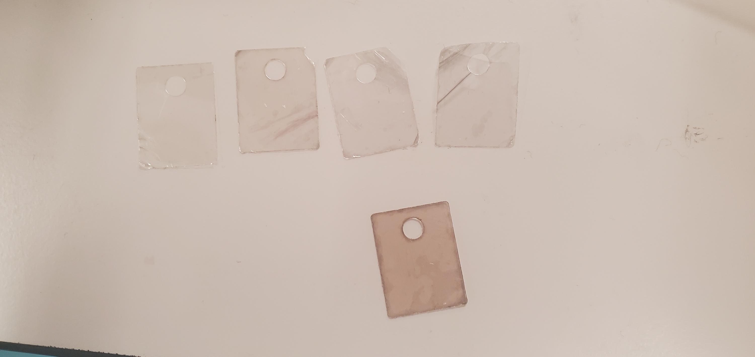

                That transparent mica that comes with the TRIAC is not enough, or no good. I ll try with just the other mica that I bought separately instead of both.

                  If you perhaps created some shrapnel that could have pierced through the insulator, but I've never had this happen. Never had a TO220 short with the heatsink when I have all the correct hardware installed.
                  As petehall347, you might have to end up selecting a new, clean site. But try with no heatsink compound unless it's known to be insulating (like "White" ZnO) first. Use the sharp probes to scratch into the paint and oxide coatings on metals to ensure you get a good contact.

                          new hole is unlikely going to fix the problem.
                          BTW that plastic shoulder washer... if you're screwing the screw in, the screw is too big. The screw should slide into the plastic.
                          The screw screws into the heatsink so it will be grounded. The heatsink should have an small air gap or the insulator material between it and the metal tab.

                            Mica is clear, brittle, and cleaves little shards. Kapton is orange and flexible. Silicone is gray and rubbery.
                            Again use the sharp points of the multimeter in the highest resistance range to check the dielectric. Make sure your meter is actually working too... Scrape the top side of the metal tab of the TRIAC and check against the screw.

                              I just got back from the store with some NTE ZnO thermal compound, a few mica (they re thicker than the one provided with the TRIAC), and while I was there I also got some more washers. I love this store - they have everything!
                              The plastic washer I have works fine, it slides into the screw like you said. The screw didn't touch the TRIAC at all. I think everything was correctly assembled so it has to be something with the thermal paste or a damaged mica.
                              With all of this, I should be good to go. I'll clean the heatsink of the old thermal compound, scrub it with the scotch-brite pad, and assemble it all.

                                    I was going to mount the TRIAC with the new thicker mica I got. However, I can peel the layers off. I initially thought that there was a sticky part to stick to the TRIAC or something like that but below each peeled layer was another layer that is easily peeled. I added a photo below with a "full" mica and one peeled into it's layers. Anyways, not knowing if this was normal, I decided to use the other isolator I have which I believe is Silicone or Kapton.
                                    I cleaned off the surface of the TRIAC and heatsink and used the new washers I got. Checked for resistance, everything was good (max resistance between the metal tab and heatsink/scew). Turned everything on and it worked!

                                      No you don't want to peel mica, it's one of the characteristics that it can be split very thinly. And no there's no adhesive layer. Though thinness helps heat conduction, it also encourages shorts so you want to use full thickness. And peeling it, as you assumed, ruins it - so don't use the peeled version.
