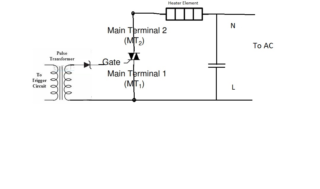

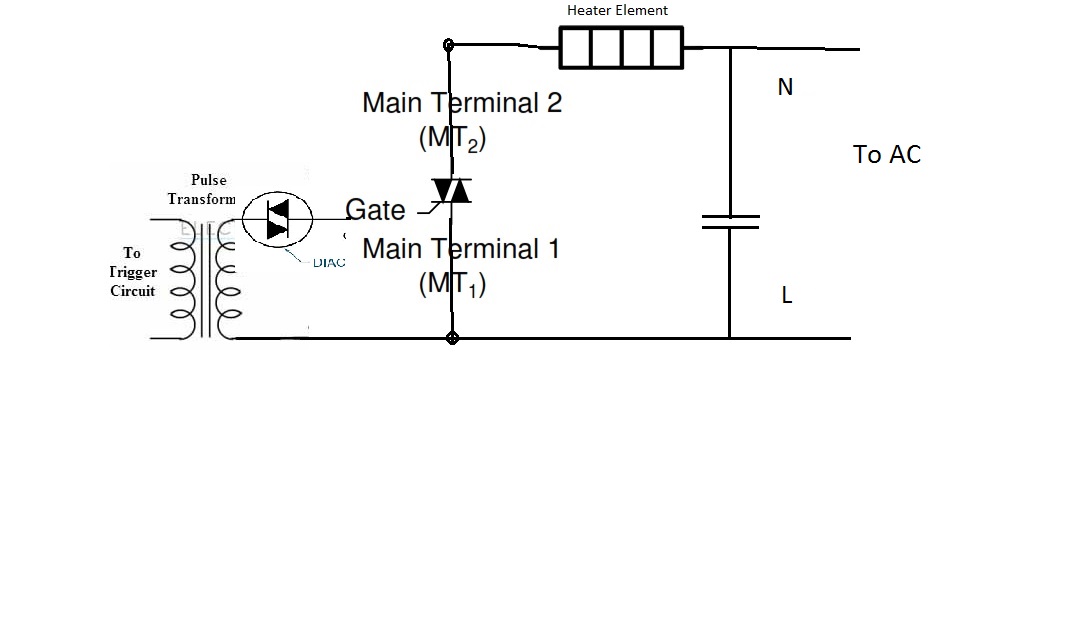

      Based on what you said, this seems to be the configuration. You say 2 zener? are there 2 zeners? or only the one?
      It is possible it is not a zener but a diac

        Yes I think that's exactly it!

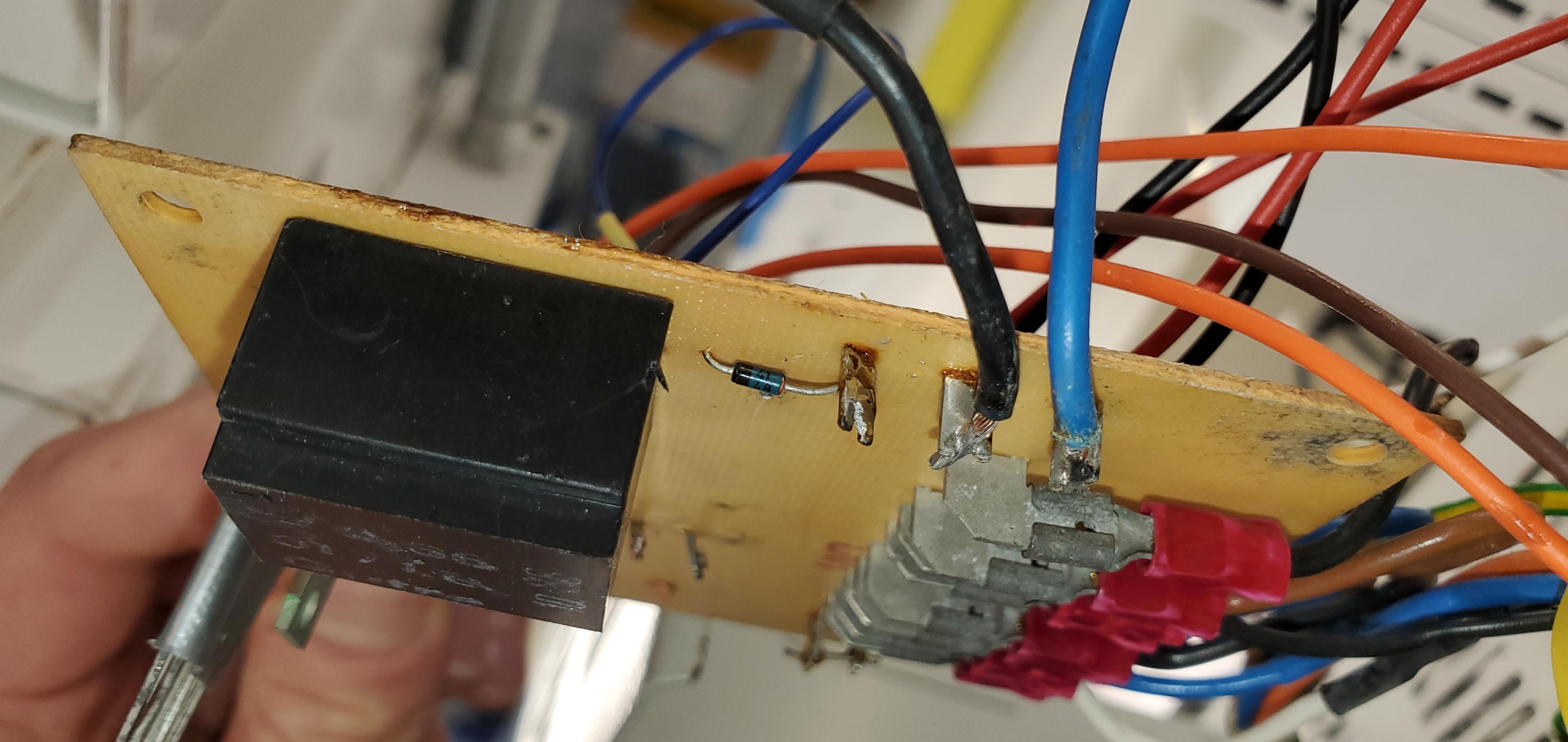

        This is what there is between the transformer pin and Gate. It looks like it's touching that terminal in the photo but its not. It connects to the gate on the other side. There is another one between the two primary pins too ( so where you wrote "to trigger circuit").

          That other one might actually be a zener. There is 0.5v across.

            That is just a 1N4148 small signal diode, neither a zener or a diac

                Definitely not DIAC, DIACs do not have bands on them.
                Yes that transformer is there solely for isolation. The whole design probably could be made one heck of a lot simpler with a MOC3041 but probably designed with NIHism...
