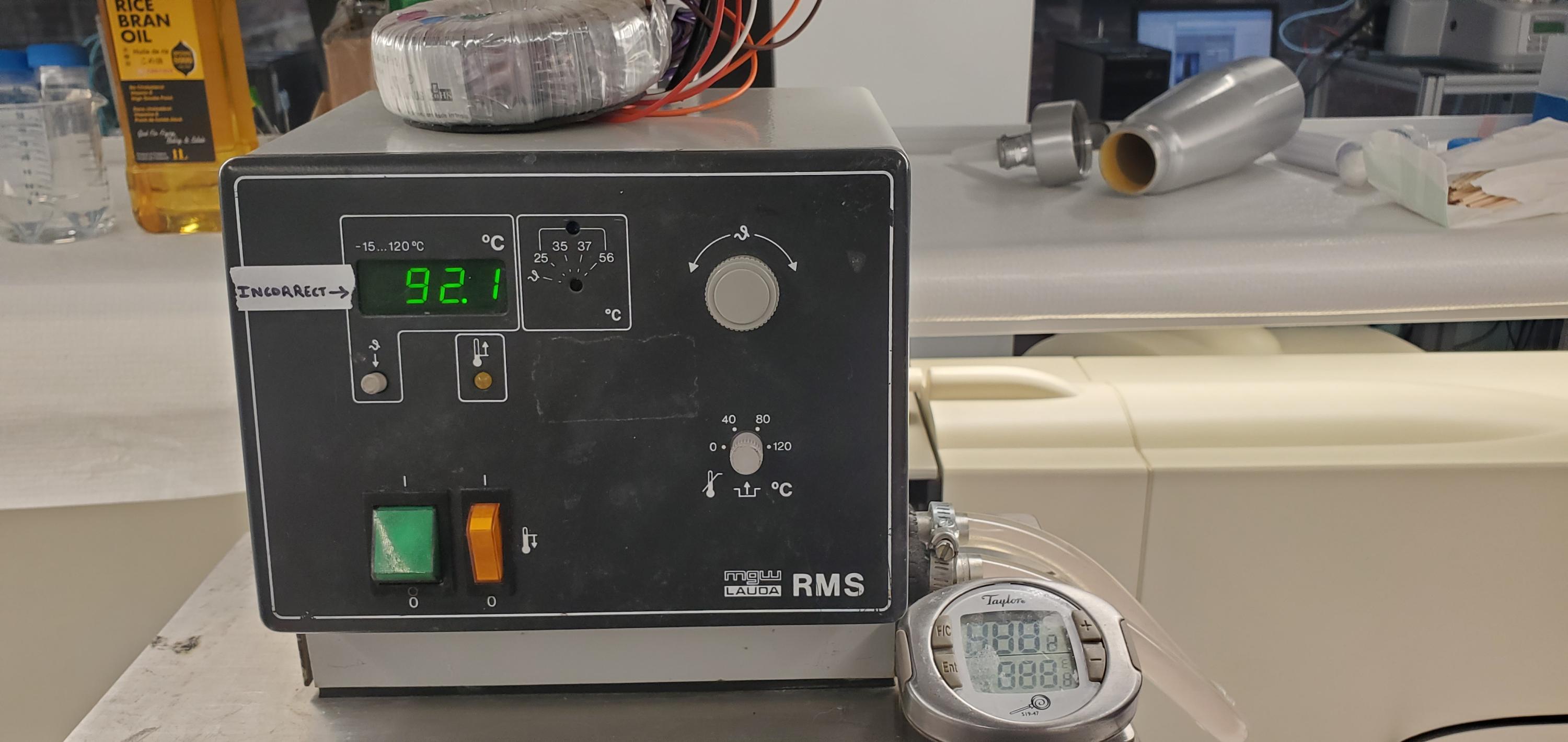

              My new issue now is with the display. I get the correct temperature displayed when I turn on the waterbath. Then when I press the button to set the temp using the potentiometer, it shows random numbers constantly changing. It should show me the set temp and let me change it. When I release the button to go back to the current waterbath temp the values are not correct. Adjusting the potentiometer increases/decreases the number so that seems to work.
              Turning the waterbath off and on goes back to giving me the correct temperature readings on the display.
              I replaced the ICL a while ago. It wasn't easy installing it because it is so long and I had issues melting all the pads at the same time to insert it. As a result, most pins inserted through the holes as they should. a few pins did not go through and bent (like 3 pins I think). I put solder on those and made sure there was continuity between the pin and the pad on the other side of the board. I think it should be good but I ll double check.
              I suspect the issue has to do with the long pins from the display board into the LED board. I had issues with the pins from the other boards and ended up removing them and putting wires instead. I dont think I have space to do that in this case. I m gonna try tinning the pins to increase their thickness and improve contact. I m open to any advice you guys may have.
              Thank you!

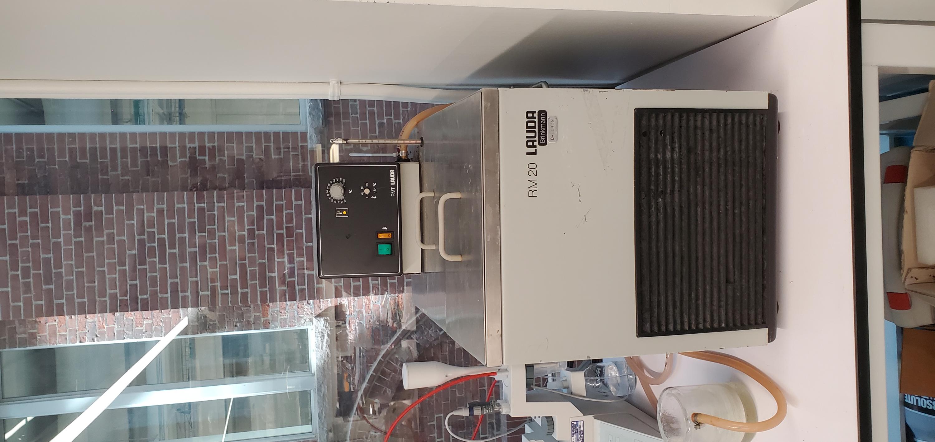

                  I decided to reassemble everything. I couldn't figure out why the display is showing the wrong temperatures. I checked all the connections and it all seems to be good. Maybe the ICL needs to be replaced again, or the op amp. I don't fully understand how this works so it would take me a lot of time to investigate this issue. I ve decided it doesn't matter. The waterbath works, the temperature can be controlled, and I ve added a thermometer in there to get the actual temperature (2nd picture, bottom right).
                  Yesterday, I had to open the other waterbath we have (RM20, 1st picture). It's the same brand but a different model (the one I ve been working on is a RMS20). I looked at the TRIAC and noticed it doesn't have a mica but it has a washer. I remembered that when I first opened the RMS20 I did not see a mica. I put 2 and 2 together and realized the reason why I was not getting continuity with the heatsink was because it has an insulating layer on it (the 2 waterbaths have the same heatsink). So no mica needed. The TRIAC only has a washer because the screw makes contact with the exposed conductive part of the heatsink inside it. All these TRIACs I blew were likely due to the washer or screws (maybe size or not well assembled). Anyways, I had an "aha" moment when I saw there was no mica in the RM20.
                  I ve added a picture of the RM20 (1st picture). As you can see there is no display on this model, just a knob with temperatures. How complicated would it be to install a knob like this?
                  Thank you!

                    Here is a website link where you can find temperature controllers
                    https://www.ebay.com/sch/i.html?_fro...oller&_sacat=0
                    I hope this helps

                      Again it's still possible the voltages were not assigned properly at the transformer, however at this point with all the other damage on the board and their associated bodge fixes, I'm not sure where to start looking for problems...
                        Yes that makes sense. I m happy with the current way it works as it does everything it was built to do. Thank you for your help! I think this thread can finally go to sleep.
                        Thanks to everyone who helped.
