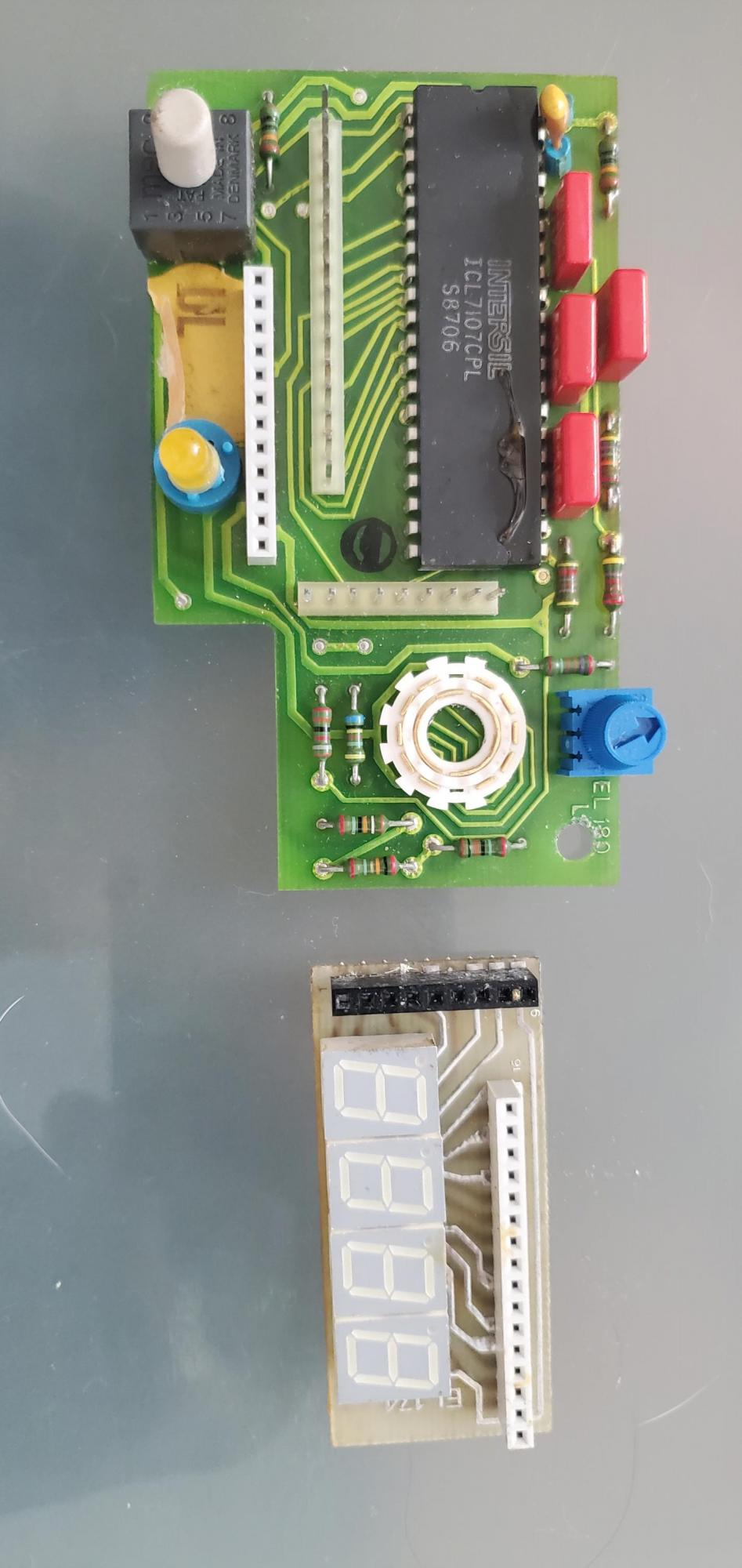

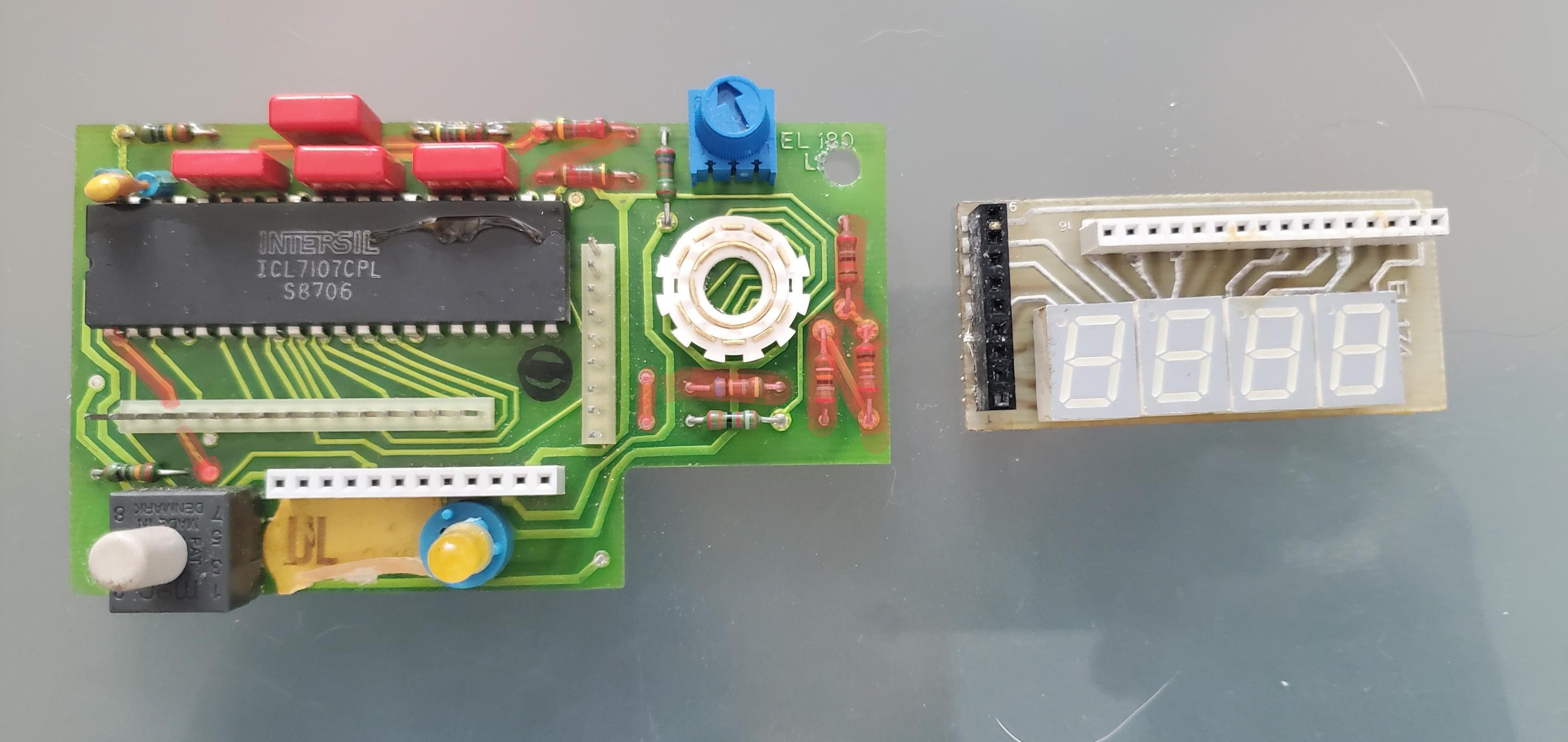

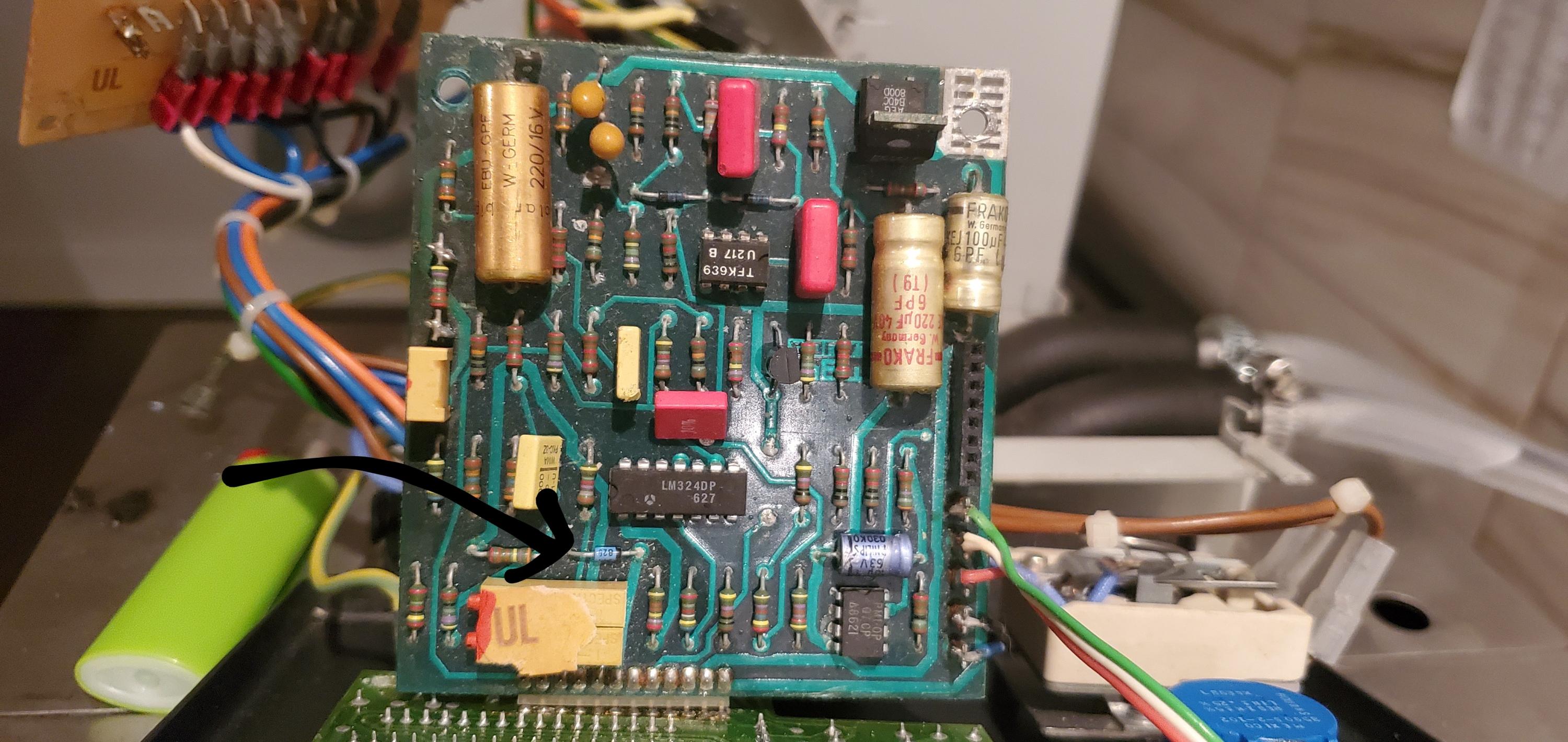

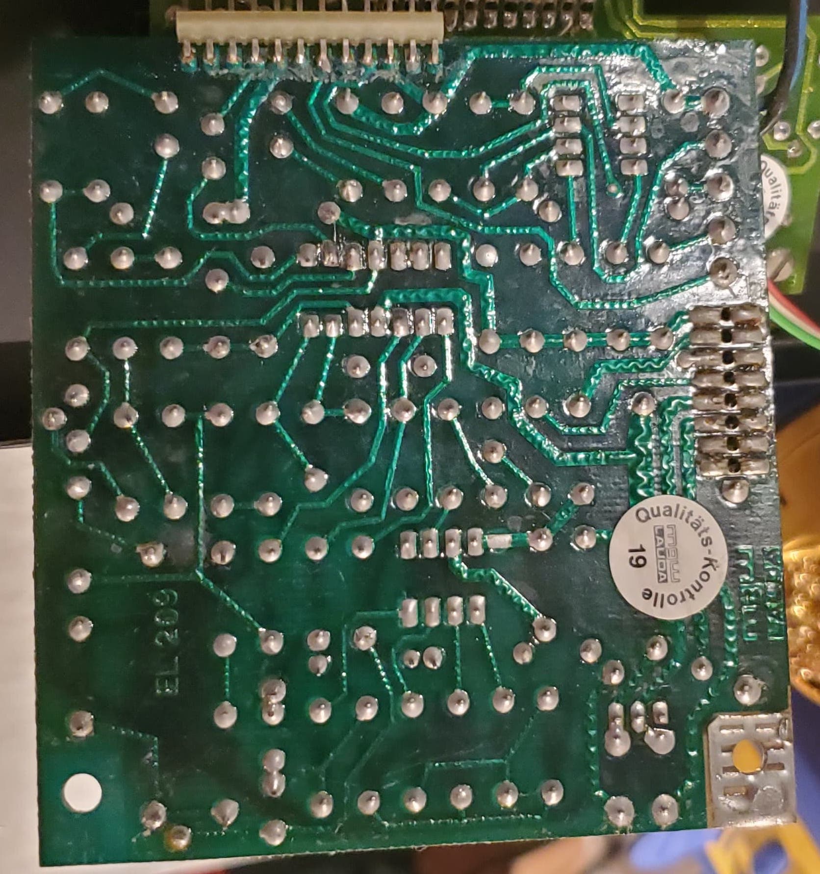

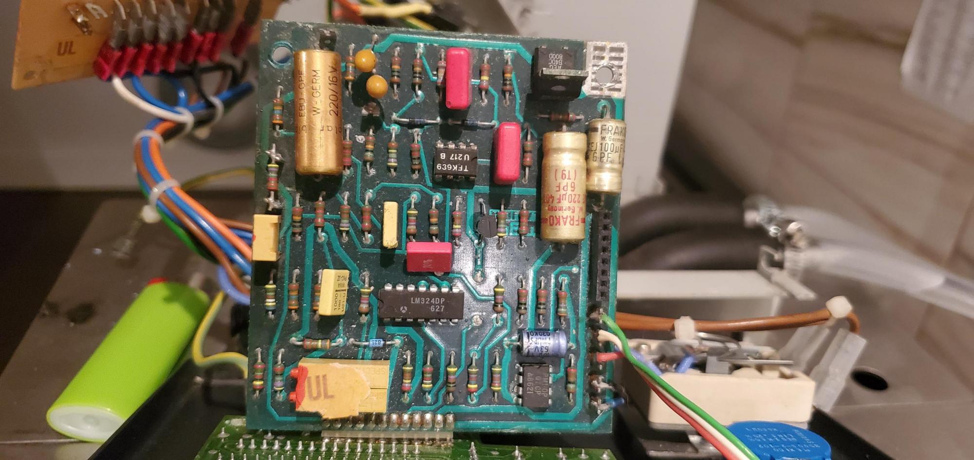

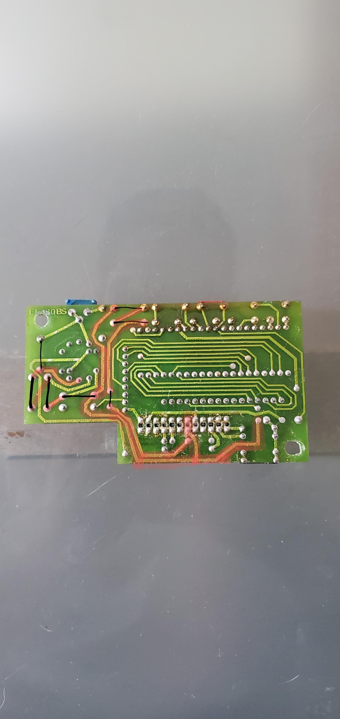

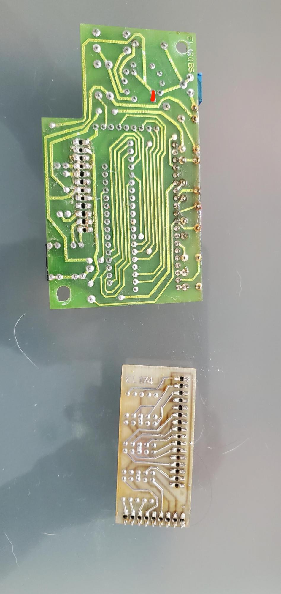

Fixing a laboratory waterbath
  • vrasp
    • Nov 2019
    • 194
    #141
    Re: Fixing a laboratory waterbath
    I set it to a bit over 50 °C. It heated up and stopped the correct temp with no issues. What should I do at this point? I m tempted to ignore the abnormaly (if it is abnormal) low current. I don't know what to put in place of the blown resistance.
    One thing I noticed is the heatsink of the triac gets very hot. Too hot to touch, but suppose that's normal.
    • petehall347
      • Jan 2015
      • 4451
      • United Kingdom
      #142
      Re: Fixing a laboratory waterbath
      cant see the pic very good . are you sure its not saying 100 milliamps ?
      • vrasp
        • Nov 2019
        • 194
        #143
        Re: Fixing a laboratory waterbath
        cant see the pic very good . are you sure its not saying 100 milliamps ?
        The meter is on the 20m setting and shows 0.10 so that should be 0.10 mA if i m not mistaken.
        • eccerr0r
          Solder Sloth
          • Nov 2012
          • 8715
          #144
          Re: Fixing a laboratory waterbath
          The LM324 sitting on the 12/20V wire has a quiescent supply current of a milliamp by itself so you're seeing something less than 1mA (= 1000µA), the op amp is not getting power. This says nothing about all the other stuff on that line that also needs power.
          • petehall347
            • Jan 2015
            • 4451
            • United Kingdom
            #145
            Re: Fixing a laboratory waterbath
            more than a resistor blown then ..maybe the fuse in the meter or leads in wrong holes or something silly like that . or meter is on dc amps ..
            • vrasp
              • Nov 2019
              • 194
              #146
              Re: Fixing a laboratory waterbath
              Originally posted by eccerr0r
              The LM324 sitting on the 12/20V wire has a quiescent supply current of a milliamp by itself so you're seeing something less than 1mA (= 1000µA), the op amp is not getting power. This says nothing about all the other stuff on that line that also needs power.
              more than a resistor blown then ..maybe the fuse in the meter or leads in wrong holes or something silly like that . or meter is on dc amps ..
              My apologies, it was in DC amps. I assumed AC or DC didn't matter since I was getting a reading. My multimeter also doesn't have AC amps. I borrowed one and measured again - the meter says about 75 mA.
              If this reading is correct, then going back to my previous calculations to drop 4v across a resistor, I would need 4/0.075 or about 53 Ohms. Should I try to see if there is something else fried or is 75 mA plausible?
              Last edited by vrasp; 06-20-2021, 07:05 PM.
              • vrasp
                • Nov 2019
                • 194
                #147
                Re: Fixing a laboratory waterbath
                I soldered a 50 ohm resistor. The voltage drop across the resistor is 2.9v. The current going through is therefore about 60 mA. I havent noticed anything wrong with the waterbath. It seems to be working fine.
                I will put everything back together tomorrow (carefully, unlike previous times), run it for a few hours, and see how it goes.
                Thanks a lot for your help guys!
                • vrasp
                  • Nov 2019
                  • 194
                  #148
                  Re: Fixing a laboratory waterbath
                  Today I put everything back together. I used the cooling option to bring the temp down to 5 degrees Celsius then heated up the water to 80 degrees celcius. It ran for over an hour with no issues. I think it s ready to go back to the lab.
                  Now I ve been asked to look at a laboratory grade oven. Apparently it s also an electrical issue. I ll start a new thread if I need some help (which will likely be the case).
                  I ve already said this but I m really grateful for your help. I have very little experience fixing electronics so this was new to me. I learned a lot! Thank you for your patience and guidance.
                  Last edited by vrasp; 06-22-2021, 06:56 PM.
                  • petehall347
                    • Jan 2015
                    • 4451
                    • United Kingdom
                    #149
                    Re: Fixing a laboratory waterbath
                    well done to all concerned .
                    • vrasp
                      • Nov 2019
                      • 194
                      #150
                      Re: Fixing a laboratory waterbath
                      Hey guys, I am back.. with an issue.
                      What happened:
                      The waterbath worked well for 2 days. I left it at 80 °C most of the day yesterday. As I was about to turn it off, I decided to press the cooling button. I had done that before without issues. This time, the display stopped working when I pressed it. When this button is activated, the cooling system (compressor amongst other things) is activated and creates some vibrations. No smoke or other relevant observations.
                      The details:
                      The waterbath still works. I can change the temperature. The water heats up. I can cool it using the cooling option. The LED on the display board works too (the yellow LED that indicates whether it is heating or reached chosen temperature).
                      What does not work is the display.
                      What I have done:
                      - I measured the current where I had put a 50-ohm resistor (before the bridge rectifier of the green/blue board). The last time, when it was working fine, I was getting around 75 mA. This time I m getting around 50 mA.
                      - I measured the voltages on the display board. It's getting 5-6v.
                      - I checked for a bad connection. I don't think there is any. Pocking stuff around did not make the display turn back on. There is continuity in all connections between the green/blue board and the display board.
                      I don't fully understand how the LM324DP and ICL7107SCPL work, but I think that LM324DP isn't related to the display. Since everything works fine except the display, I am tempted to say that it has to do with the ICL7107. Again, that's based on my basic understanding of the circuit.
                      Hopefully someone is able to give me a hint of what I can check with this information. How can I test ICL7107? What would you do at this point?
                      This is the most detailed schematic of the circuit (last page).
                      https://cdn.badcaps-static.com/pdfs/...78961c69cf.pdf
                      Thank you!
                      Last edited by vrasp; 06-24-2021, 10:14 PM.
                        • Jul 2011
                        • 6070
                        #151
                        Re: Fixing a laboratory waterbath
                        The ICL7107SCPL is nothing more that a voltage meter module you need to look at the data sheet for voltage in for the meter module to work and make sure you have voltage at these points that pins V+ which pin1 and V- pin26 ground pin is 21
                        Here is the data sheet website link
                        https://cdn.badcaps-static.com/pdfs/...7791fce5e7.pdf
                        You have to have a 5+ ground 5- for a power supply unless this unit has a negative power supply regulator ic chip
                        I hope this helps you
                        Last edited by sam_sam_sam; 06-25-2021, 09:14 PM.
                        • vrasp
                          • Nov 2019
                          • 194
                          #152
                          Re: Fixing a laboratory waterbath
                          Originally posted by sam_sam_sam
                          The ICL7107SCPL is nothing more that a voltage meter module you need to look at the data sheet for voltage in for the meter module to work and make sure you have voltage at these points that pins V+ which pin1 and V- pin26 ground pin is 21
                          Here is the data sheet website link
                          https://cdn.badcaps-static.com/pdfs/...7791fce5e7.pdf
                          You have to have a 5+ ground 5- for a power supply unless this unit has a negative power supply regulator ic chip
                          I hope this helps you
                          Thank you. I did check pin 1 earlier today and it had 0v. Injecting 5v turned on the display. I checked what the v+ is connected to and found a component that had 6v on its first pin but 0v on the other pin going to the ICL chip.
                          This is the component. It says 825 then A below it.
                          I think something is shorted to ground somewhere on this line.
                          • eccerr0r
                            Solder Sloth
                            • Nov 2012
                            • 8715
                            #153
                            Re: Fixing a laboratory waterbath
                            If you inject 5V and it turns on, and it's not drawing a lot of power, this line doesn't sound shorted, it sounds open, and isn't that connector a previous point of weakness?
                            • petehall347
                              • Jan 2015
                              • 4451
                              • United Kingdom
                              #154
                              Re: Fixing a laboratory waterbath
                              component looks like a 6.2v zener 500mw
                              • vrasp
                                • Nov 2019
                                • 194
                                #155
                                Re: Fixing a laboratory waterbath
                                I think the line has continuity though. I have to double check.
                                I injected 5v by using one if the LED power lines and connecting it directly to v+ of ICL. The display turns on, its dim, but it turns on. I dont know how much power it draws. I guess I could put my ammeter in there too.
                                My assumption was that the component I showed in the previous picture was broken. I put a wire instead to see what would happen but still 0v. However when nothing is connected, one pin has 6v. Wouldnt that mean that something is shirrer to ground?
                                I was going to check the other components on this line. This is the line.
                                The black lines mean there is a component on the other side.
                                Last edited by vrasp; 06-26-2021, 05:02 AM.
                                • petehall347
                                  • Jan 2015
                                  • 4451
                                  • United Kingdom
                                  #156
                                  Re: Fixing a laboratory waterbath
                                  never just bridge components if you don't know what they are .
                                  that zener is there for good reason . and most likely should read 6.2v right across it .
                                  • vrasp
                                    • Nov 2019
                                    • 194
                                    #157
                                    Re: Fixing a laboratory waterbath
                                    never just bridge components if you don't know what they are .
                                    that zener is there for good reason . and most likely should read 6.2v right across it .
                                    My bad. I first thought it was a tiny resistance and thought it wouldnt cause any issues.
                                    Yes, it read 6.2v on one pin but not on its pin going to the display. Do you think the zener is the issue?
                                    • vrasp
                                      • Nov 2019
                                      • 194
                                      #158
                                      Re: Fixing a laboratory waterbath
                                      My next step is to double check for continuity and if there is continuity, check each component on this line to make sure it s doing its job.
                                      • petehall347
                                        • Jan 2015
                                        • 4451
                                        • United Kingdom
                                        #159
                                        Re: Fixing a laboratory waterbath
                                        zener appears fine ,
                                        bridging resistors can also make bad things happen .. in fact bridging anything can ..just don't do it . test the suspects properly .
                                        • vrasp
                                          • Nov 2019
                                          • 194
                                          #160
                                          Re: Fixing a laboratory waterbath
                                          There is continuity from the output of the zener all the way to the v+ of ICL. The input of the zener has 6.2v and 0v on the output
                                          Last edited by vrasp; 06-26-2021, 08:05 AM.
                                          • learnmore
                                            Help choosing replacement transformer for Levoit 600S SMPS
                                            by learnmore
                                            Hello Community,
                                            I'm attempting to repair the SMPS on a Levoit 600S air purifier. The transformer is likely open. It has six pins. 2 pairs on the primary side (one pair tested open) and 1pair of legs on the secondary side. Legs on the secondary side are spread wide apart (end-to-end). I've circled them in blue. Dimentons of the transformer are 22x23mm. Marking on the transformer are EE16 1.9mH-B. Fuse for the powerboard is fuse 250V 3.15A. I've been unable to find an exact match and I'm hoping for some help here to find a suitable replacment.
                                            Peace
                                            LM...
                                            11-04-2025, 09:35 AM
                                          • ohren
                                            Original Xbox 1.0 PSU: Foxlink FTPS-0002 Rev. B. — 12 V low, 5 V high — transformer?
                                            by ohren
                                            Hello!
                                            I'm looking at an original Xbox PSU: Foxlink ftps-0002 rev. B. The 12 V output is too low, and the 5 V output is too (?) high. Unfortunately I don't have an oscilloscope but only a DMM for diagnosis.
                                            Measured voltages with no load:
                                            After rectifier diodes
                                            12V: 6.17 V
                                            5V: 5.67 V
                                            Secondary transformer pins AC measurement (really don't know if this says anything)
                                            12V: 2-2.5 V
                                            5V: 1.04 V
                                            I also have another (working) Xbox psu from Delta. The same measures there, in order, being: 10.79,...
                                            03-18-2023, 10:33 AM
                                          • mikey5791
                                            Is it possible for transformer substitution?
                                            by mikey5791
                                            Got this local made DC power supply (12/14V) given free as the transformer has melted. There is no marking or indication to identify what type or rating of transformer used.
                                            Fyi,. I had a busted autogate mainboard with transformer with marking 13-0-13 . Is this the 13v dc type transformer?
                                            My questions are
                                            1. How do i test to see if the transformer is in good working condition?
                                            2. Can this transformer (marking 13-0-13) be used to replace the melted transformer on the DC power supply?
                                            Hope you guys understand what i was asking. My intention is...
                                            11-03-2022, 02:11 AM
                                          • dennis_elx33
                                            3PHASE STEP-DOWN Transformer in Check
                                            by dennis_elx33
                                            Hello All,
                                            i would like to post an interesting topic regarding 3-phase stepdown transformer which we suspect to cause an overcurrent (138A) which resulted to power tripped off of the HV power supply (80KV output).
                                            Problem statement: Power tripped Off
                                            Initial Problem: Found 2 IGBT and 2 rectifier diodes shorted (burnt).
                                            Action Done:
                                            1) Replaced the faulty parts with good spare.
                                            2) Measured impedance of the 3phase input lines and found that L2 to L3 has 23.3ohm while other pairs are 51Kohm. This pins will...
                                            12-02-2024, 06:52 AM
                                            ASUS Transformer T101HA - X5DHD Hybrid (2-in-1) Book Specification for Upgrade or Repair
                                            This specification for the ASUS Transformer T101HA - X5DHD Hybrid (2-in-1) can be useful for upgrading or repairing a laptop that is not working. As a community we are working through our specifications to add valuable data like the T101HA - X5DHD boardview and T101HA - X5DHD schematic. Our users have donated over 1 million documents which are being added to the site. This page will be updated soon with additional information. Alternatively you can request additional help from our users directly on the relevant badcaps forum. Please note that we offer no warranties that any specification, datasheet,...
                                            09-06-2024, 04:40 PM
