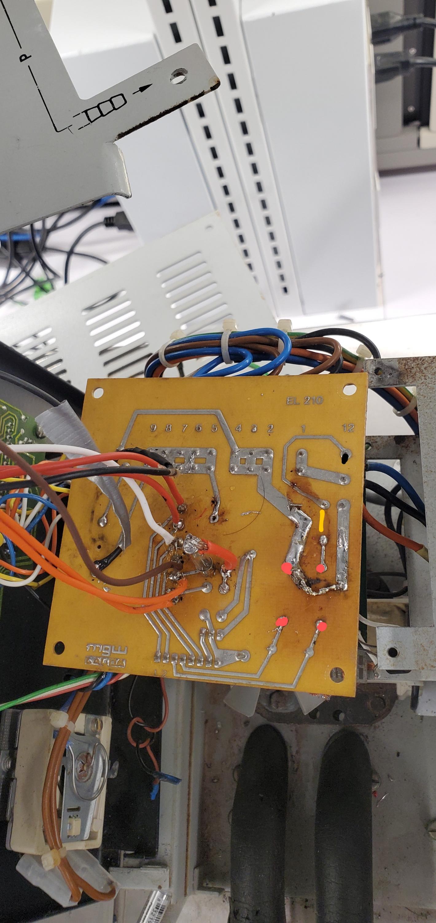

                            • vrasp
                              • Nov 2019
                              • 194
                              #234
                              Re: Fixing a laboratory waterbath
                              Originally posted by eccerr0r
                              BTW TRIAC terminals are MT1 and MT2 because they're pretty much symmetrical. Either way the metal tab is one of the two terminals, and neither are GND.
                              Brings back to the question why was the first triac replaced, nevermind the oops with the second one.
                              That was my mistake. The bath stopped heating after being on all day. I opened it up and noticed one of the cables that goes to the display was not on its pad anymore (these connections have been good since then, I redid them). I soldered it back then turned the bath on. That's when a short blew the TRIAC. I realized later that one of the terminals of the TRIAC was touching the case. The boards are not held by anything when I work on them so I have to rest them on the metal parts where they normally screw in and one of the terminal was touching the case. I always triple check now.
                              I dont fully understand the transformer there. One of its pins is on the 120v line. It s a big trace also going to MT1. Makes sense since it supplies high current to the heating element. The other pin is on a thinner trace that goes to what I think is a Zener (it s on the other side of the board so we cant see it but it s in the previous video) then to the gate. The gate takes max about 2v - 2.5v and about 50-70 mA. These 2 pins are on the same side. Wouldn't the 120v (and high current) go to the gate trace? That would blow the TRIAC.
                              You cant see the transformer on the photo below, it s on the other side of the board, but you can see the traces. Red is the transformer pins. Black is the gate. Yellow is what I think is a zener (I ll double check).

                                Solder Sloth
                                • Nov 2012
                                • 8675
                                #235
                                If you think that end of the transformer as the "output" side of the transformer, it would make more sense... because it is the output side...
                                • vrasp
                                  • Nov 2019
                                  • 194
                                  #236
                                  I understand it's the output but what about the 120v? The 120v is connected to the Gate trace (or rather the zener ) through the winding inside the transformer. What prevents the current from that thick trace to go into the Gate trace? I think of one side of the transformer as just coils around a core and connects 2 pins. If the 2 pins are connected, current can go through. I know it doesn't go to the gate pin because then jt wouldn't work. But why doesn't it?
                                  • eccerr0r
                                    Solder Sloth
                                    • Nov 2012
                                    • 8675
                                    #237
                                    Question to ask yourself is not the absolute voltage at the gate but what's the voltage difference between MT1 and Gate?
                                    Thought experiment/example: what if you take a TRIAC and connect all three pins together, and then plug the shorted pins into the hot pin in in a wall socket. Despite doing this is quite useless, why does the TRIAC not fry, the gate is connected to 120V too!
                                    • vrasp
