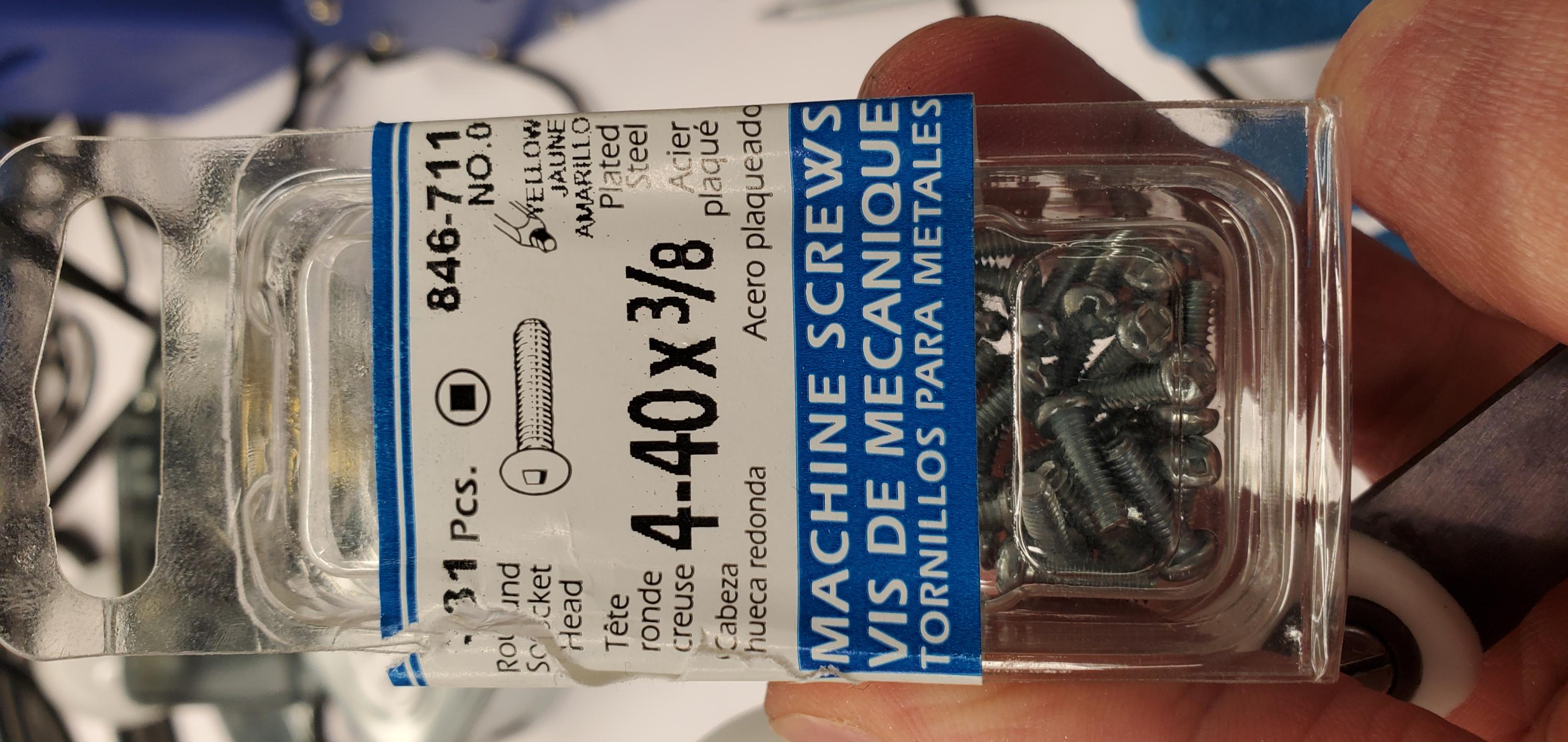

      I think he does, https://www.badcaps.net/forum/attach...4&d=1626717671 but M4 is too big (should be M3 or #4), and the plastic shoulder washers for #6 screws seems rare.

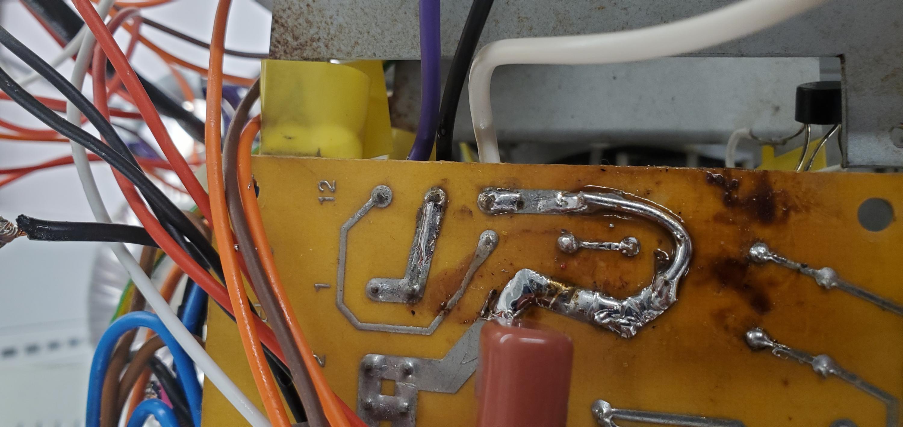

                          what i'd like to see is how the wires connect from the PCB to the TRIAC... the wire colors don't seem to make sense from the limited photos of the wires in the existing pictures, alas it looks like a lot of splices are in place so things may not be as they seem.
                            Re: Fixing a laboratory waterbath
                            This is an old picture but the best one I have. It s the first TRIAC.
                            Blue: GATE
                            Black: MT2
                            Orange: MT1
                            . I wired the subsequent ones similarly.
                              I have installed the new TRIAC. A NTE56010. Same as before.
                              I added 15A fuses on MT1 and MT2 and a 0.1A fuse on GATE. I did not solder the fuses. I did a quick job. The wire is just twisted in the fuse holder's holes. This will be done properly after it's fixed.
                              I replaced the wires from the PCB to the TRIAC so there is no splice or colour changes. It's now easier to follow.

                                        I was rereading all the answers to make sure I hadn't forgotten anything. Just realized you said left pin is GATE, middle is MT2 and right is MT1. Are you sure about this? The datasheet (attached below) seems to indicate the GATE is right, MT2 middle and MT1 left. The diagram in the datasheet is showing the TRIAC from the front correct? If it's actually from the back I ve been wiring it wrong this whole time...Could you check my photos with the wiring above and tell me if it's correct?
                                        It goes
                                        Purple - GATE
                                        Black - MT2
                                        White - MT1
                                        Thank you!
                                          Well you're right it is MT1 MT2 Gate, but sorry, no additional clues why it's frying. You're on your own.
