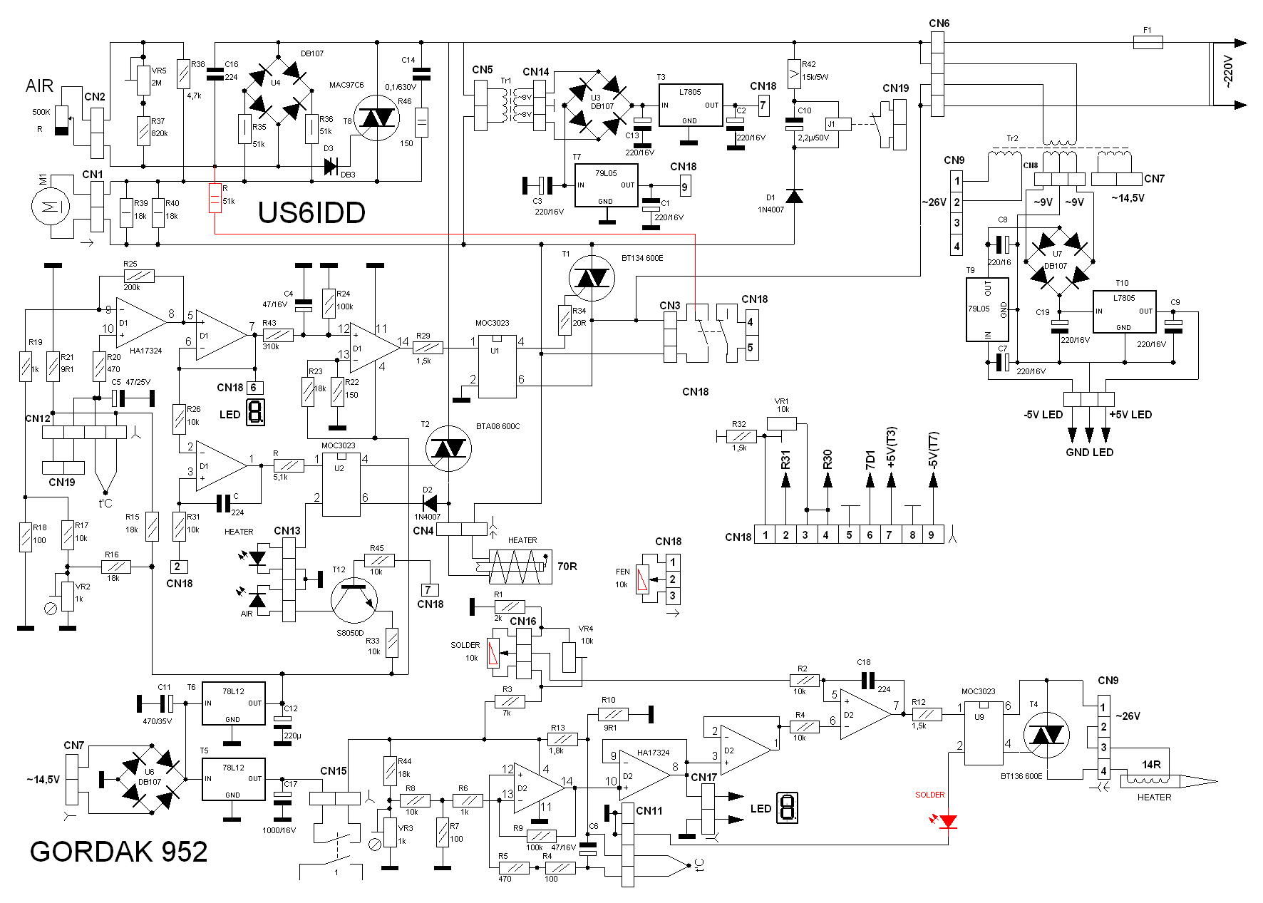

    I have a Gordak 952 soldering rework station that was emitting a burning smell when using it. At first it was quite small but over time it became worse. I decided to open and look and to my surprise 2 large resistors had been overheating and their covering had completely burned off. Because of this, I am unable to see their value. But today a friend of mine had almost the same model Gordak fail and I can see the color bands on his, but when trying to determine the value I am unable to. Can someone tell me the value? Seems these resistors heat up and burn the area of the board around them. The bands look to be black-black-brown-black or gray?

        Re: GORDAK 952 Rework soldering station problems
        Originally posted by SuperAman
        that will help
          • 31293
          Originally posted by peste
          that will help
          that's terrible, do you have a higher res version?
            I have it like this ... I hope it helps ..

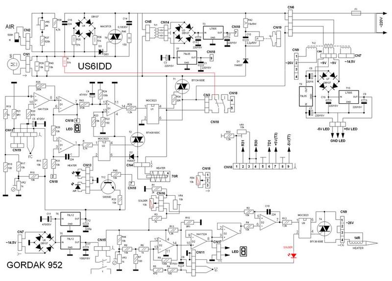

              This is much better!!!
                  From other pictures of the Gordak 952 board, the two resistors are each 300R 3W, in parallel- to make a 150R 6W resistor. I can't find them on the posted schematics. I think they feed the connector with two green wires. Whatever that is, it needs to be fixed, it is drawing too much current.
                  ugh cryllic
                  https://forum.cxem.net/index.php?/to...B8-gordak-952/
                    • 31293
                    is it the 2 18k resistors in parallel with the (mains powered) pump?
                    • redwire
                      • Dec 2010
                      • 3912
                      OP must have had the pump on full blast, for a long time then? It must be, I have seen 15k-18k 3W there. A 18k dissipates 3.2W at 240VAC.
                        • 31293
                        but in parallel to the pump?
                        what function unless it's to provide a non-inductive load for the triac?

                                • 31293
                                o.k. they are across the green wires - so where do they go??
                                btw, desolder the resistors and meter them - they may still be good.
                                and resolder the 3pin thing on the right that shows signs of getting hot.
                                    I've removed and measured the two burned resistors R39 & R40 and they are measuring 18.54 - 18.58K ohms. Says on schematic they should be 18K so I assume they are fine. I suspect it might be one of the 5 big transistors T4 specifically.
