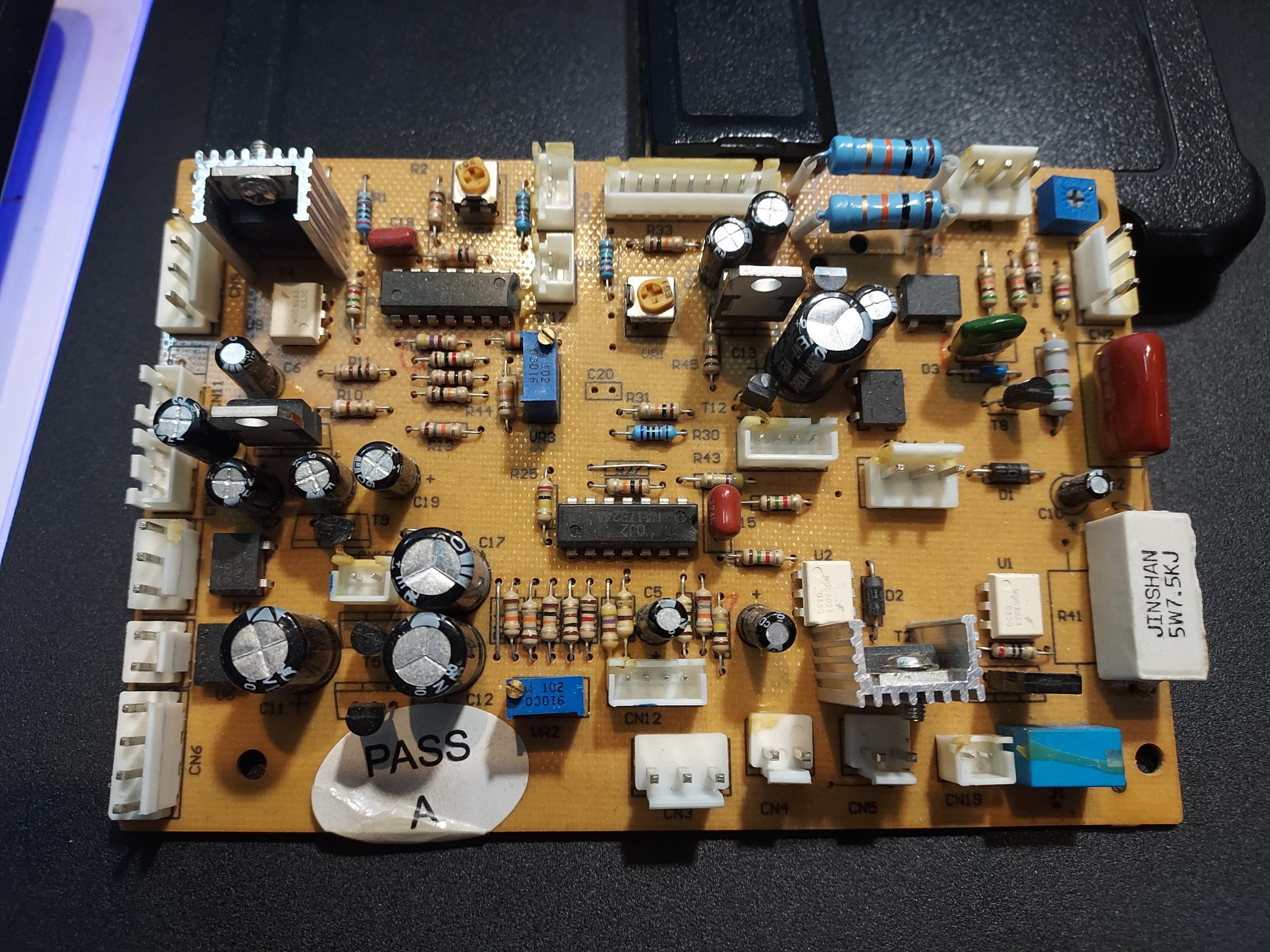

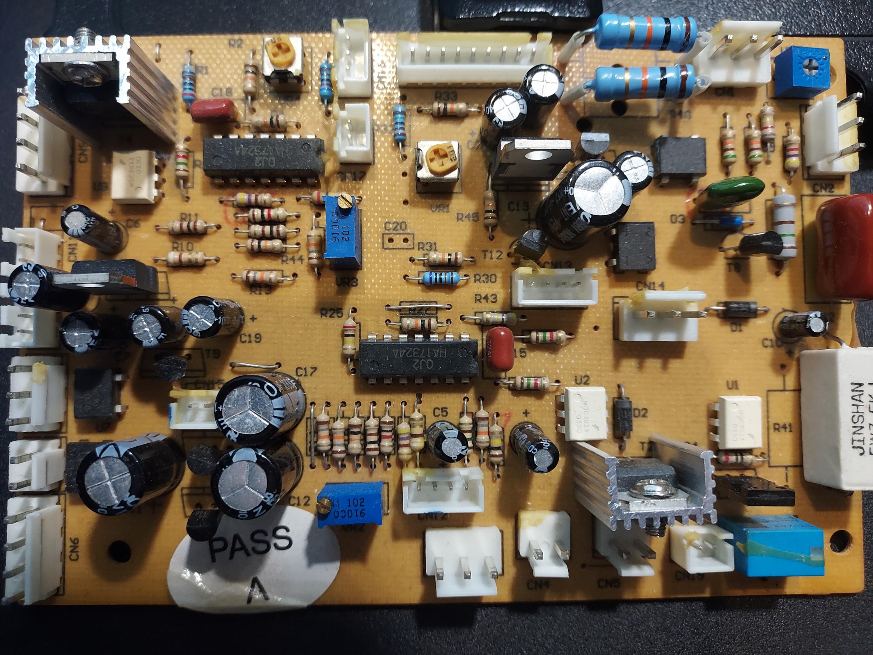

                        Ok Ladies And Gents.. i own an original Gordak 952 i bought new off Ebay.
                        had it about a month and overheated the handle with not enough air and it melted and shorted the triac and a few caps and such on the board... so i had to take the unit apart to repair the board and replace the handle. i seen this post and grabbed the board i haven't installed as of yet (life things happening)
                        So THIS is "THE " Original Board" from a Gordak 952. the schematic on the new is as close as your gonna get... it helped me fix the board i have included 2 photos of my board for reference for anyone needing to identify components
                        Good Luck With Your repairs.
                        Daniel.
