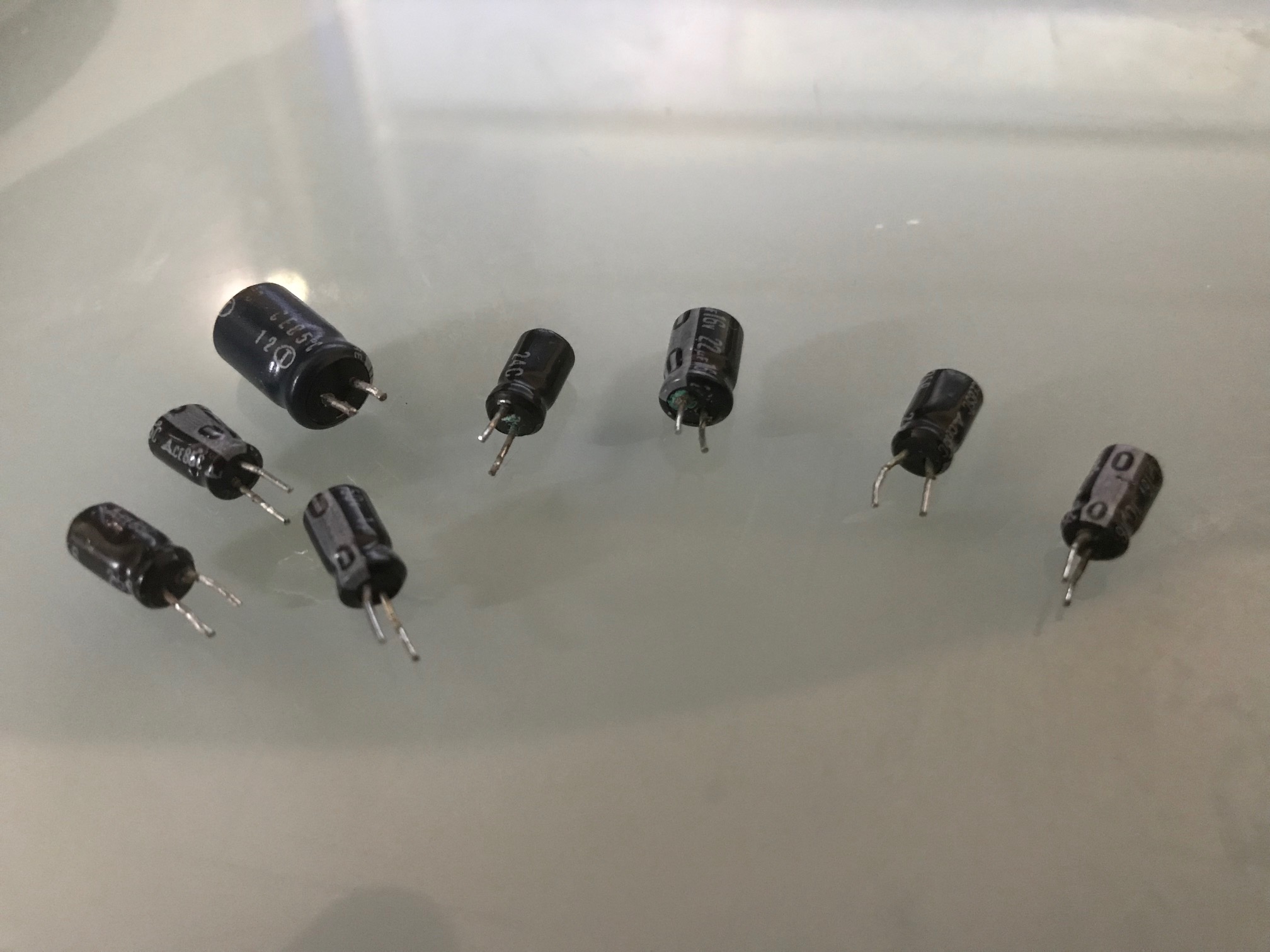

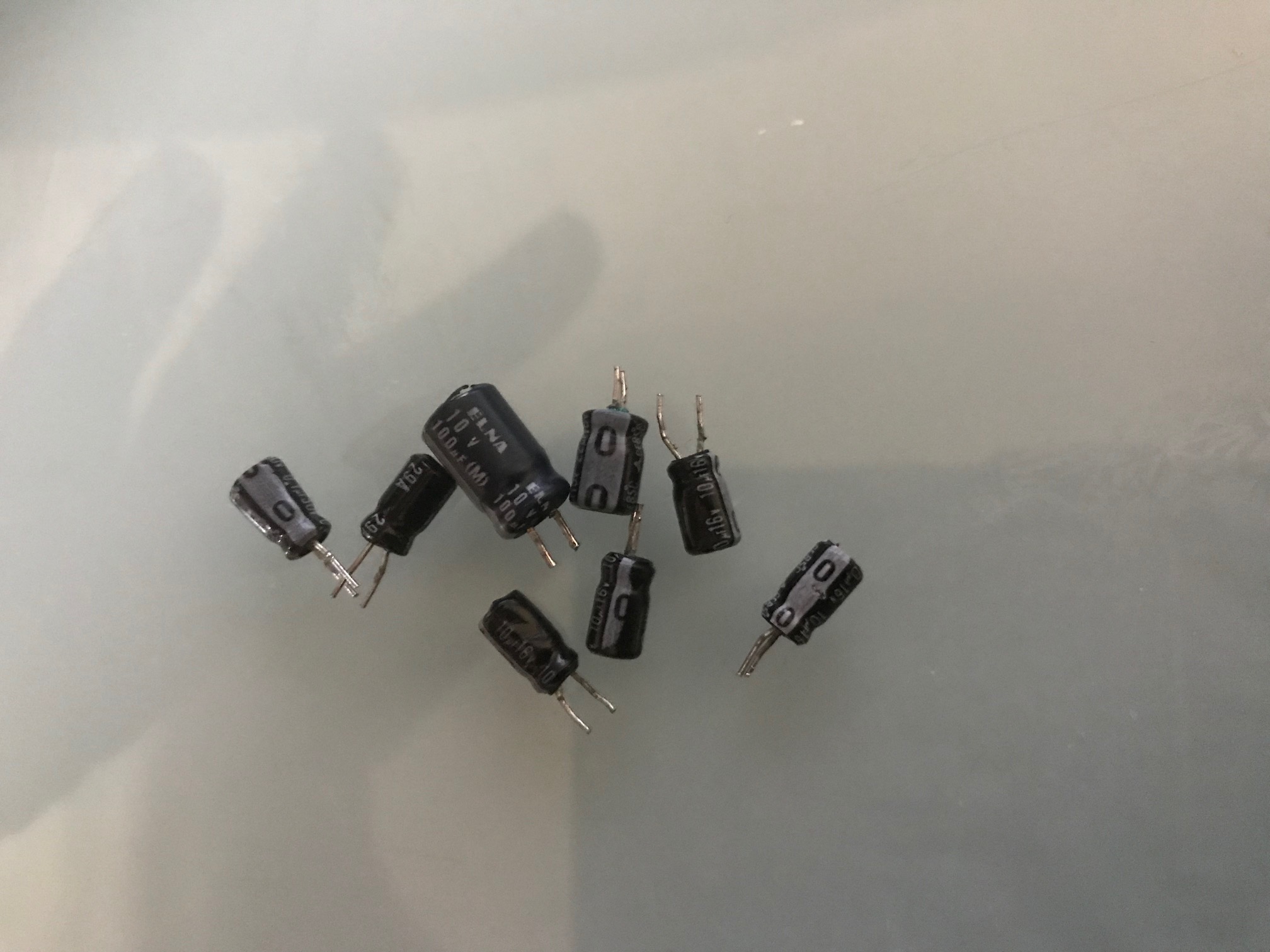

          Re: Yaesu FT726R Transceiver
          So I fished some of the detritus from the bin, other than Elna which I would not know much about other than they still seem to be available, the rest of them appear to be unbranded crud.
          See below, sorry if the pictures don't do justice to the PCB destroying sh&* that had leaked from them. If I remember to, will see to it that some pictures of the rest of the repair in progress are uploaded.
          For your viewing pleasure then oh and excuse the adjustments circularisation of said devices, they were not the easiest of things to grip with needle pliers, and no they were not torn from the PCB.
            elna are good for general use,
            i see the small ones have a mitsubishi logo on them!
